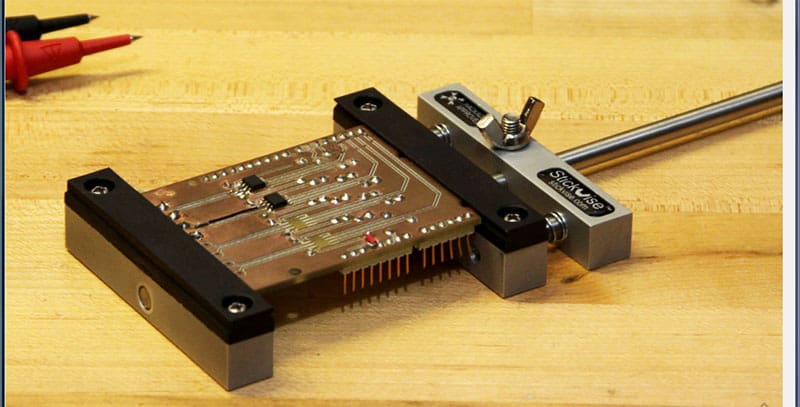

I’m emailing to share a story about a side project I have been working on called Stickvise.  It’s a little machined aluminum vise for holding circuit boards and doing surface mount soldering.  I’m trying to get the word out about it, plus there is a great story behind it that relates to you so I thought it might be a neat topic for a blog post.
I machined all of the prototypes myself using your calculator of course.  The best part is, one of the most unique/clever features of the design is the shaft clamp which was inspired by this article of yours explaining the vise stop you built using split cotter style clamps.

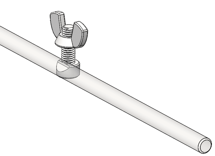

My shaft clamp is not a true split cotter, but a simplified version that is easier to manufacture.  I basically took a socket head cap screw and ground an angled flat under the head.  I draw this flat against the shaft using a wing nut, the flat prevents the head of the cap screw from turning and also clamps the movable vise jaw to the shaft.  There is a spring loaded jaw that holds the PCB in place.  This clamp is nowhere near as strong as a true split cotter but it does the trick for my light duty vise.

Stickvise is for soldering and working on PC Boards…

HalfSplitCotter
Here’s the half-a-split-collet he mentions…
The neat thing about split collets, if you’ve never played with one, is they clamp a lot harder for a given amount of force than the usual rod clamp that is just a split with a set screw.  Stickvise can also take custom jaws.  I don’t know why, but there’s a part of me that sees a Selfie-Stick for after hours use of Stickvise with the right jaws, LOL.
