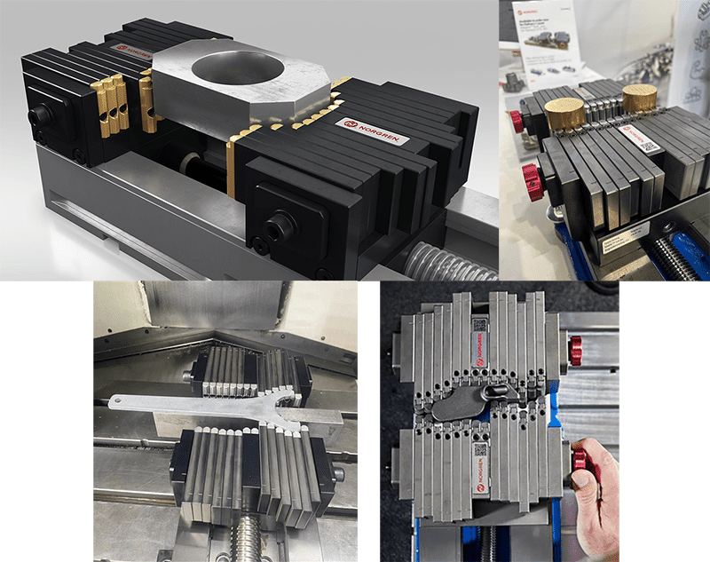

The other day I came across one of my new favorite workholding solutions. They’re called “Adaptix™ Soft Jaws“, and they’re made by an outfit called Norgen Workholding in Saline, Michigan.

But what if someone made Universal Soft Jaws? What if one set of soft jaws could fit virtually any part? You wouldn’t need to machine them for each part. You wouldn’t need to store a bunch of different soft jaws for future orders. In fact, you’d just leave them on your vise so they’re ready to go the next time you use the vise on a new job.
Is such a thing possible?
You bet! That’s exactly what the Adaptix soft jaws are.

Installation of the Adaptix system is easy–they will drop onto your Kurt 6″ vise. They also make a version for Schunk vises.
Once installed, you can tram them from the side plates as shown in the demo video. You will then want to take a skim cut to establish uniform Z-height across all the fingers. That’s it. You’re now ready to use your Adaptix Soft Jaws.

Here’s a gallery of different parts being gripped in Adaptix Soft jaws so you can get an idea of their potential:
I really like what Norgren has come up with here. It has the potential to be a real time saver, especially for shops that need Soft Jaws for one-offs and prototypes. It’s one thing to amortize the cost of a set of soft jaws over 100 or more parts, but doing so for just 1 part is harder to justify.
Like so many excellent products, the Adaptix jaws are not cheap. They run $5995 as I write this. They claim the ROI will pay for themselves within 6 months. It’s going to be a function of how many soft jaws you’re having to make over the course of a year for your jobs. I don’t doubt a shop with decent volume will pay for them pretty quickly.
