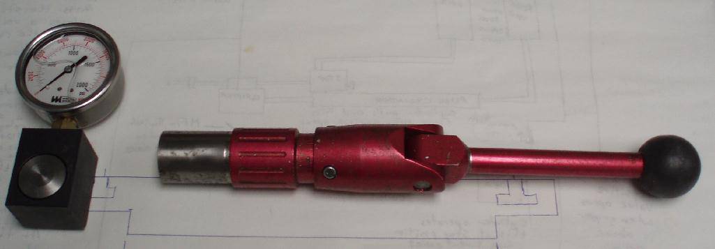

There are also more specialized tools being made for this purpose, if you’re a gadget hound like me. In another thread (that has some great guidelines for precision boring on a mill), Geof talks about a tool he found called THE REPEATER:
The Repeater consists of a force gage (nice hydraulic force cell to have for other purposes too) and a vise handle with a torque limiting slip clutch. Set it to your desired clamping force and then when you reach that point the vise handle wilil just spin. That’s idiot-proof enough even for me!
The Repeater (as well as some other nifty tooling) is available from Proclamp Products.
