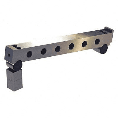

The angle of a Sine Bar or Sine Plate is established using precision spacers under the rolls.  The rolls are the sine block two cylinders at either end.  They serve as pivots, and they're cylindrical so there's a line of contact between the surface it rests on and the Sine Bar or Sine Plate.  They should be of equal diameter.  The precision spacers used with sine bars are usually gauge blocks.

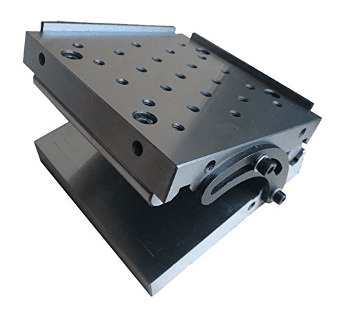

For comparison, here is a Sine Plate:
Metal worktable with tool clamps.
Sine Plate.  About $207 on Amazon...
The Sine Bar is all about setting up an exact angle, while the Sine Plate is all about supporting a part or perhaps a piece of fixture at that angle.  A sine plate is also precision ground and uses the two cylinders.  Sine plates are much wider than sine bars.  A sine plate may also be called a sine table.

Here's an example of Sine Bar usage where it is sitting on a slip gauge block stack:
Metal fixture with four equally spaced round holes on top, mounted to a square base with two small cylindrical parts.
Think of Sine Bars as converting a height to an angle, because that's essentially what they do.  We will typically use a Gauge Block stack to establish the height and thus the angle.

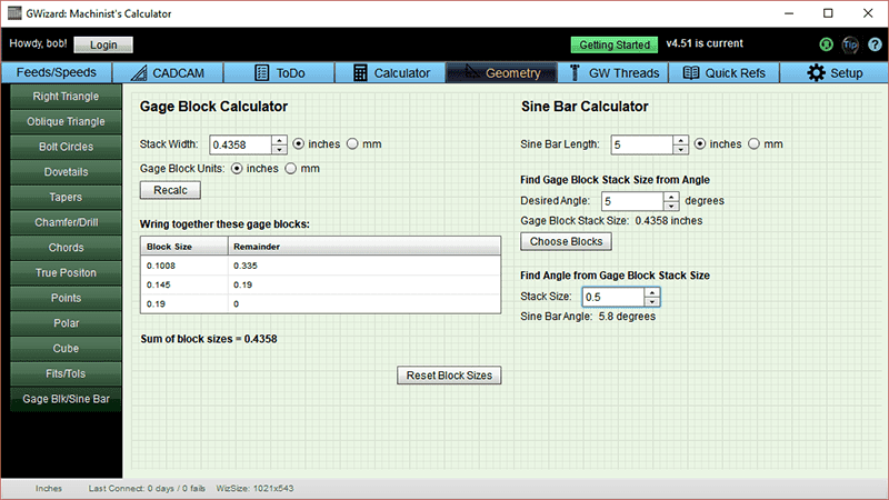

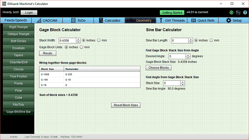

With this Calculator, you don't need to remember formulas or track down  your calculator.  Instead you use a purpose-made piece of software that makes either finding the correct stack height for a given angle or figuring out what the angle is from a stack height easy.  In addition, it knows all about gauge blocks and will find the minimum number of standard sizes to make up any given height.
Our G-Wizard Calculator software had a built-in Sine Bar Calculator that looked like this:
Gage Block Calculator interface with two sections and input fields.
Note how the Calculator is split into two components:
The two work together, but let's focus on how to use them.
To calculate gauge block height for a particular angle:
  1. Enter your sine bar length (aka "Center Distance").  Common sizes in the US are 5 and 10 inches long.
  2. Enter the desired angle.  For example, the screen shot shows 5 degrees.
  3. The size for the Gage Block Stack will be shown.  The screen shot shows 0.4358.
  4. Click the "Choose Blocks" button to see which blocks to stack to make that height.  Here's the result after we clicked the button:
Machining calculator tool with grid layout and input fields
You can see G-Wizard recommended 3 blocks for this angle.

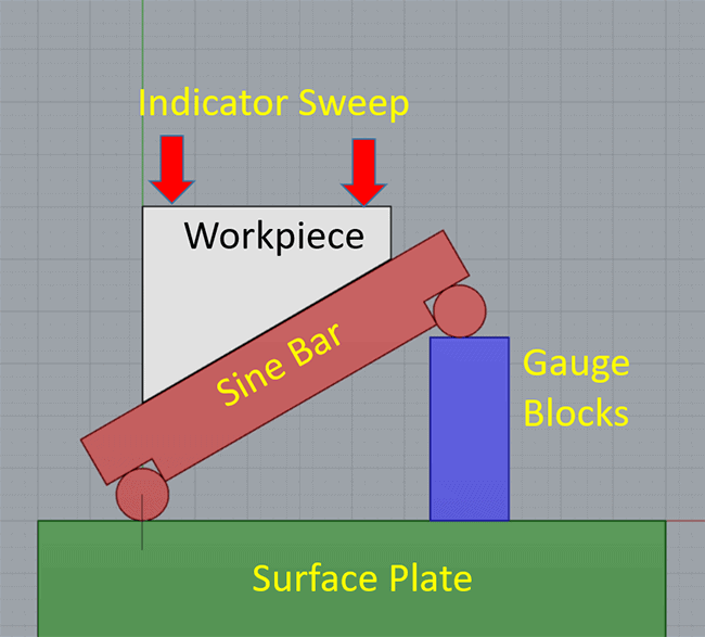

There are a lot of ways to use a Sine Bar to measure an angle with great precision.  For example, you could create a setup like this:
Surface plate with sine bar, indicator sweep, workpiece, gauge blocks and plate.
How to measure angles using sine bars and gauge blocks on a surface plate.
Adjust the height of the Gauge Blocks until you can sweep an indicator across the top of the workpiece and the needle is steady, proving the surface is level.  Once you have that condition, you can use the Sine Bar Formula to determine the exact angle of the workpiece.  The surface plate ensures the overall accuracy of the setup.

Once you have the Stack Size measured, use the Sine Bar Formula to determine the angle. Here's how G-Wizard Calculator showed it:
GWizard Machinist's Calculator tool screenshot with calculators for machining tasks.
As the screen shot shows, a stack size of 0.500" means the angle is 5.8 degrees.
