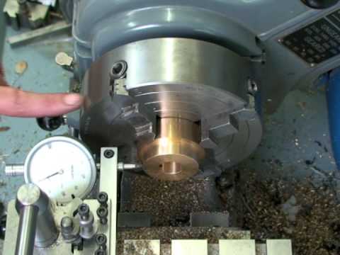

I got a nice letter from Aaron Gough, who had just watched a video he found on CNCCookbook’s Lathe Workholding Page by David Lemeris:

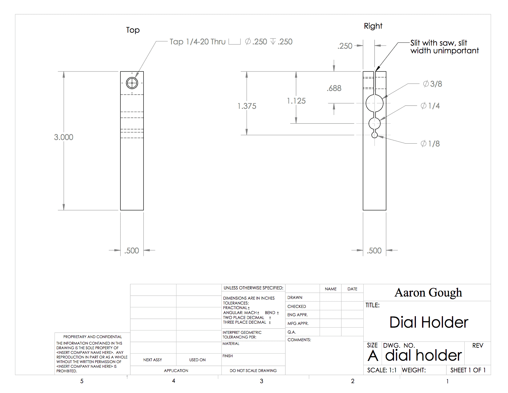

David’s method is the one I use and it is super fast and easy. If you were afraid of the 4-jaw, there’s no need to be, they’re easy to set up and extremely accurate once you know how. One of the things Aaron noticed in the video was the very nice indicator holder that goes right into the QCTP (Quick Change Tool Post) on the lathe–very convenient. So, he wanted to pass along his very nicely executed version as well as a drawing on his own blog:
Click the image for the full-sized drawing…
Thanks Aaron, for contributing to the cause!

By the way, it’s not just the dedicated indicator holder that makes this quick, but especially the extra miniature chuck key which allows you to align using both hands at the same time, nudging the workpiece back and forth. Without the extra key it would take much longer to align.
David
