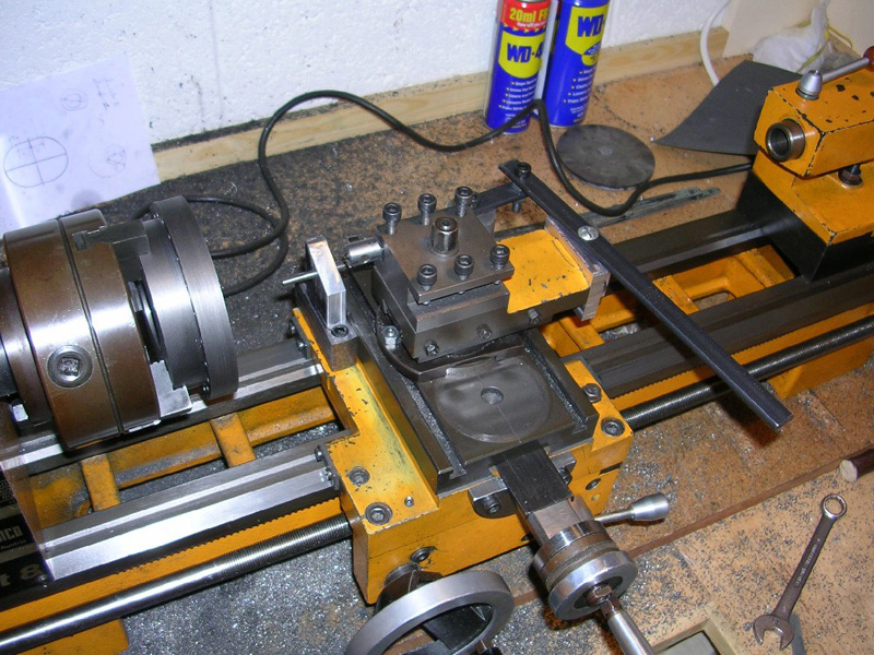

I liked this little video (other than leaving the key in the chuck, don't do that!):
He just uses a ball bearing mounted on the QCTP to gently "nudge" parts into proper alignment
You'll want to be very careful with this technique-don't fire up the spindle to a very high rpm, for example. But, it looks like a real time saver if properly done.
There are a couple of great tips here. Aside from aligning the part in the chuck with the ball bearing, the use of circular pieces instead of a dovetail on the QCTP is also quite interesting. It also looks like he keeps that indicator on a permanent holder on the lathe's backsplash where it is handy to get to.

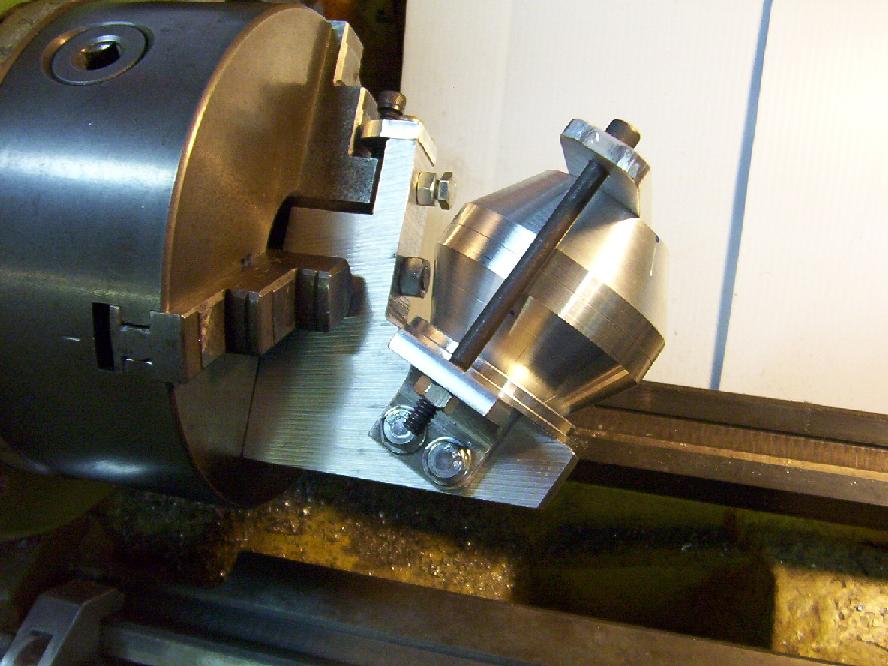

Dodecahedron
Precision metalworking tool set with threaded knob and various-sized holes.
Metal tool with grooved metal surface, possibly used in manufacturing process.
Metal milling machine fixture on a workshop table with debris.
These aren't really useful for anything I can think of, but they sure are cool!

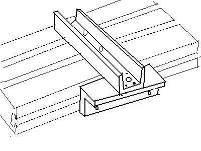

One fella mentions this is a handy way to quickly square things on his mill table:
Black-and-white illustration of an L-shaped bracket with a central hole.
A Mill Table T-Square...
He said he made it up and machined the edges of the T-Square so that they would be true to the table. Seems like a pretty slick idea to get a vise or other item lined up quick. He did say if he had it to do over again he'd use a piece of 1" square bar.

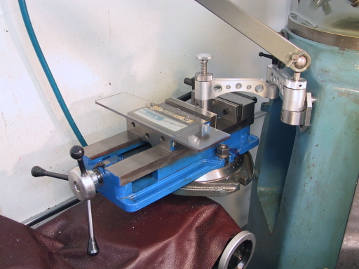

Mill Vise Caddy
A blue benchtop vise with swing arm against a white wall, featuring a black handle and adjustable metal jaw.
Mill vise swing arm with silver arm and blue handle attached to machinery.
Here is a nifty accessory to save humping that heavy vise on and off the mill table.
It's so nicely made, isn't it? You clamp the vice jaws onto the thing and you can lift the vise off and swing it out of the way. It almost seems to me like something slightly more general would let you keep a bunch of vises, rotary tables, and other goodies on a shelf behind the mill and bring them on and off as needed.
You can buy one already made from SPI (via MSC or other dealer) which calls the product a "Mill Vise Caddy." Cost, $339.
The magnetic chip shield is also handy, and could be easily made.

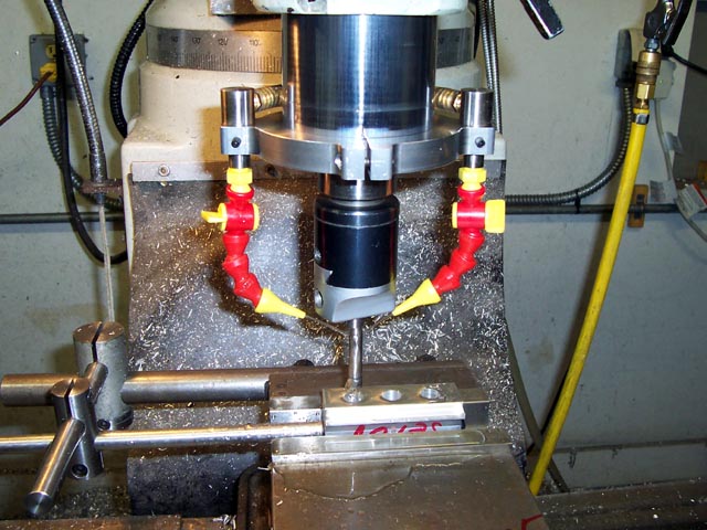

Spindle

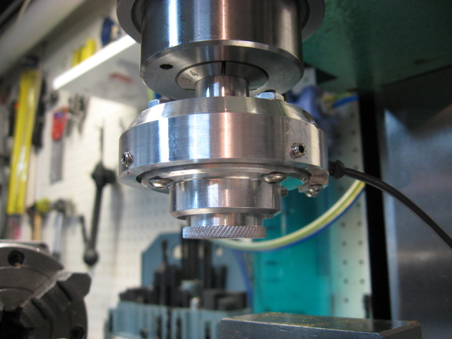

Coolant Collar
Metalworking machine in workshop setting with cylindrical component and red/yellow hose.
The Widgitmaster's Coolant Collar...
A spindle coolant collar is a very handy thing indeed. Firstly, it provides a convenient way for the coolant nozzles to track the activity of the mill in a more elegant and permanent way than the magnetic versions that are available. This ensures that once the nozzles are lined up properly, they'll do the right thing wherever the spindle wanders. Second, there are numerous reports that the darned things can also help cool down your spindle bearings, which seems like a darned thoughtful thing to be doing as well to me.
I have started an Idea Notebook with pictures of a number of different coolant systems along these lines.

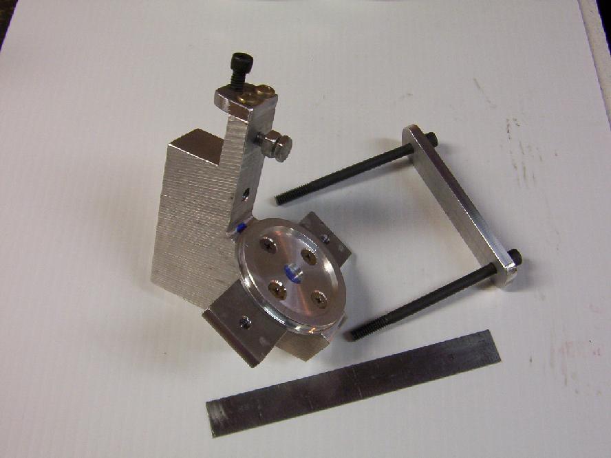

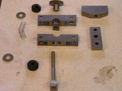

Needs no Dovetail Cutter
If you don't have a dovetail cutter for making QCTP holders (I made one, it isn't hard!), you might consider this fellow's approach of just doing it by milling the dovetails as separate parts:
A milling or lathe machine with a dovetail cut setup.
Using a Tilting Vise Fixture to Mill the Dovetails...Metal parts on machine tool bed with slotted grooves.
The Components. Note How the Dovetails  Are Bolted to the Holder...

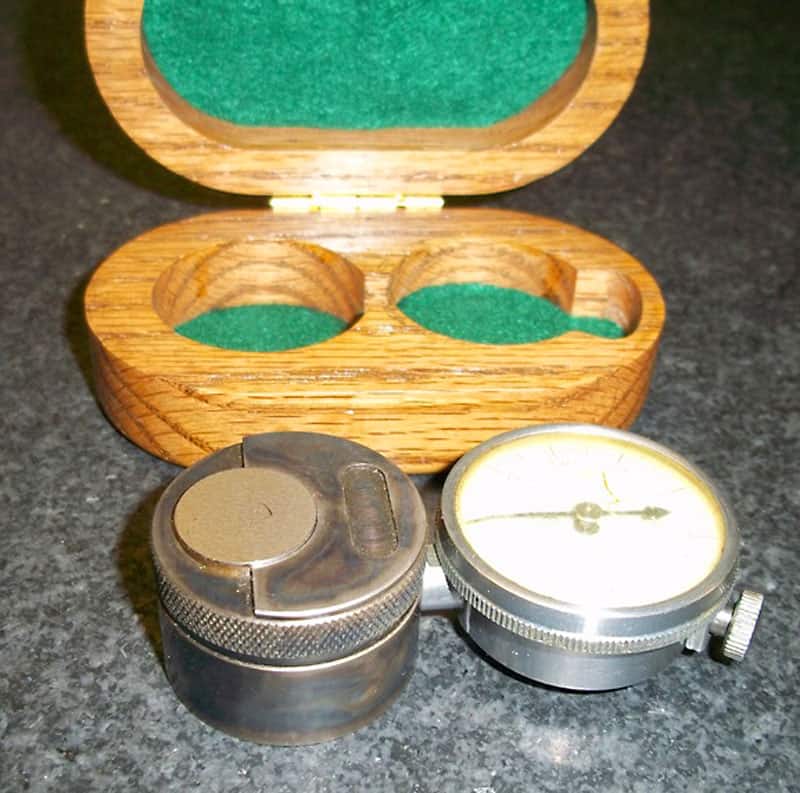

"Flapper" For Irregular Shapes
Marv Klotz gave us the "Flapper" design for dialing in irregular shapes or square stock in the 4-jaw:
Antique-style flapper gauge, a precision measuring instrument.
This one just uses a magnet to
attach itself...

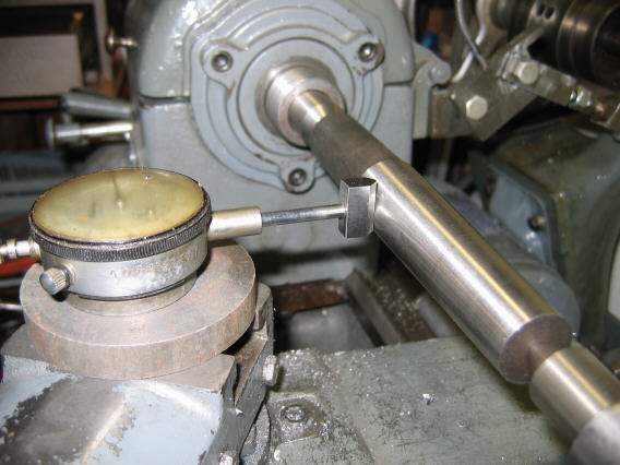

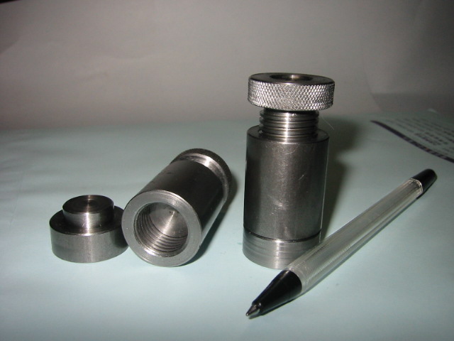

JTiers Approach to Irregular Shapes
Small metal component with threaded end and square base.
A close-up of a dial indicator on a lathe in a machine shop.

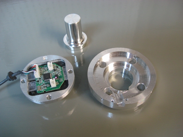

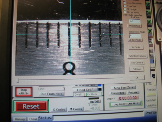

S_J_H built this gorgeous housing for a $30 Logitech web cam and posted it on HSM:A silver drill press spindle on a blue stand against a white pegboard background with tools and accessories.
CNC software screenshot with 3D model and toolbars.
The finished camera inserted in an R8 collet on the mill, and Mach 3 can display the feed from the camera...
Silver cylindrical metal component with threaded opening sitting on gray surface.
Looks like the camera sub-housing has centering
screws...
Two metallic components with a green circuit board.
Here are the parts...

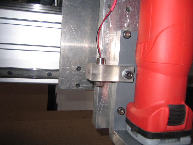

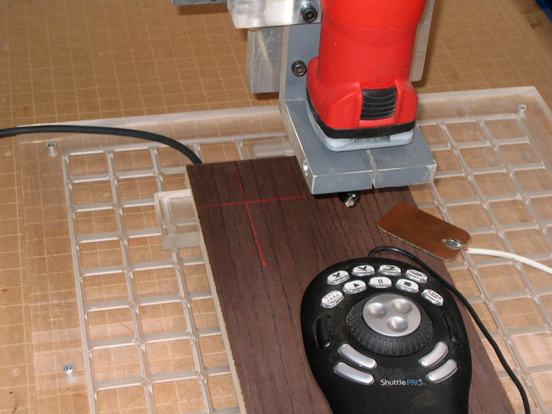

Here is an inexpensive laser cross hairs mounted on a CNC router courtesy of CNCZone and Aussie member Greolt:
Red cylindrical object attached to aluminum bracket with screws.
Red router cutting wood cross on laser mount.
These little cross hairs are available from DealExtreme for $4.30. So cheap!!!
To use with CNC, Greolt
programmed in a button on Mach 3 that compensates for the offset
from the spindle automatically...
But wait, this gets more clever. He added some code to Mach 3 that deals with the fact the laser cross hairs are offset from the spindle.
Here are the controls:
Laser Controls Mach 3 interface screenshot with button grid featuring JOB SETUP, Offsets, MDI, G & M CODES.
The target toggles the laser on and off. "Laser Zero" zeros the machine at the lasers current position allowing for its offset
from the spindle! The X and Y DRO's let you enter the offset of the laser from spindle center.
Here is what the Mach 3 code looks like to do that:
Xmove = GetUserDRO(1152) ‘X distance DRO
Ymove = GetUserDRO(1153) ‘Y distance DRO
Code "G91 G0 X" &Xmove & "Y" &Ymove
While IsMoving ()
Wend
Code "G90 M9"
DoOEMButton (1008)
DoOEMButton (1009)
The M9 is to turn laser off after the zero. M7 turns it on. He's just using the mist coolant commands to run the laser. The two "DoOEMButton" zero the X and Y. The two DROs are to set the laser offset distance for the script.

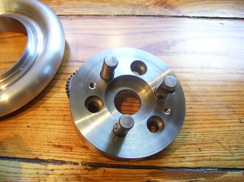

Chuck Adapter for Rotary
Table
Metal threaded cylindrical pieces.
The Faux Cam Locks...

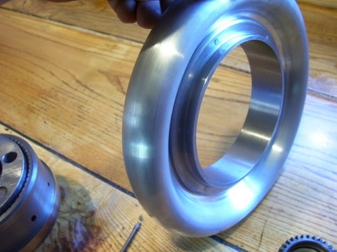

This should be a simple project. I basically need to take a circular plate and drill two sets of holes on bolt circles. The first circle will be identical to the bolt circle used by my lathe to mount the chuck backplate to the spindle. To be precise, I want the circle that holds the little faux cam lok's into the back plate:
Metal components including 4-jaw chuck adapter plate on wooden surface.
Backside of adapter, showing bolts through to chuck...
The second bolt circle will consist of 4 holes that are outside the diameter of the chucks. I will use these to bolt the assembly down using the T-Slot system on the rotab. Here is a similar such project done by another machinist:
