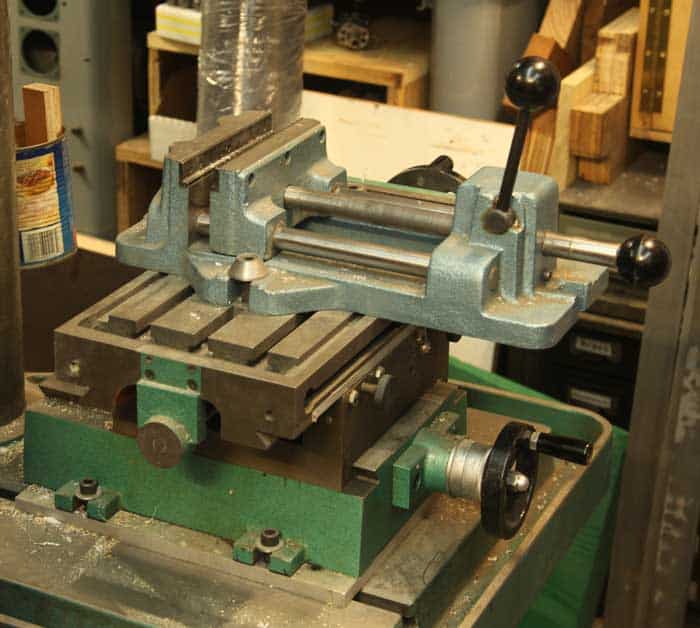

Drill Press Milling Table (XY Table for Drill Press)
The consensus seems to be you can line up on a marked point much faster with an XY table, and you can certainly drill a line of holes more easily too.
Green and gray metalworking vise with vice jaw attached to a metal machine.
Frank Ford's table is from Grizzly. Nicest table I've seen yet that you could buy new. 133lbs! Love the quick release vise too.
Phase II makes some decent ones as well, and Enco has them on sale from time to time.

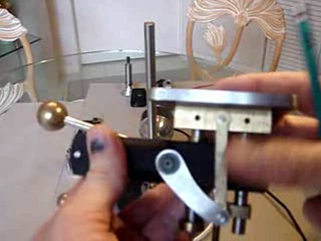

Sensitive Drill Press

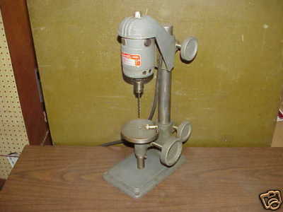

This is not souping up a drill press per se, but I've always wanted a little sensitive drill press like the ones made by Dumore and others. They're set up to turn at the very high rpms required by tiny drill bits and would be ideal for very small holes such as those involved when making model engines. It's very hard to drill these little tiny holes in a conventional drill press at slower spindle speeds.
A Dumore Sens Press drill press in a workshop or showroom setting.
Dumore sensitive drill press. Note that the table rises...
Gray metal electro-sensing press in workshop with tools and attachments.
A sensitive drill press...
Sensitive drill table attachment for metal fabrication or machining.
A couple of shots of a little sensitive drill table made by Mcgyver. It has a counterweight to maintain steady pressure...

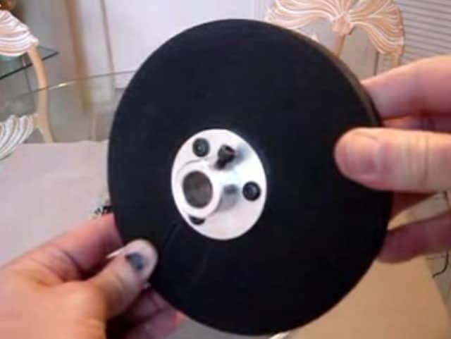

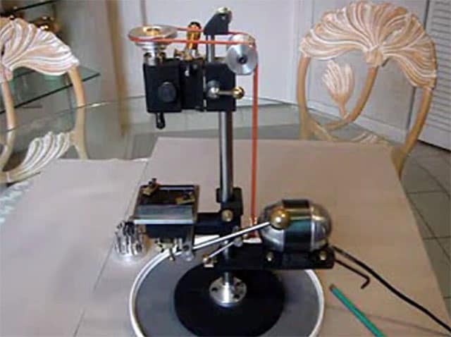

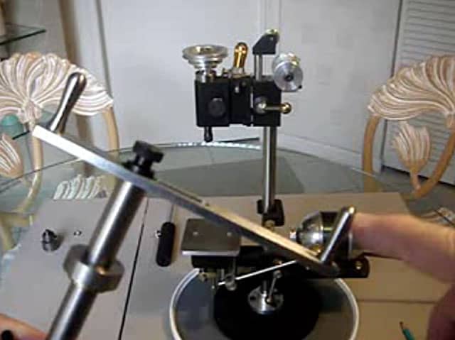

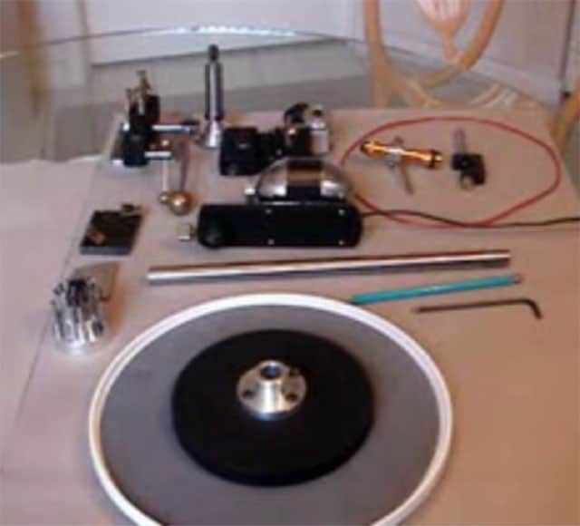

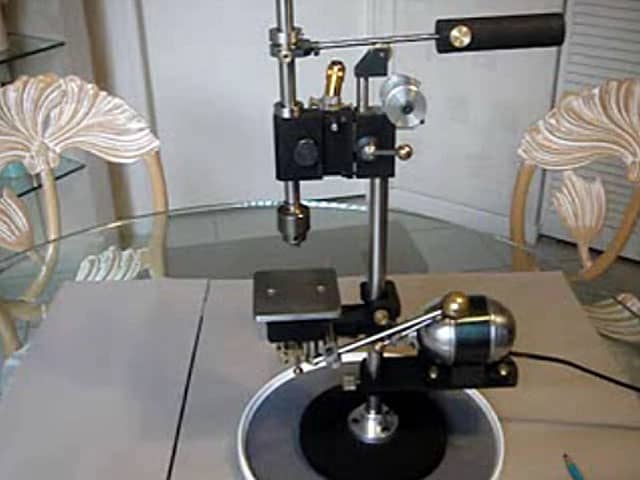

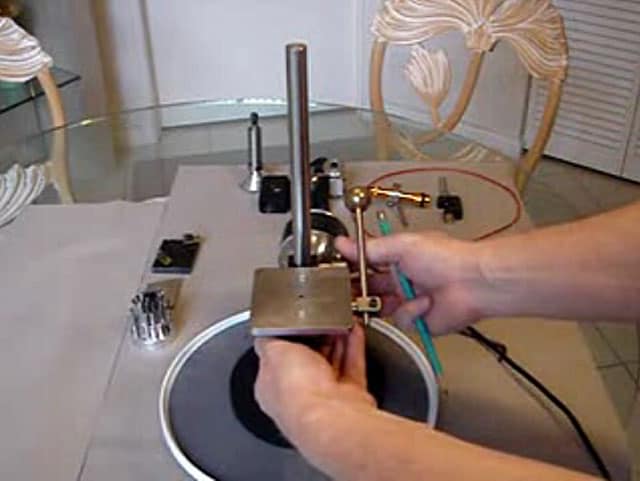

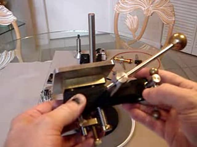

Here are still from a wonderful series of YouTube videos on a universal pillar tool type of micro-drill press:
Metal fabrication tools and machinery parts on a table.
The base is cast iron from a barbell set...
Micrometer held by a hand in front of metal fabrication equipment.
The motor is from a milk shake mixer. The motor end caps are chain link fence post caps.
Metal device on table with objects surrounding it.
Sensitive drilling table. The spine is 1" key stock. You can see the table moves on 2 machined columns, one of which is springloaded for return. There is a setscrew on the lefthand column for height adjustment, and a stop in the middle for lower travel.
Hand grasping metal precision tool with ball-ended rod.
The other side of the table reveals the raising mechanism. No stop for depth? Also, a collet fixture in the middle would be handy...
A hand holds a stylus near a turntable on a table, with a metal rod supporting the device.

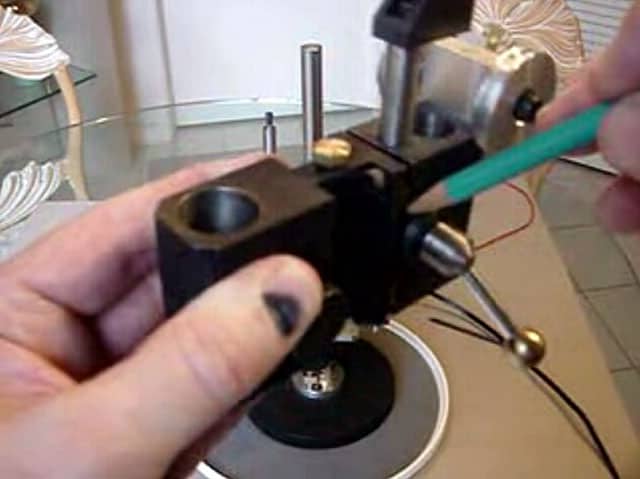

Indicator holder for precision depth. Spindle head.
A person's hand holds a black metal object with a hole and green wire on a silver turntable with a blurred background.
Pencil shows where tramming shims go.
A person's hand holds a metal object with a round end featuring a small hole in the center, against a white background.

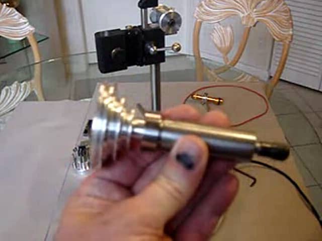

Spindle. Body turned from drill rod. One bearing in either end. Top bearing is larger. Spindle itself is 12L14, threaded to accept Dremel collets. Collets are turned on the lathe in the spindle to minimize runout.
A hand holds a shiny gold tool with a red wire attached to it, set against a metalworking machine background.
Gimballed light and figer plate for work clamping...
A vintage record player with a metal tonearm and headshell, surrounded by mechanical parts on a table.

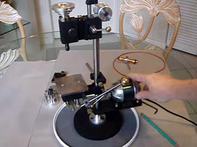

Ready to go!
Turntable with glass top and wooden handles.
Sensitive tapping attachment with counterweight and adjustable handle...
