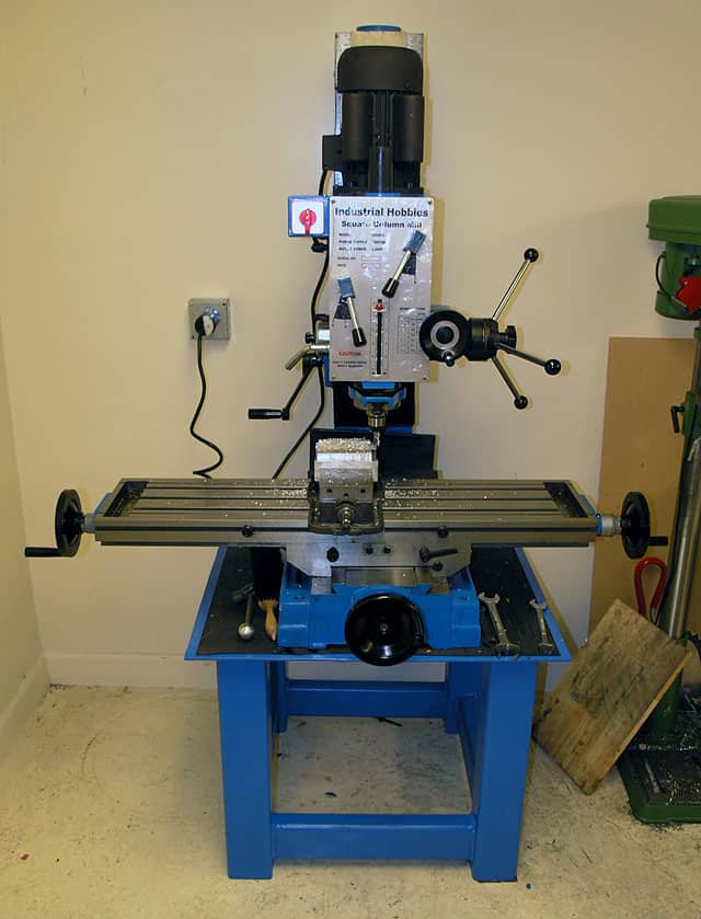

My IH Mill on the stand I built for it, right after cutting first chips...
Given my well known feelings about refurbishing American tools versus buying new Asian, it should come as no suprise that I have purchased an Asian mill. The choice of which mill bears talking about. There were two broad categories that I considered, and two that I rejected out of hand. I rejected the round column "mill/drills". I felt the latter involved too many compromises and that I would outgrow one way too quickly. They are not as rigid, and you can't raise and lower on that round column without knocking your precision out the window, which really limits their CNC possibilities. I also discarded the really small mills like the Taig or the X3 sold by my friends at Lathemaster because I wanted something with more capacity.
The two categories I considered were full featured square column mills (which is what I wound up with) and the knee mills, which are Bridgeport clones. The latter were very tempting, but I was ultimately concerned about how well one would fit into my shop. My ceiling is only 82 inches high, and everything going into the shop has to fit through a door that is only about 2/3's standard height, goes down an 18" step, and then makes a sharp right turn. Manuevering 1600 to 2000 pounds of Bridgeport clone through that knothole seemed too difficult. Among the square column mills, I like the bigger version sold by Lathemaster as well as a similar one offered by Penn Tools. The last thing that swayed me to take action was that Industrial Hobbies put on a fantastic sale on the mill with a major price break as well as free shipping.
The mill showed up at the local freight terminal almost the day after I had ordered it, which surprised me. I had a mad scramble to find someone who could help transport a 1000lb crate to my house and offload it inside. There it sat for several months until I was able to build a decent stand for the 900lb mill before moving it into the workshop and firing it up. Thank you Cabrillo College welding program for introducing me to the essential skill of welding, and thank you eBay for offering up a cherry Miller Tig welder for about half what a new machine would've cost!

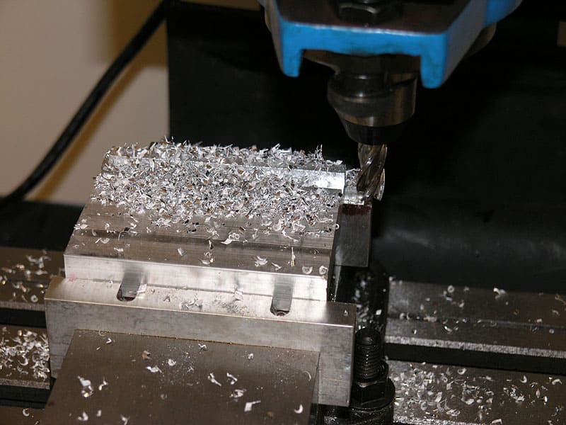

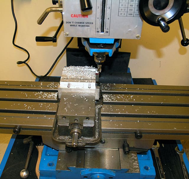

They say you never forget the first time (no, I don't mean THAT first time!), so I thought I'd capture the moment. After powering up the mill for the first time, I trammed the head with my Indicol indicator holder, a 0.001" Mitutoyo dial test indicator, and a 1-2-3 block. I wasn't too particular, settling for being with 2 or 3 thousandths, as I was eager to try the mill out. Next I clamped my Kurt 4" milling vise (got a 6" too, but the 4" is cute and much lighter!) to the table. To get the vise square I again took a shortcut. Somewhere I read about the nifty trick of putting an endmill against the back of the vise jaw, finger tightening the vise clamp at that end, and then cranking the table to let the mill "push" the vise into square. It worked pretty good! Finally time for the moment of truth.
I selected a 1/2" Niagara 4-flute endmill, and a piece of 1/2" thick 6061 aluminum I had laying around. Spindle speed was set to 400 rpm. I didn't bother to check whether that was an appropriate speed or not, especially since this machine is all manual feeds so I've no idea of the feed rate! I locked all of the gibs except for the X-axis for maximum rigidity.
I stuck the aluminum in the vise, touched off the mill, and started experimenting with depth of cut. Compared to my Lathemaster lathe, cutting with this mill is amazingly smooth and quiet, which I took as a good sign! It shrugs off tiny depths of cut with ease. I got up to 0.010" in the aluminum before it started to even be a little less smooth. It certainly wasn't chattering, but the surface finish had deteriorated. I think part of that was also due to the fact that I just let the chips pile up, so it was cutting the same chips again too. Lastly, they say cutting a slot will not have as good a finish if the slot is exactly the width of the endmill. In any event, here are a few photos of the results:

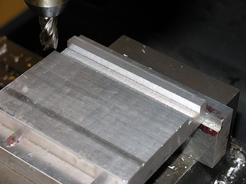

Sans chips you can see the finish is a bit rough...

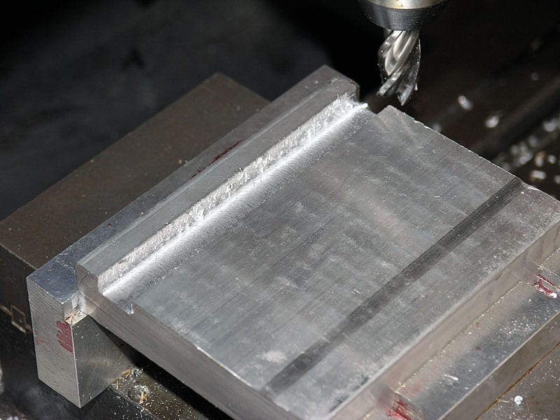

I was curious to see how much better the finish could be with this end mill, so I cranked the Y-axis slightly so I would be cutting just the far wall and making a slightly wider slot. Given where the wall was and the direction I was going, this was conventional not climb milling, so the finish is supposedly better if I had gone the other direction and climb milled. Here is the result, with a much nicer surface finish:
A close-up view of machined aluminum with flat surface and parallel grooves.
Shallow cut on wall to yield a better surface finish...
The shallower cut, being clean of chips, and just cutting the one wall really cleaned up the slot tremendously. Overall, I am very pleased with this mill and looking forward to "getting to know it" for a few months before I start converting it over to CNC operation.

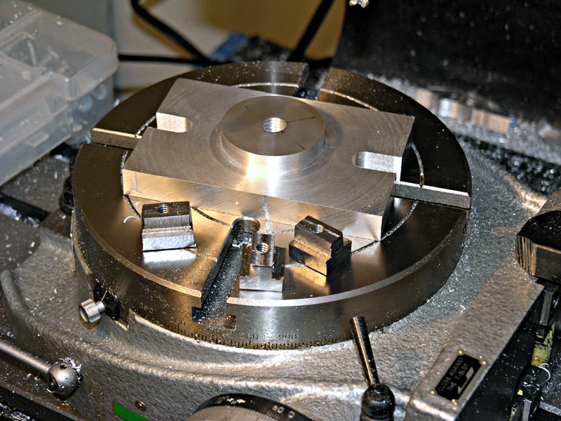

Rotary Table Accessories and Tips
The rotary table need not be exclusively devoted to the mill, but in general practice, they usually are. Visit my page on rotary tables to learn more about these intriguing devices.
