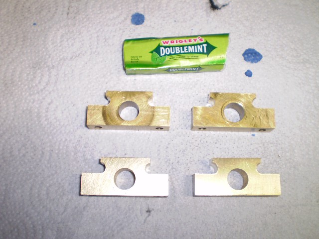

Before I could get started, however, I had to make some accessories for it. Basically, I needed some T-Nuts to fit the table, as well as a little fixture that makes it easy to hold a plate up off the table through a hole in the center so you can machine it. The latter, what I call a "plate machining fixture", was inspired by something similar I saw the Widgitmaster of CNCZone fame using to make Dremel clamps for his mini-router:

Creating the Plate Machining Fixture and 3 DIY T-Nuts is a breeze. To do so, simply shape a block to the right size, mill the side spaces, drill, and tap. These are much tinier than the T-slots that are standard for the Bridgeport mill, which led me to fabricate them myself using 1/4-20 bolts. They are crafted from mild steel.

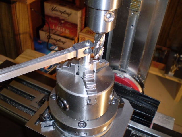

The rotary table with a chuck mounted is a good place as any to set up a rounding fixture. This idea from HMEM contributor Philjoe5.
Avoid Rotab Overrun When Rounding With End Holes
When you're rounding partially by cranking a part around on the rotary table, it's really easy to go a little too far and screw things up. The answer is to drill the end points to make the exact stopping point on the rotab a lot less sensitive:

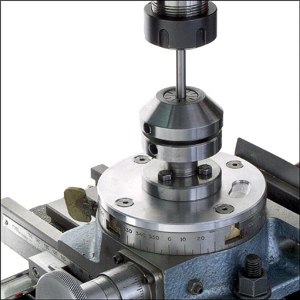

Use a Collet Fixture on the Rotab to Center Under the Spindle
Centering with a Blake indicator is really fast, but what if you don't have a Blake, or worse, what if your mill is too small to accomodate one? Here is a nice solution I found on a German site. This fellow has made an ER collect fixture for his rotary table, and has taken care that when installed on the table, the axis of the collet is aligned with the table's axis. He can then place a dowel or other straight pin in the collet and line up until it will go into a similarly sized collet on the spindle. Nice trick! It's similar to how Widgitmaster showed me to align a drill chuck on a QCTP to the lathe centerline with a dowel pin held in the lathe chuck.
Precision tool with rotating head and adjustable alignment.
Metalwork machine drilling operation in progress on red metal piece.

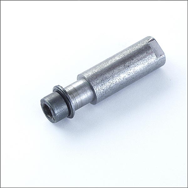

Here is the collet chuck in use. You don't just use them for round stock!
Silver metal cylindrical component with hollow interior and rounded ends.
Here is the little clamping arbor used to hold the plate in the collet chuck...
