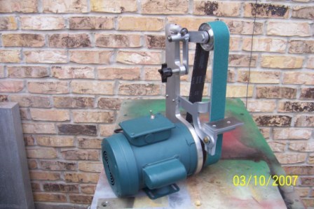

Bill Pace grinder has been made by several on the HSM boards.
Shows tracking mechanism at the top very well…

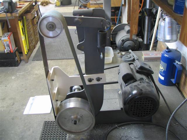

Lane over on HSM built one along the same design…

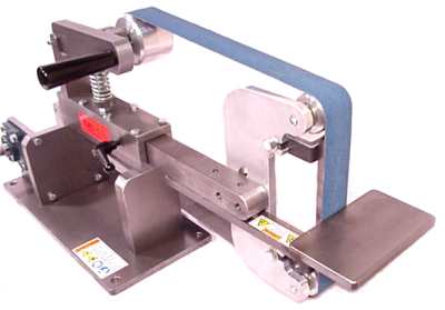

Andrew McLurkin’s Bader III is mounted on its side to make it easier for him to do fine work. Note the very small wheels and wrap around tool rest so he can get inside tight areas.

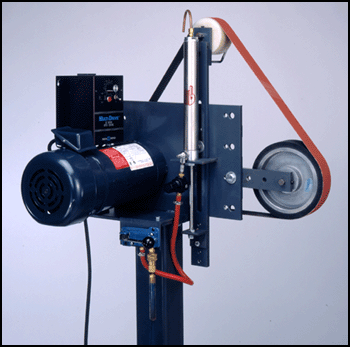

Dozier makes some of the best grinders there are. This series shows off the different accessory configurations they have available:
Here is the grinder. Note the pneumatic tensioner.

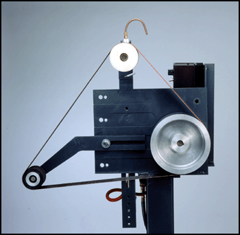

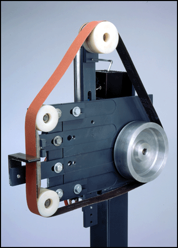

3 Configurations, left to right: the basic wheel, slack belt grinding, and a platen grinding setup…

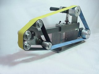

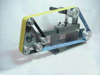

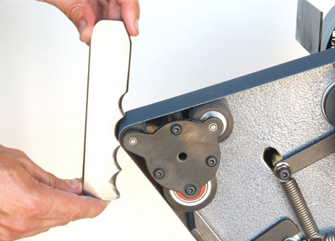

The Australian Radius Master Grinder
It has 5 interchangeable contact wheels that can be indexed into position–these 3 plus the other 2 corners of the triangle have larger wheels…

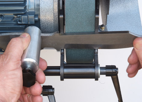

They also make a hollow grinding attachment that’s pretty neat…
