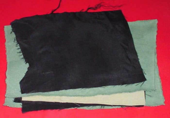

Start with a stack of fabric, impregnate with polyester or epoxy resin...

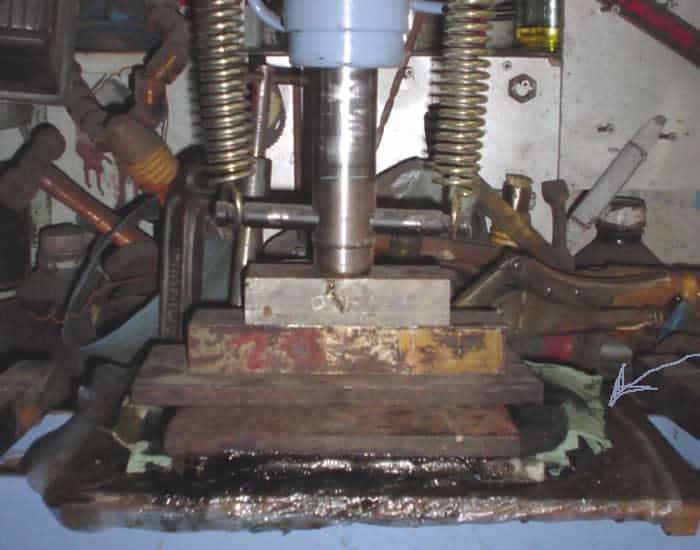

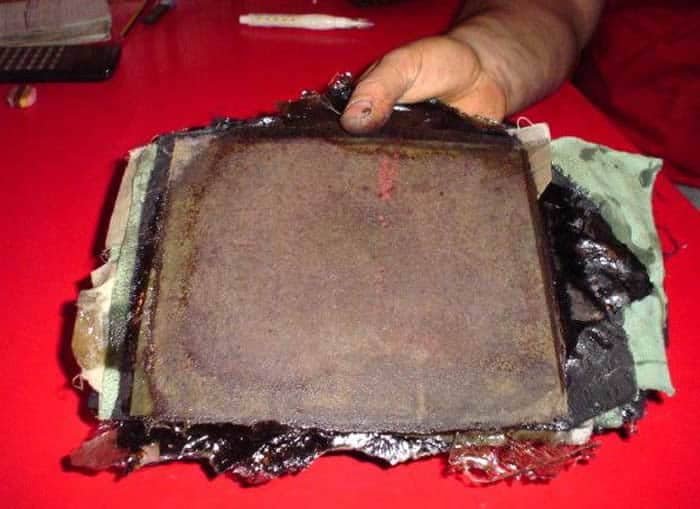

Place between two oiled plates on the press over night. The press gets all the bubbles out and makes the micarta solid as a rock. It comes out looking kinda nasty, eh?

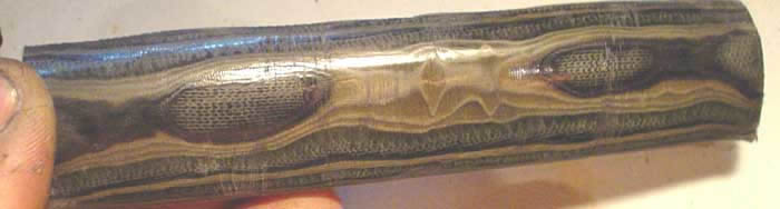

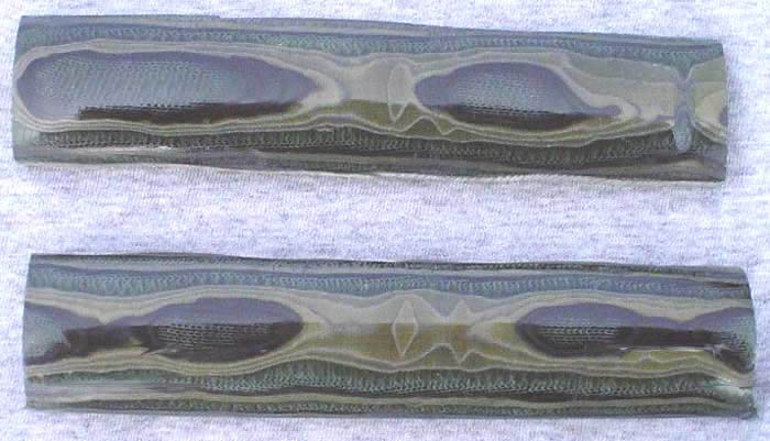

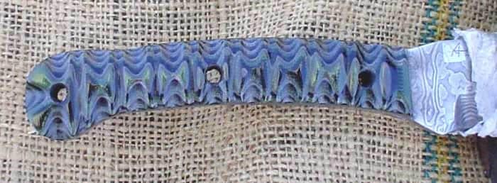

Now work it a bti and you see what's happening. 3 dimension tie dye. A controllable process that produces neat designs for handles and other purposes.
Dark-colored metallic or stone objects with wavy edges arranged in a staggered formation.
Polishes out pretty nice!

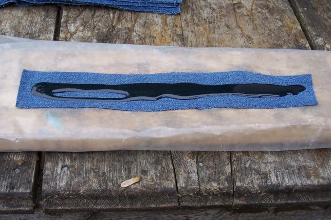

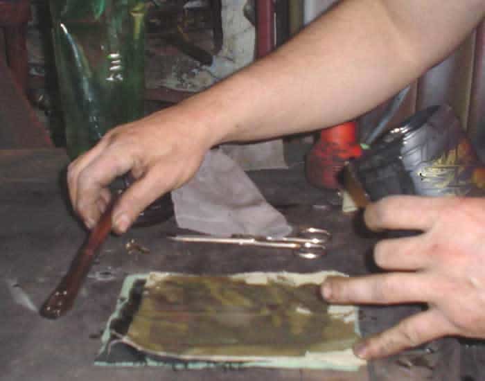

Start with strips from old blue jeans. Impregnate with resin.
Rustic wooden table with denim fabric, glue can, and black material.

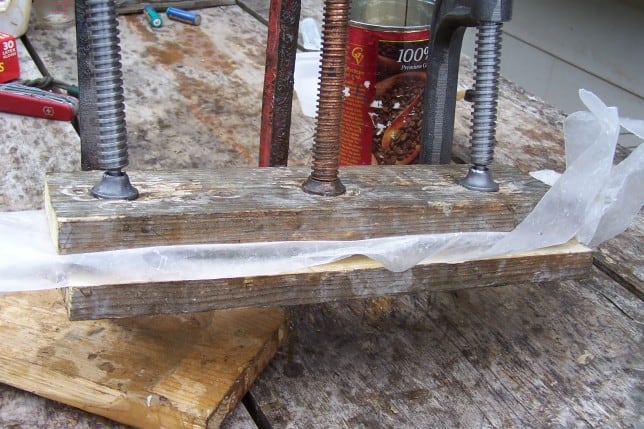

Wax paper and clamped boards while it hardens...

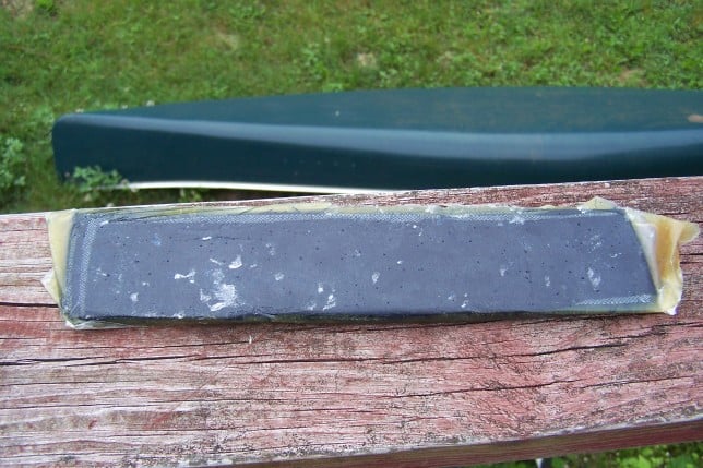

Worn metal object on weathered wooden surface with green grass backdrop.
Looks blah at first but finishes out beautifully! The ring pattern is because of the layers and how they intersect the curved surface of the knife handle.
