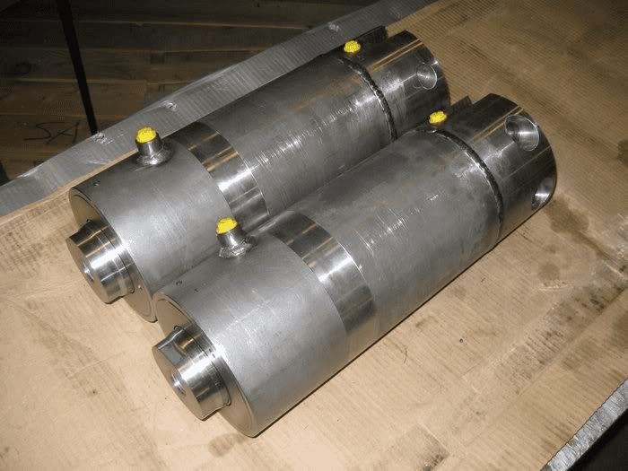

Meanwhile, there’s a guy over on CNCZone who has done a post showing how he built a CNC press brake from scratch. Very cool project! Here are a couple videos and pix:

Cylinder raw materials, and finished cylinders (this fellow does this kind of thing for a living, BTW)…
