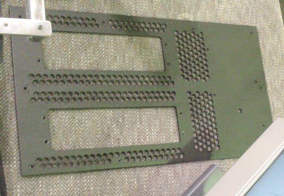

Here's an interesting thought. Imagine if you were tasked with creating one of these:
Metal plate with evenly spaced holes on each side.
Lots of little cooling holes in the electrical chassis panel...
Sticking in the CNC mill and doing lots of drilling and milling is the first thought that comes to most of our minds.  And that's not a bad idea at all.  But a piece like this would be much faster to do on a punch press. You're going to tie up that expensive mill on the mundane task of drilling tons of holes.  It might or might not be profitable and having a much cheaper machine do it might be a better answer.  But it's still daunting-you wouldn't want to do it manually, and you probably don't have a CNC Punch Press in the shop unless you do a lot of that kind of work.

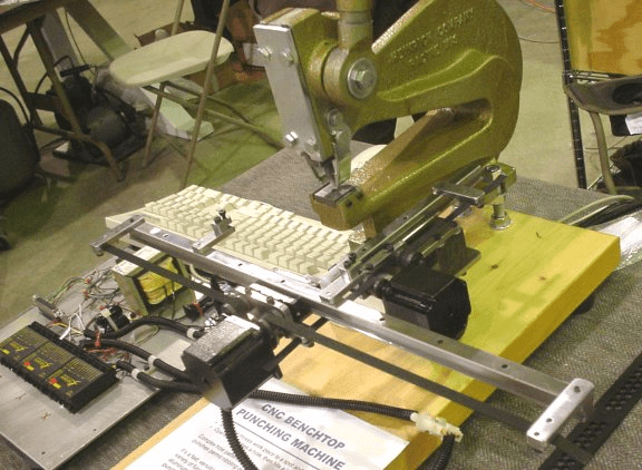

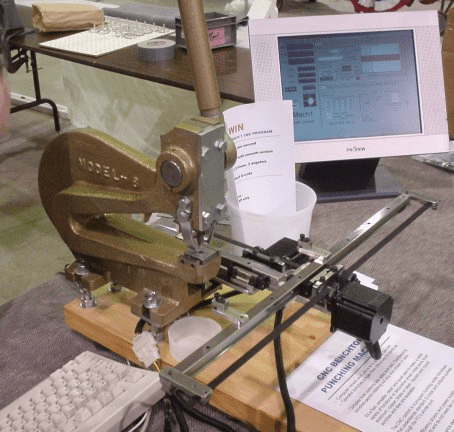

Enter this cute little CNC Punch Press made by a member of the Detroit club (can't find who) and exhibited at NAMES 2003:
Desktop computer with monitor showing CNCCookbook.com website.
Shopmade CNC Punch Press...
Take a little manual punch press and make a "table" for it that is driven by stepper motors and Mach 3 and you have just the tool for the job.  Here's another shot of it:
Green metal benchtop punching machine with yellow platform, wires, and components on gray workbench.
