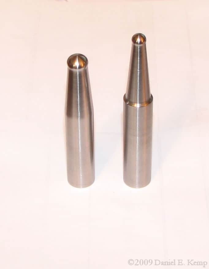

Some time ago I became aware of a fascinating technology for making arbitrary shapes from sheet metal, and my first thought was whether it could be used to make body parts for cars on a custom basis. The idea is to use a CNC to move a forming tool over the sheet metal that gradually works it into shape. This technology has even been attempted by talented amateurs such as Hoss (Daniel Kemp) over on the CNCZone. Here are a couple of tools he made for his experiments:
Typical tools for incremental sheet metal forming…
Check out his thread for more details. I don’t think he tried very hard but his results looked promising. There’s got to be a fair amount of art involved in deciding how much each pass can deform the metal before it tears or warps.

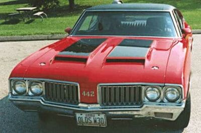

The dream for gear heads would be to have access to a machine like the one Ford was using to produce custom one of body parts. For example, a new hood for a vintage muscle car with just the right scoops. I’m current very fond of the Olds 442 convertibles, for example:
