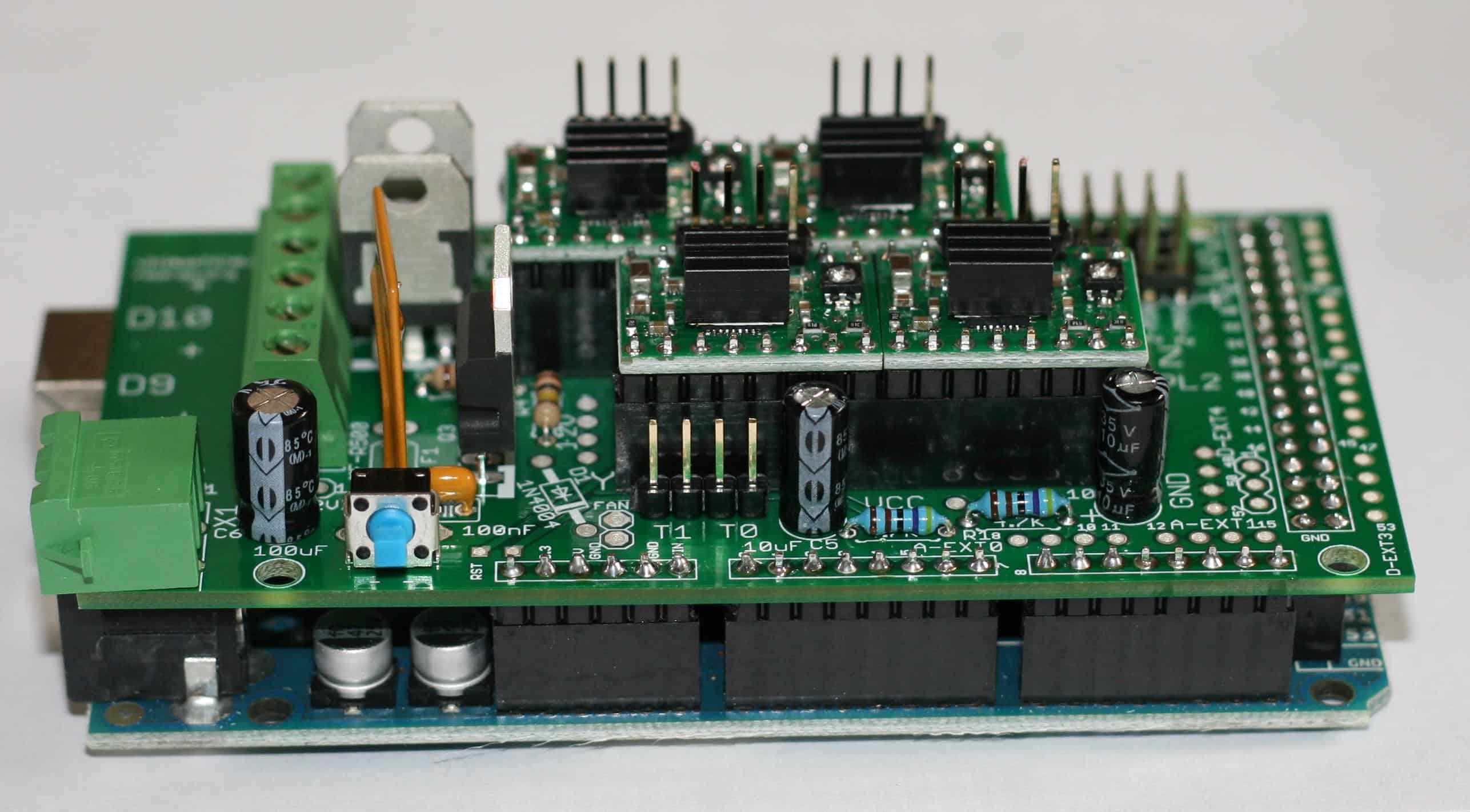

Enter the Arduino-based 3D Printer Controllers
In parallel to the RepRap 3D printer hardware project, the community latched on to the cross-platform Open Source Arduino hardware and software as the basis for a dedicated 3D printer controller. Arduino is a simple, but powerful, hardware architecture with built in I/O support for sensors, digital to analog convertors, analog to digital convertors and other features. Arduino includes a powerful IDE (integrated development environment) and a programming language that is very similar to “C”. The development process for creating both software (i.e. firmware) and hardware extensions on Arduino is seamless and easy to master.
Several Open Source 3D printer controllers developed rapidly. Of these, the RAMPS – or RepRap Arduino Mega Pololu Shield – platform has gained widespread acceptance. RAMPS plugs on to a standard Arduino (add-on Arduino modules are called “shields”) and provides control for up to 5 stepper motors, with three thermistor inputs, and three MOSFET outputs to control heaters and fans. It is also expandable to control other devices and interface to LCD displays and features replaceable stepper drivers. A RAMPS with an Arduino can be purchased pre-assembled for less than $200 and since these run Open Source firmware, there are no additional software costs. More recently, integrated designs like RAMBo (RepRap Arduino-compatable Mother Board) have emerged that offer lower prices and additional capabilities.
RAMPS on an Arduino
Wrapping Up
While it might be tempting to use traditional CNC controller hardware and software to power a 3D printer (in fact, this is how I got started), a general purpose solution for temperature and fan control is not available currently. A few hardy explorers have gone down this path (myself included) and soon realized that the capabilities and cost of an Arduino-based solution is pretty hard to beat – and there is a vibrant community offering support and help when you need it.
In the next post in the 3D Printing 101 series I’ll discuss the software chain, including the firmware that runs on the Arduino-based controllers.
