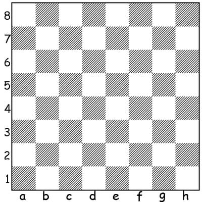

Most readers of the CNCCookbook are familiar with CNC routers and milling machines that typically feature 3 axes of movement. These axes are orthogonal to each other and are labeled X, Y and Z. The math used to instruct the machine to move along these dimensions, say to cut a circle in aluminum stock, is based on Cartesian geometry. Even though the math to describe arced and diagonal movements may be complex, the basic concept of Cartesian geometry is almost intuitive to most people.

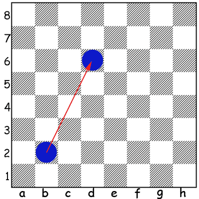

Consider the checker board shown below. In this figure, the columns (let’s call it the X axis) are labeled ‘a’ through ‘h’ and the rows (let’s call it the Y axis) labeled “1” through “8”. The movement of a checker on this board can be described simply by stating its starting and ending position as pairs of X-Y coordinates. In this example, moving the checker from (b,2) to (d,6) describes a linear path. It is a matter of convention as to which coordinate is presented first – in this case the X dimension – and all coordinate pairs should follow the convention.
This simple case of movement in a single plane can be applied to CNC plasma cutters or waterjet machines that cut 2 dimensional objects from flat sheets of stock. Axes for 2 dimensional movement are typically labeled “X” and “Y”. By adding a third, “Z” axis to move perpendicular to the X-Y plane, parts with 2-1/2 or 3D geometries can be fabricated.
