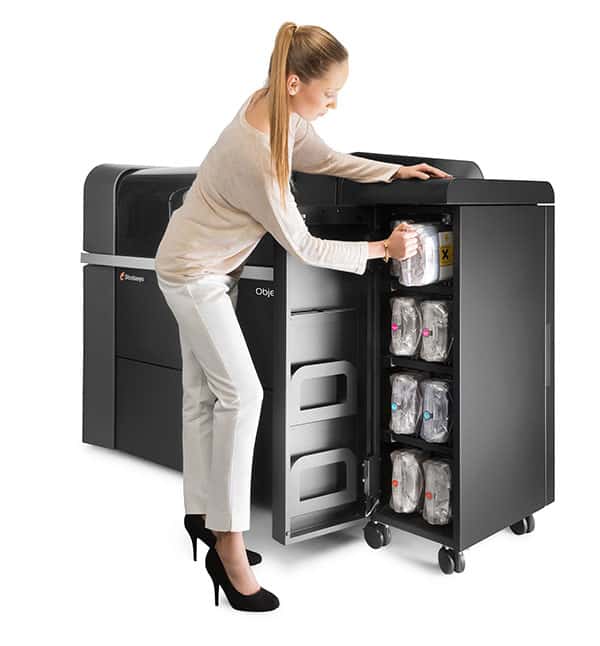

For plastics, we’ve chosen the Stratasys Objet500 Connex printer.  It’s capable of beautiful 3D prints in full color due to its unique PolyJet Technology.  The rainbow hued bicycle helmets pictured above were done with this printer’s technology.  This technology is similar to inkjet printing, but it jets drops of curable liquid photopolymer onto the build tray.  UV light then cures the tiny droplets. The printer is also capable of jetting a removable gel-like support material to take care of overhangs that would otherwise sag.  The support material is easily removed either by hand or with water.
The real fun begins with the ability to jet multiple materials or colors at once.  The Objet500 can include up to 14 different materials in a single job. Using multiple colors of the same material, they’re able to produce color palettes with many different colors in a single part.  Imagine multiple colors for the following base materials:
–  Rigid Opaque Materials:  Digital ABS, High Temperature Plastics and more
–  Simulated Polypropylene for snap fit, flexible closures, and hinges.
–  Rubber-like Materials for creating non-slip or soft surfaces
–  Transparent Material that mimics transparent thermoplastics
All told there are over 100 different materials available for this printer.
The accuracy and finish are good too.  Layer thickness can be as little as 16 microns (0.0006″).
This printer is cutting edge as it was just announced in January, 2014.
stratasys-objet500-connex3-05
Stratasys Objet500 Connex printer…

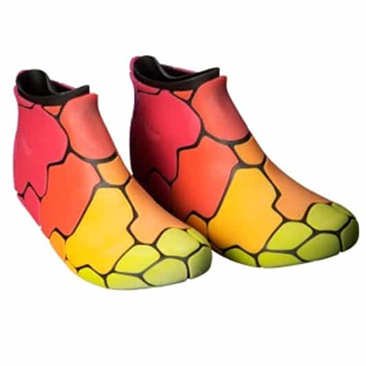

MulticolorShoes
Even the rubber-like materials can be done in multiple colors on this machine…

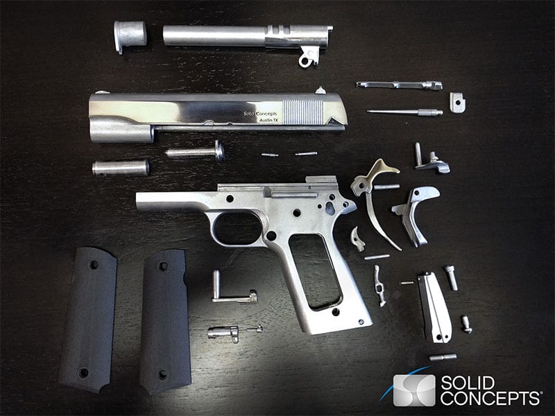

With that said, one of the companies that has the most experience manufacturing 3D Metal Printers is German company EOS.  These are the machines that GE will be using to manufacture the afore-mentioned Jet Engine parts, and they’re also the machines used by Solid Concepts to create the world’s first “real” metal 3D printed gun:
SC1911
The world’s first 3D Printed Metal Gun…
For that project, every component of the gun was made via 3D printing except for the springs.  That goes right down to the rifling grooves in side the barrel.  Not only did the gun function perfectly, but it was found to be accurate as well.  3D printing is capable of a great many things, especially when talking about very high end machines like these. The EOS M270 Direct Metal Laser Sintering machine used to create this M1911 gun project cost somewhere in the neighborhood of $500,000 to $1 million–not exactly the sort of thing to be found in very many shops.

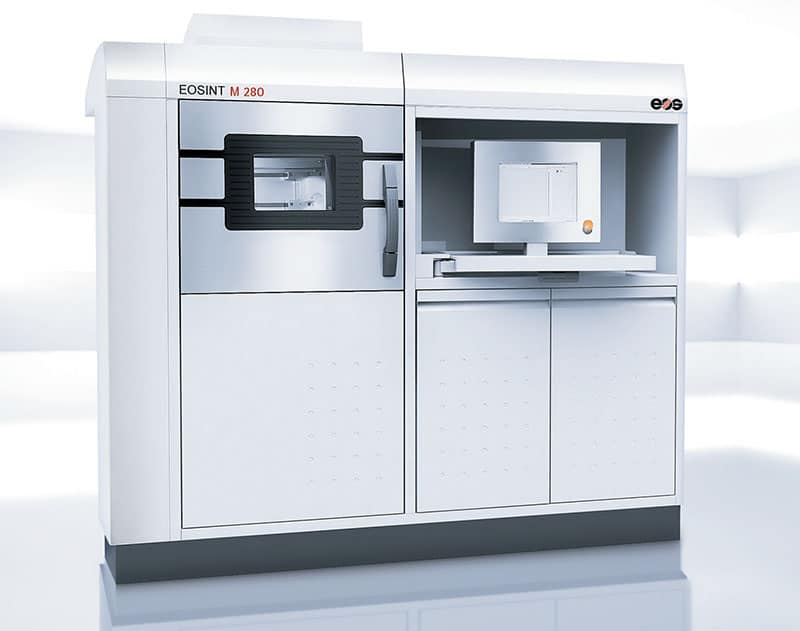

Each of these machines has a fiber laser of between 200W and 400W power.  In addition, provision must be made to do the printing in an inert atmosphere, such as argon, and to manage the powdered metals that are used to print with.  Dust is a real problem, and powdered metal dust is potential a fire and explosion hazard.  One of the main ingredients of firecrackers is powdered aluminum.  These machines have the proper management for all that built right in, but it is this sort of thing that drives the cost up.
Like most 3D printers, these EOS machines take an STL file and run it through their own Slicer software to produce the file needed by the machine to do the job.
EOSDLSM3D
The EOS M 280 Direct Metal Laser Sintering 3D Printer…
Build volumes for a machine like this are not huge:  9.85 x 9.85 x 12.8 in.  The minimum layer thickness is 0.0008″ and it has a mode that can also do 0.0016″ layers.  Tolerances on parts are in the 0.002-0.005″ range.
The machine can handle a wide variety of metal powders including aluminum, cobalt chrome (popular for medical devices), tool steel, aerospace nickel alloys, stainless steels, and of course, the titanium required for our bicycle helmet’s frame.  They even make machines for the jewelry industry that work with precious metal powders.
Pretty cool machine.  Insanely expensive.  Probably only to be seen in high end Service Bureaus, aerospace manufacturers (GE), and perhaps in the occasional Tony Stark-inspired workshop.  For those of you that don’t have Tony Stark’s budget, you can contract with one of the aforementioned Service Bureaus to have your parts 3D printed in metal.  Even this isn’t cheap, but it is a fascinating process.  Perhaps make a few in plastic first until you’re sure, and then get the final prototype done in Titanium, Stainless, or Solid Green Unobtanium, as suits your fancy.

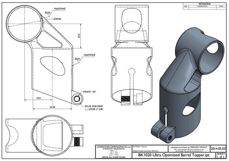

For those interested in the Service Bureau approach, I recommend checking out Spencer Wright’s ongoing blog about his fancy Titanium Seatmast Topper, which he’s been researching for potential 3D printing in Titanium.
