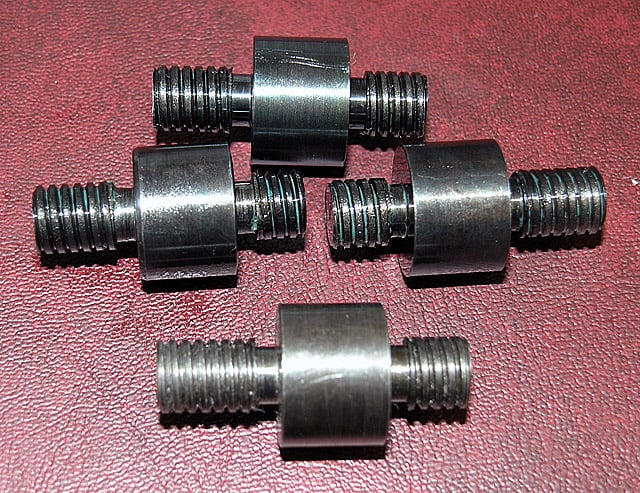

Cold bluing uses acids to put an oxidized finish on steel at room temperatures, or close to it. They're very easy to apply, requiring only a thorough degreasing before application. For fun I compared the finish from two Brownell's cold bluing products:
Dicropan T-4 and Oxpho-Blue Creme Cold Bluing Test
Both the Dicropan T-4 and the Oxpho-Blue Creme came as creams, which made them easier to apply. To perform the test, I took the spacers I had made for my new 6-jaw chuck backplate and compared the results. I simply cleaned them in some mineral spirits and then applied the compounds with a folded paper towel.
Do this wearing gloves as the chemicals are fairly nasty. The steel turns blue quickly, after which you rinse it in cold water to remove and neutralize the chemicals. I then oiled the parts with Break Free, which is also an excellent anti-corrosive. The oil helps bring out the blue a bit more.
My conclusion was that the Dicropan looked darker, almost black, and seemed to go on more evenly. On the other hand, the Oxpho-Blue showed more blues and was a prettier finish despite it being less even. If you want to try Dicropan, it's just $18.95 on Amazon.
Black threaded metal parts, possibly industrial.
Rear three: Oxpho-Blue. Front spacer: Dicropan T-4.
