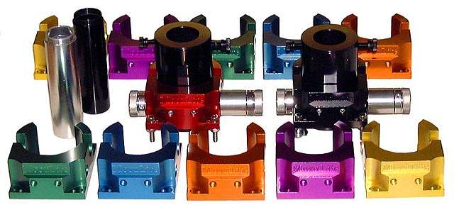

Anodizing
Anodizing uses electricity to open up pores on aluminum and deposit a pigment inside those pores. It also hardens the surface of the aluminum. It is a process that is fairly straightforward to do at home. I recommend a book by Ron Newman as your bible for anodizing at home. I haven't tried the process yet, but the book is very comprehensive and Ron seems to get good results for his own business using these techniques:
Colorful anodized metal parts on a CNC milling machine.
Ron Newman Anodizing...
Anodizing's hardening properties can also be quite helpful in making aluminum more durable.

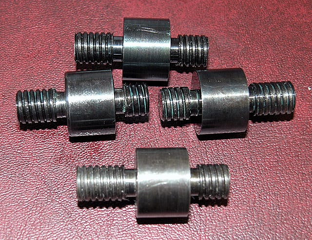

Cold Bluing

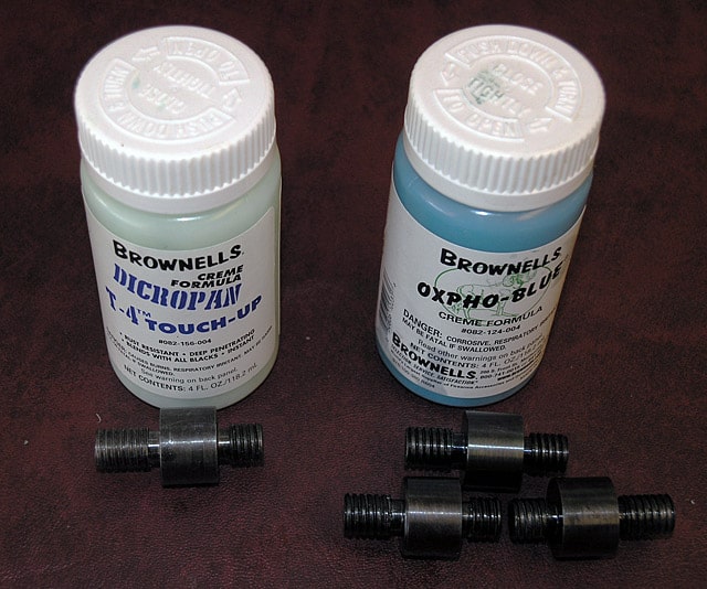

Cold bluing uses acids to put an oxidized finish on steel at room temperatures, or close to it. They're very easy to apply, requiring only a thorough degreasing before application. For fun I compared the finish from two Brownell's cold bluing products:
Two Brownells' Micropan and Oxpho-Blue chemical bottles with black cylindrical objects on a dark brown surface.
Dicropan T-4 and Oxpho-Blue Creme Cold Bluing Test
Both the Dicropan T-4 and the Oxpho-Blue Creme came as creams, which made them easier to apply. To perform the test, I took the spacers I had made for my new 6-jaw chuck backplate and compared the results. I simply cleaned them in some mineral spirits and then applied the compounds with a folded paper towel. Do this wearing gloves as the chemicals are fairly nasty. The steel turns blue quickly, after which you rinse it in cold water to remove and neutralize the chemicals. I then oiled the parts with Break Free, which is also an excellent anti-corrosive. The oil helps bring out the blue a bit more.
My conclusion was that the Dicropan looked darker, almost black, and seemed to go on more evenly. On the other hand, the Oxpho-Blue showed more blues and was a prettier finish despite it being less even. All things considered, I decided I preferred the Oxpho-Blue look. I'm not sure I'd want to do a whole firearm in it, but it's excellent for making tools look better.
Five black metal threaded rods with cylindrical heads on a red leather surface.
Rear three: Oxpho-Blue. Front spacer: Dicropan T-4.

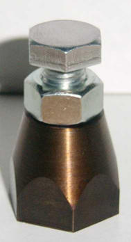

Hot Oil
Here is a machinist's jack finished with a hot oil treatment:
Hexagonal nut with silver head and brown conical base.
I like the look of the finish, though I don't know how protective or durable it may be. It was done by Dave Hylands who states that he simply "cooked" the jacks in his BBQ for 30 minutes and then plunged them into some 20W-50 motor oil.

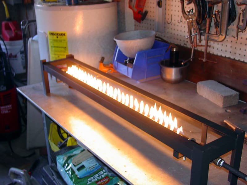

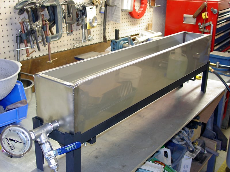

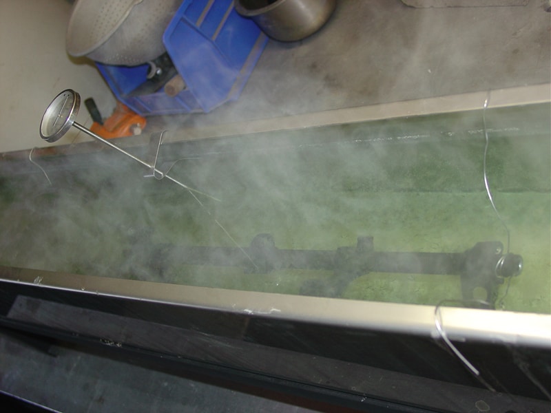

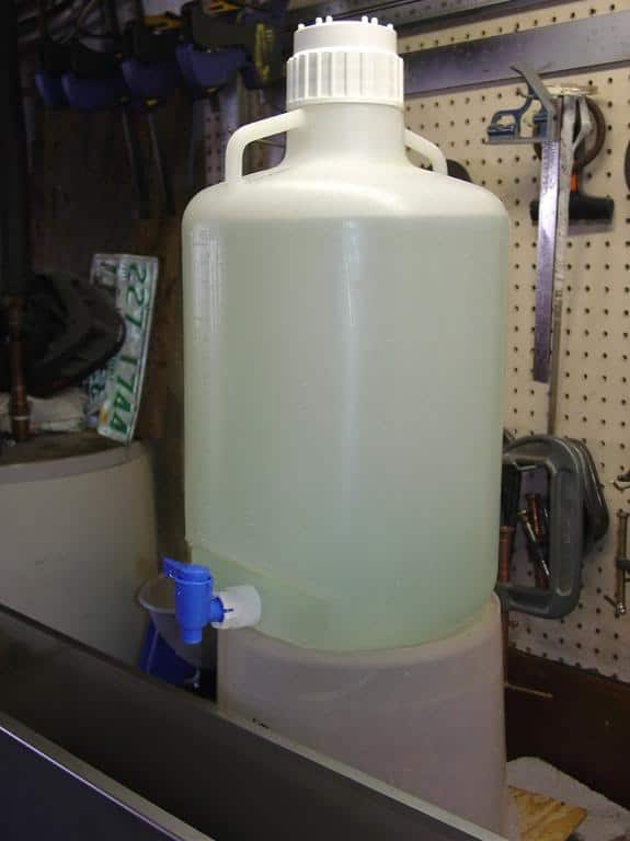

Parkerizing

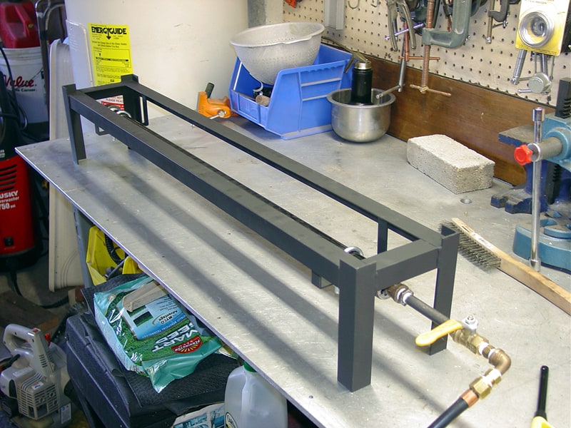

Parkerizing is a very durable treatment often used on firearms. It's pretty straightforward to set up a Parkerizing process in a small shop. Here are some picks from an HSM thread:
A well-organized workbench with metal frame in workshop or garage setting.
Stand for a Parkerizing tank is just welded from angle iron...
A rectangular metal firebox with flames burning inside.
Shopmade propane burner...
Stainless steel water tank on metal workbench with tools and equipment in a well-organized workshop.
Tank needs to be stainless. This one was purchased from eBay for $99...

Large white plastic container with handle and spigot.
Mixing chemicals up in a big container like this is very convenient. Strain through a coffee filter and return to the container when finished...
Workbench with tools, mirror, and machinery.
"Cooking" a firearm in the solution. Rinse with clean water then apply the Lauer Post Treatment solution. When that's all done, a little oil and you have a military-grade nearly rust-proof finish!

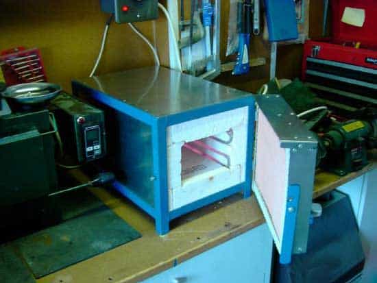

Treatments (i.e. Heat Treatment, etc.)
This is definitely an area I'm very interested in experimenting with, both for the hardening properties afforded heat treated steel as well as the awesome temper colors that can be produced.
I have been interested in heat treating metals for a long time, and finally sat down to do a little web research on how to build a heat treat furnace. Industrial PID controllers are readily available on eBay cheap, and the rest of the materials required are not expensive either. I'm adding something like this to my "someday" project wish list:
Blue furnace on wooden workbench in machine shop or metal fabrication facility.
Home-built Heat Treat Oven...
Links about making your own furnace:
The Home-built Heat Treat Oven Pictured Above: A nice project with lots of photos.
https://www.knifeforums.com/forums/showtopic.php?tid/752668/post/775813/hl//: Not much on pix, but some good tips and techniques. For example, there is a high temperature mortar/calk available at Home Depot to seal the bricks that is good to 2000 degrees. You want a "K" type thermocouple for this kind of project.
