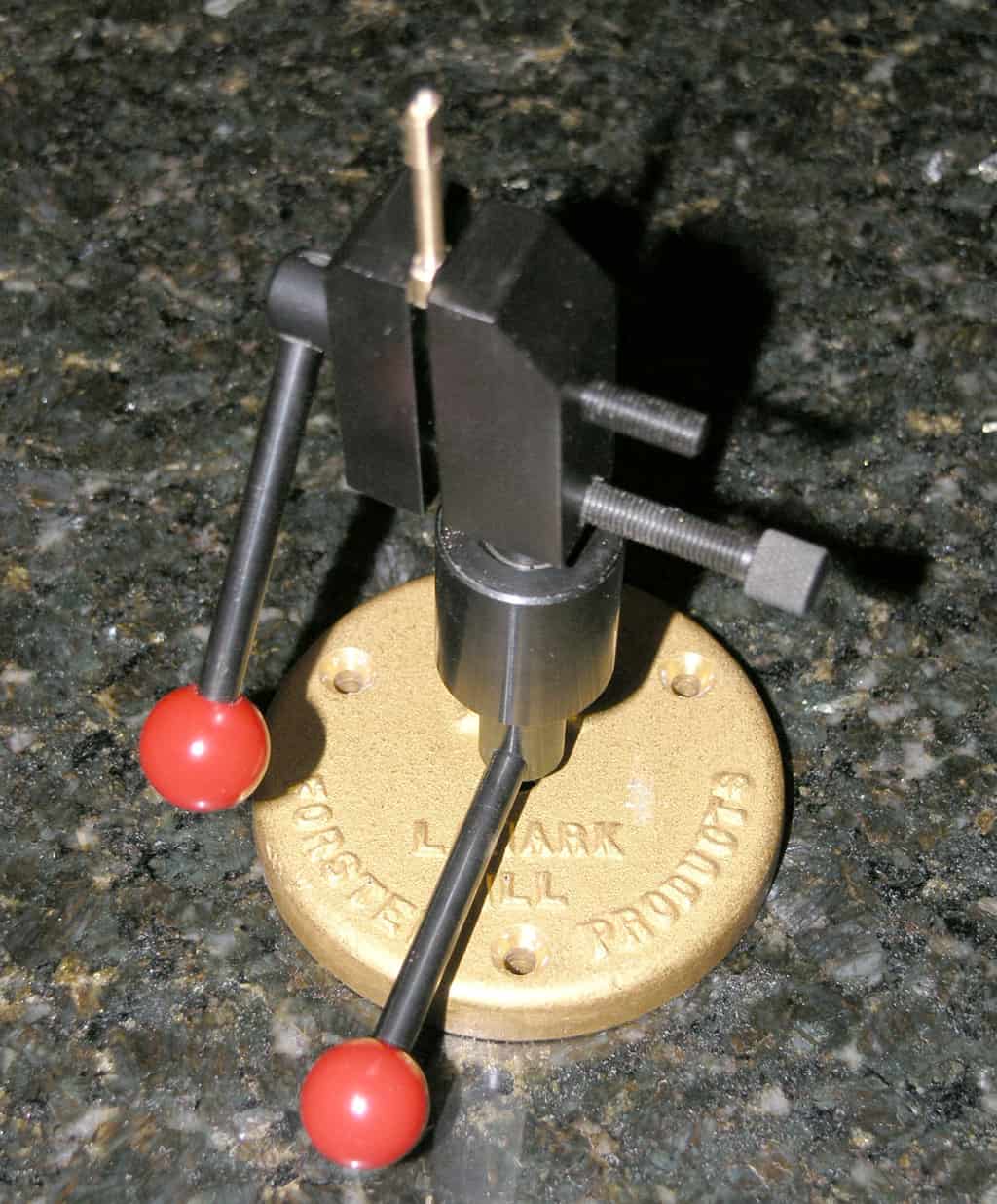

A Handy Vise for Small Parts
It’s called a “Forster Swiv-o-ling” vise, and it’s a gadget every machinist should have. It’s basically a machinist’s parallel clamp set up as a vice. Very convenient for fiddling with small parts. Gunsmiths use them, and I got mine from Midway. It was very handy during the making of these tiny little steam engine connecting rods to do a little fine work with a file deburring them.

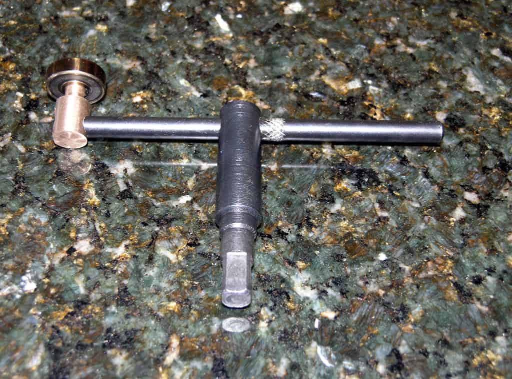

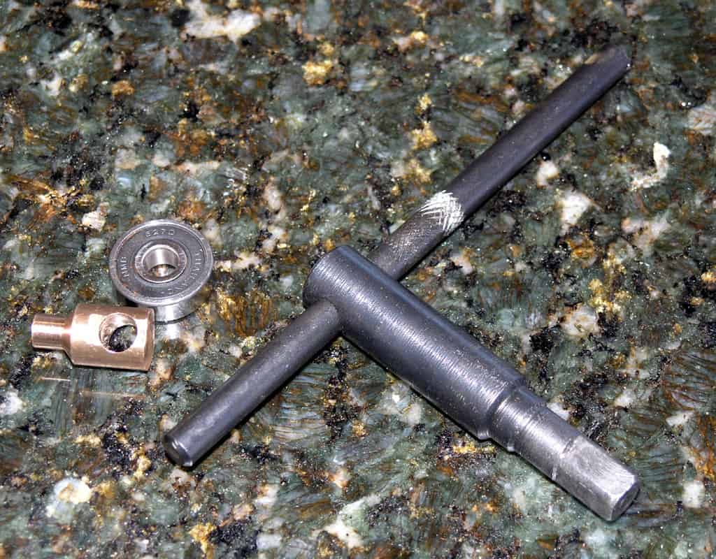

Use a Bearing to Make a Speed Handle
Did this for a collet chuck key on my old manual lathe, simple but effective:
I knurled the key handle to keep the bearing from moving around. A couple of drops of LocTite added to the knurling, and it’s solid. I’m sure you can find many other handy uses for a cheap bearing, but this one came out really nice for me.

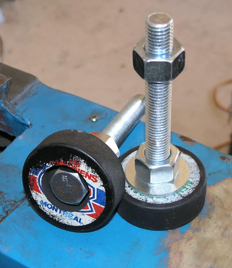

Machining Hockey Pucks is Fun!
I have found hockey pucks to be easy to machine and handy for various uses such as this set of leveling feet I made for a project:
I bought a box of used ones from eBay very cheaply. Now I’ve got a decent grade of rubber I can machine for various projects.

Cool ideas.
That Forster vise is an interesting idea and would make a great beginners project. The design could be adapted for use on a number of third hand apparatus. For example a pillar tool, or a PanaVise base.
Given that the design just cries out as a good platform to start a beginning machinist off on. Substitute a 5 or 10 pound barbell weight for the casting with a stud through the center hole and you don’t even need to address a casting.
