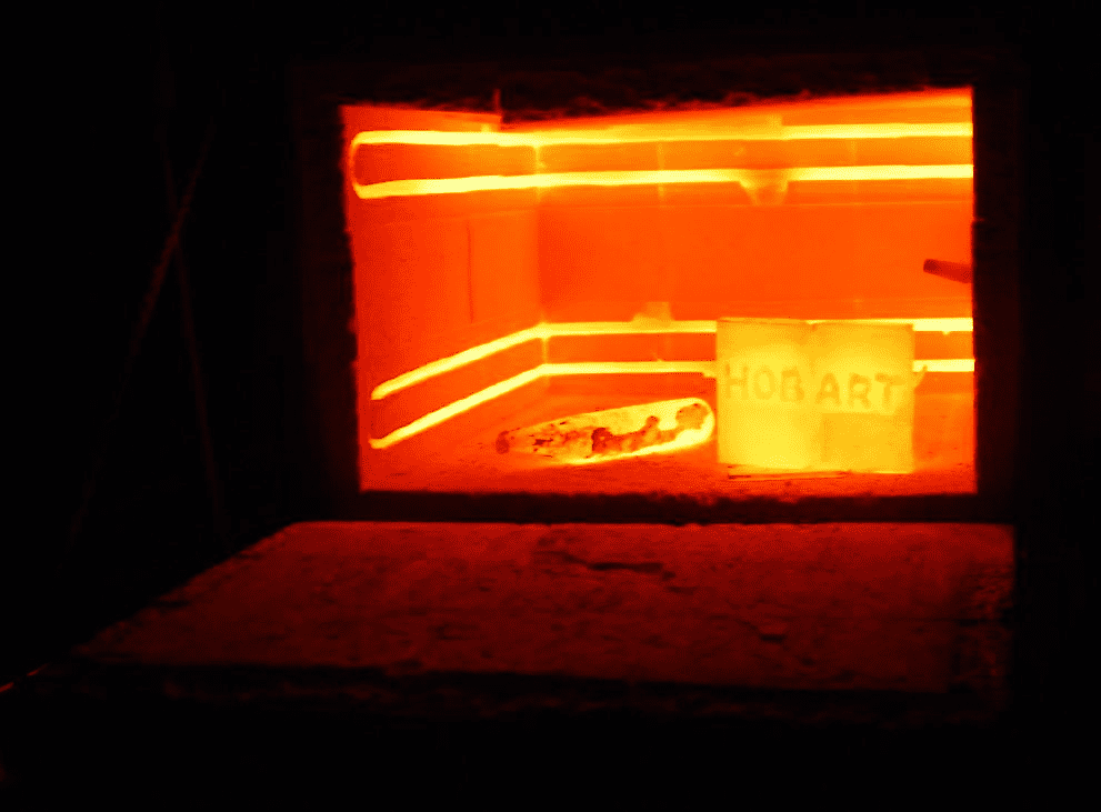

Heating
Heating is the first stage of the heat treatment process. The metal or alloy is brought to some specific temperature. Usually that temperature is the Critical Temperature. The critical temperature is also known as the Normalizing Temperature.
The key temperature transformation points in heat treatment are:
- Normalizing Temperature: Austenite phase is where other structures are formed. Most heat treatments begin by heating steel to a uniform austenitic phase of 1500-1800F.
- Upper critical temperature: This is the point below which cementite or ferrite begin to form. It occurs while steel is cooling from the normalizing temperature. It occurs from 1333-1670F.
- Lower critical temperature: This is the point of austenite to pearlite transformation. Austenite cannot exist below a lower critical temperature of 1333F.

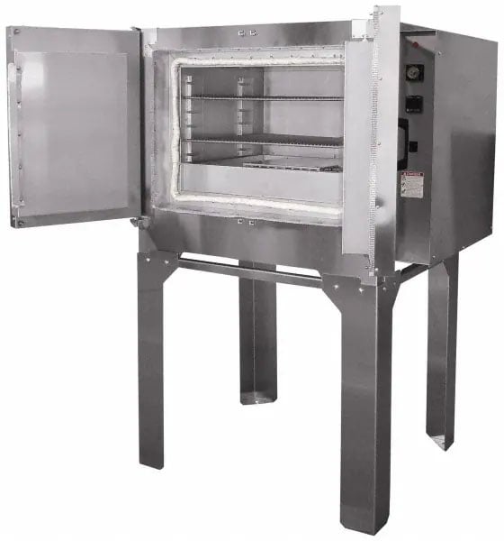

Soaking
Soaking is keeping the metal at the target temperature for a specific length of time so that its structure may be completely changed. The greater the mass of material being heat treated, the longer it will be soaked.
Cooling
Cooling is the third and final stage of heat treatment. It also changes the structure of the material. Cooling may be accomplished by quenching (dropping the material in some liquid at a lower temperature so it is cooled quickly) or letting it rest in still air for slow cooling.

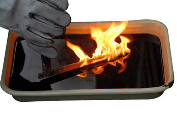

Quenching
Quenching is a heat treatment process where the material is cooled rapidly.
Quenching in Oil. Courtesy of Valvoline…
After a material has been heated up it may be quenched in water or oil to harden it to the maximum. Parts that are quenched are never used until after they’ve been aged, tempered, or stress relieved to further improve and fine tune their final properties. If nothing else, quenching can introduce lots of internal stresses which can lead to parts warping.
