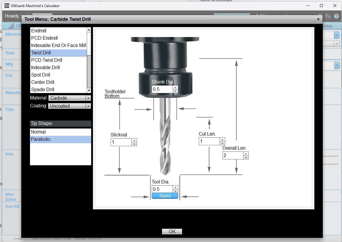

Feed Rate and Drilling Speed
Feed rate and drilling speed are critical factors when using carbide drill bits. Given how expensive carbide drill bits can be, it's worth investing in the most effective feeds and speeds solutions available.  Get a good Feeds and Speeds Calculator, like our G-Wizard Software:
Twist drill bit with measurement labels in grayscale.
G-Wizard is equipped out of the box to deal with carbide drill bits, and it will even figure feeds and speeds for through coolant drills.
