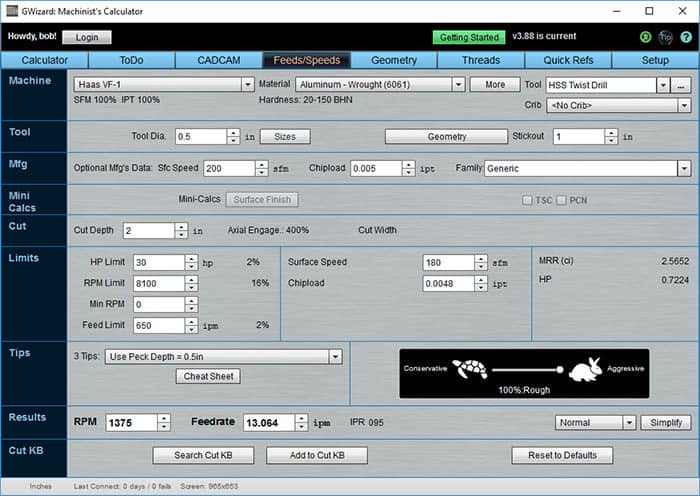

Here are the G-Wizard feeds and speeds for a 1/2″ twist drill going 2″ deep in 6061 aluminum:
Regular Twist Drill feeds and speeds…
The Material Removal Rate is 2.57 cubic inches per minute. Now, let’s try that same hole with a Parabolic Drill. To change, click the Geometry button:
Just select “Parabolic” Tip Shape from the Geometry menu…
Here are the feeds and speeds with Parabolic:
The MRR goes from 2.57 to 3.00 cubic inches per minute with a Parabolic drill…
The MRR goes from 2.57 to 3.00 cubic inches per minute with a Parabolic drill. That’s about 17% faster–worth it for many jobs!
