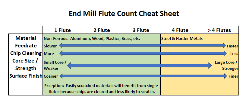

End Mill Flute Count Cheat Sheet
Metalworking tool flute count chart for different materials.

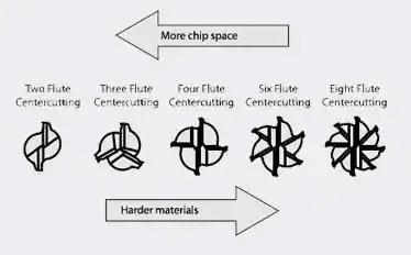

Understanding Flute Count
Chip space material configurations for CNC machining: Two, Three, Four, and Eight Flute Centercutting.
Flute count, number of valleys, and valley width
Flute count plays a crucial role in end mill performance, affecting core size, durability, chip evacuation, and surface finish. Understanding the basics of flute count is essential for selecting the right tool, whether you’re working with aluminum or steel, roughing or finishing.

Flute count is a term that describes the number of cutting edges on an end mill, such as four flute mills. The general rule is to use 4 flutes for machining steel and harder alloys, as they have smaller flute valleys, which provide less chip evacuation.
On the other hand, 2 flutes are commonly used for machining aluminum and non-ferrous materials, offering a longer tool life. Various coatings like TiN, TiCN, AlTiN, and Diamond finishes are available for 2-flute end mills, further enhancing their performance.
So, why is the flute count important? It has a direct impact on core size, strength, chip evacuation, and surface finish, especially when using a 2 flute end mill. More flutes mean a larger core and increased tool strength, making it suitable for virtually any material.
However, more flutes also reduce the flute valleys that facilitate chip evacuation during machining. End mills with higher flute counts are better for machining tougher materials that require a smaller rate of metal to be removed. This makes them ideal for handling harder, more ferrous materials.

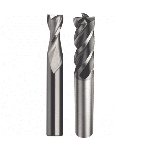

Comparing 2 Flute and 4 Flute End Mills
Silver metal object with twisted design and parallel grooves.
2 flute vs 4 flute end mills...
2 flute and 4 flute end mills are commonly used in machining applications, each offering unique benefits and limitations depending on the material and operation. In the following sections, we’ll explore these differences in greater detail, helping you make an informed decision when choosing between 2 flute and 4 flute end mills for your specific needs.
Understanding the differences between 2 flute and 4 flute end mills is essential for selecting the right end mill.
2 Flute End Mills
2 flute end mills are designed for milling grooves or slots in softer materials such as aluminum. They offer effective chip evacuation and higher material removal rates due to their larger gullet for enhanced chip clearance. Solid carbide 2 flute end mills, in particular, provide superior hardness, strength, and wear resistance, making them ideal for working with wood and aluminum.
When working with softer materials, 2 flute end mills are your go-to choice for roughing applications, ensuring efficient material removal and a quicker cutting speed. The larger chips generated by 2 flute end mills also contribute to their suitability for roughing operations.
4 Flute End Mills
4 flute end mills, on the other hand, are designed for harder materials such as steel, providing increased tool strength, smoother finishes, and higher feed rates than 2 flute end mills. They are more suitable for slotting applications on steel, stainless steel, high temperature alloys, and iron.
Four-flute end mills are well-suited for high-speed cutting of hard materials, such as iron, alloys, and other similar substances, due to their strong resistance to heat and their ability to cut more efficiently through the material’s microstructure. Enhancing the rate at which the metal is taken away from the workpiece, 4 flute end mills are a great option for general-purpose cutting and finishing work.

End Mills with more than 4 Flutes
You can get end mills with very large numbers of flutes indeed.  They're ideal for really tough materials such as titanium, high temp nickel alloys, and stainless steels.  Such materials usually can't be spun very fast without burning up your cutters.  Having more flutes keeps the feedrates up so that material removal rates can be higher despite the lower spindle rpms.
