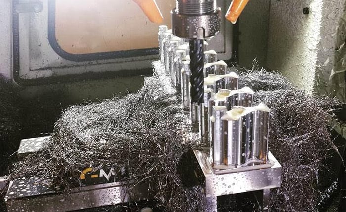

We Use Endmills for 2D Profiling
For 2D Profiling, we’ll be using endmills as our cutters.  These are cylindrical cutters that have a flute, much like a twist drill, except that the flute is sharpened (unlike twist drills) so the endmill can cut with the full length of the flute.  In addition, the bottom of the endmill is typically flat, so the endmill is a cylinder in other words.

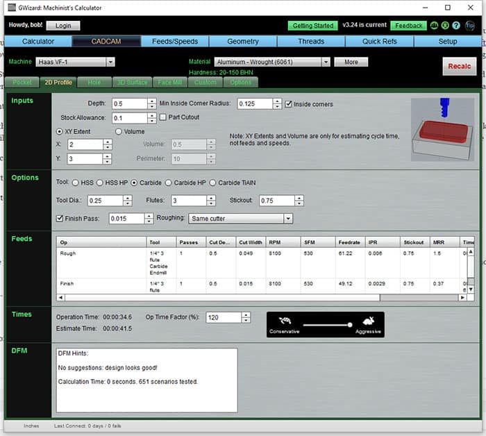

Letting G-Wizard’s CADCAM Wizards Choose Your Cutter
The CADCAM Wizard function in G-Wizard Calculator will automatically choose an endmill for you based on the rules described above.  Here’s an example:
CCW2DProfile
Cutting a 2D Profile…
In this example, we specified 3 values:
  • 0.5″  depth for the material
  • 0.125″ radius inside corners
  • 0.1″ allowance for stock removal
The CADCAM Wizard came back with a recommendation for a 1/4″ 3 flue carbide endmill with a stickout of 0.75″.  It also provides a complete recipe for Roughing and Finishing with Feeds and Speeds, Cut Depths, and so on.  CADCAM Wizards makes this sort of thing very quick and easy.
