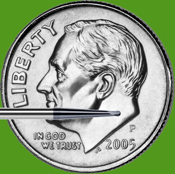

Endmills are available in a variety of standard sizes both metric and Imperial. Even very tiny micro-mills can be had for machining extremely small features. Something surprising to know about endmill size is that the tolerances on diameter for most endmills are not especially precise. If your work demands precision, you may need to make a test cut with an endmill to determine what its real diameter is. You can also measure them directly, but the test cut is a more reliable method.

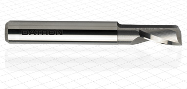

There are quite a few other varieties available that are seen less often. Endmills with more than 4 flutes are great for increasing productivity on tough materials like Titanium where the spindle just can’t turn very fast. And there are a whole host of situations where a single flute endmill offers advantages:

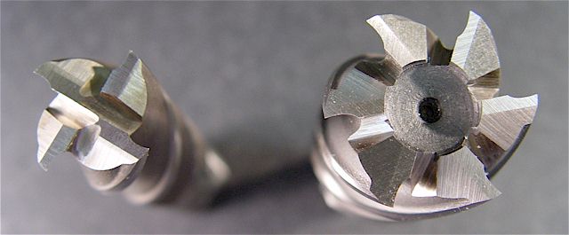

Center Cutting or Not?
Most 2 and 3 flute endmills are center cutting. Some 4 flute endmills are not. A center-cutting endmill is one that can be plunged straight down into the material. None center cutting endmills have a depression in the middle with no cutting edge, so they’ll go down a very short distance and then can be pushed no further:
Two end mills with center-cut and non-center-cut cutting edges, shown side by side on a gray surface.
Center cutting on the left, non-center cutting on the right...
The only good reason to buy a non-center cutting endmill is they’re cheaper. I prefer to only have center cutting endmills around as I most often discover an endmill is not center-cutting the hard way.
BTW, there is an argument to be made never to plunge endmills (well, almost never). It’s the hardest possible way to get the endmill into the material, ramping or helixing are far more gentle. Given that perspective, perhaps one should always prefer non-center cutting so as to be incented to avoid plunging.

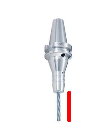

This brings me to an important concept which is called “Stickout.” Stickout is the distance from the end of the toolholder to the tip of the endmill:
Metal tool with long cylindrical shaft and conical tip.
Stickout…
The more stickout the less rigid a tool is. If it sticks out too far without support and you work it too hard, the cutting forces will make it bend, which machinist’s call “Deflection.” Here is an exaggeration of that effect:
Silver metal drill bit with twisted design.
The takeaway at this stage is that while it may seem smart to buy endmills that are as long as possible because you’ll have flexibility to use them in more situations, that’s probably not the best way to go. Shorter endmills are more rigid. Save the extra long ones for times when you have no other choice. We’ll see something similar with Twist Drills as well.

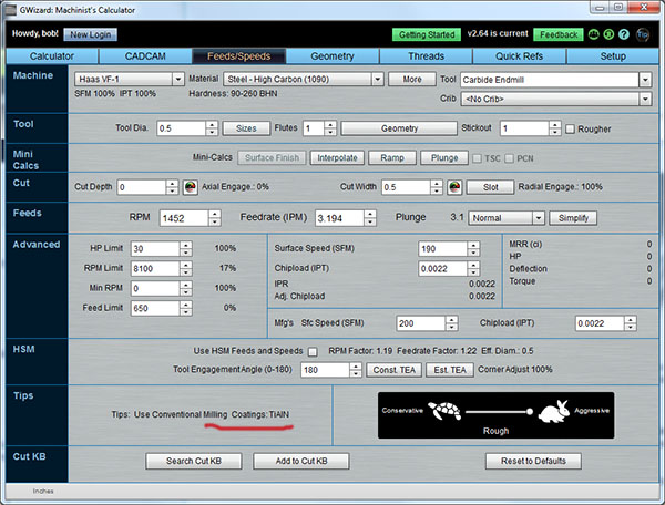

Endmill Coatings
The right coating can dramatically increase the performance of an Endmill (or other cutter, such as a twist drill). There are lots of different coatings available, some of which are amazing and some of which are very exotic and expensive. The choice to use coated endmills is a cost versus benefit choice. If your machining benefits enough from the extra performance of a premium coating, by all means, purchase endmills with a coating.
It helps to know which coatings are good for which materials. Our G-Wizard Calculator software tells you that:

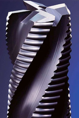

Roughing Endmills (aka “Corncob” roughers)
Roughing end mill with distinct tooth profile and cutting edges.
Roughing endmills like the one pictured have little serrations in the teeth. These serrations do a couple of useful things. First, they break up the chips making it easier to clear them out of the hole you’re cutting in. Second, the are less prone to chatter. All those serrations produce a variety of vibrations that interfere with one another instead of creation a single ringing (more often screeching, lol) tone.
Roughing endmills are not very expensive and can provide a nice step up in productivity. I like having some around in a couple of sizes, especially sizes that are a little small for a decent indexable endmill. See our article on these useful cutters for more info and be aware that G-Wizard Calculator can figure the feeds and speeds for them too.

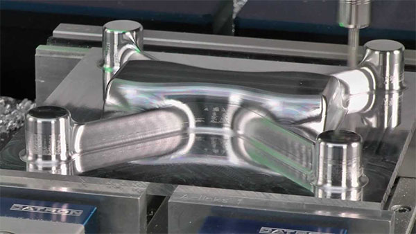

Ballnosed Endmills
So far we’ve talked about endmills that are largely used for what’s called “2 1/2D” machining, sometimes called “Prismatic” machining. This is machining where the Z or height of the surface doesn’t change in smoothly flowing contours. It may drop down for a pocket or two, but the floors of the pockets and the top of the part are generally smooth planes punctuated by holes and more pockets. The vast majority of parts have this characteristic, but for those that don’t, you’ll be doing true “3D” machining, and to do that, you’ll want to use a Ballnosed Endmill.
A shiny metal mold with four cylindrical protrusions.
Molds often require 3D machining…
Ballnoses create scallops whose size depends on the diameter of the ballnose, the depth of cut, and the stepover between successive passes:
