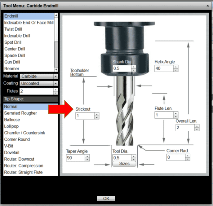

What is Tool Stickout?
Tool Stickout is the distance from tip of tool to where the tool’s shank goes into the tool holder or collet.  It’s one of the key dimensions G-Wizard asks for when you are setting up a tool:
tool stickout
Why is Tool Stickout Important?
Tool Stickout is one of the largest variables governing tool deflection.  If you press on the tip of a tool with your finger, you can probably see it deflect, especially if it is a smaller diameter tool.  It isn’t hard to see that the more the tool sticks out, the easier it is to deflect.  The last piece of the puzzle is that excessive tool deflection causes extreme tool wear.  Uh oh, now you’re seeing why stickout is important, right?

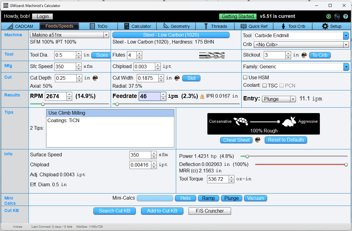

But, not everyone has had the evils of excess stickout ingrained. Recently I was reading a post over on PM by a machinist who was unhappy at G-Wizard because he’d broken his endmill after running some feeds and speeds he got from it. Not a happy story. I hate breaking a cutter, although for me, it mostly happens when I fat finger an MDI move and rapid into something, LOL! BTW, I’ve trained myself just not to use G00 in MDI. Life’s too short, but I can be patient while the machine moves at a feedrate that is slow enough I can press the big red sphicter button if I screw up the MDI.
Getting back to our story, this fellow wanted to use a 1/2″ 4 flute Carbide EM to cut a 3/16″ wide (actually that was the widest, it was a diagonal cut along an edge) by 1/4″ deep cut. He got back feeds and speeds of 2353 rpm and 46 IPM. Not sure how he got to the latter, as I get 29 IPM from the G-Wizard when I enter the parameters as I mention on the post. But, as it turns out, I don’t think the 46 vs 29 IPM feedrate disparity is the issue. He posted a picture and sure enough the experienced hands of Practical Machinist immediately focused on his tool stickout. His 1/2″ EM looks like it is hanging down 3″ or so.
Turns out we can use G-Wizard to check this. If we take that cut and change the default 1″ stickout in G-Wizard to read 3″, as well as overriding the recommended feedrate to 46 IPM, there is an immediate warning–tool deflection is 0.0078″ and that’s lit up in bright red:
Too much deflection is called out in angry red: 0.001486″
We recommend a maximum of 0.001″ when roughing, a figure several tooling manufacturer’s have confirmed, and this cut is producing nearly 8x that. Sure enough, the cutter broke.
Stickout is an interesting thing. A 1/2″ carbide EM seems pretty darned rigid right up until you hang it out far enough and pump some horsepower into it (that’s a 1.5 HP cut too). It’s interesting because of the deflection effects, but also because it affects chatter. Of course it makes sense for something that governs deflection so much to matter for chatter too. It’s worth making a New Year’s resolution to standardize your shop’s stickouts and not just let them turn out randomly. Make sure you have some really choked up on the cutter and some where it hangs out there so you have some reach. The reason to standardize is twofold.

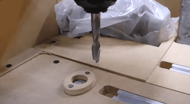

I watch a fair number of videos on machining when I’m not busy producing content or writing software for CNCCookbook.  It’s surprising how many Stickout “Bloopers” you see when prowling videos of even prominent CNC YouTubers.  Here are just a few I’ve come across:
175,000 views; 51,000 subscribers.  Stickout is 7.6:1 in diameters.  Max thickness cut in view suggest a stickout of 1/3 that much would’ve been better!

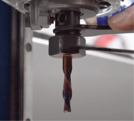

47,000 views, 68,000 subscribers.  6.4:1 stickout.  In this video, he came much closer to needing the full stickout, but still could’ve choked up on it to 2/3 this much stickout for better results.
Many machinists just stick the tool in the holder and go from there, not giving much thought to stickout, but here are some serious side effects when you have too much stickout.  The more stickout, the more tool deflection for a given amount of cutting forceTool Deflection is very bad for tool life, and also makes it hard to cut accurately if you tool is bent like a pretzel from deflection.
Get used to how tools with too much stickout look from the bloopers above.  A rule of thumb–anything over 7-8x diameter on carbide and 3-4x diameter with HSS tools is too much.  The closer you get to those numbers, the more trouble you’ll have with tool deflection.

Tool Stickout is an important topic because it governs a lot of the limiting factors around using the tool.  Stickout is the distance from the tip of the tool to where the tool shank goes into the tool holder.  The longer that distance, the further the tool sticks out.  That’s helpful when you need the clearance, but increasing stickout can severely reduce the rigidity of the tool in the cut.

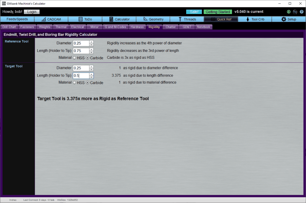

G-Wizard Calculator includes a Rigidity Calculator, so let’s use it to get an idea of what I’m talking about.  Suppose we have a 1/4″ carbide endmill with a stickout of 3/4″.  If we can pull the tool up into the toolholder just 1/3 of the stickout, in other words, if stickout was 1/2″ instead of 3/4″, that tool would be 3.375X more rigid:
Suppose we can reduce that 1/2″ of stickout to 0.430″ of stickout–that’s just 70 thousandths less.  Turns out that’s enough to increase rigidity another 50%.  Even relatively small changes in stickout matter a lot to rigidity!  And that rigidity can radically affect all sorts of important areas:

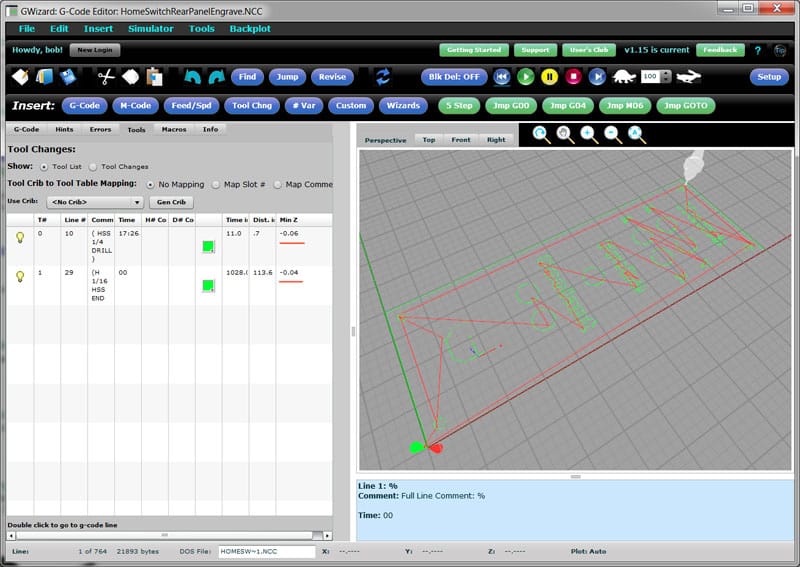

With the caveats of coolant access and flute length in place, the most obvious strategy is to minimize stickout for each tool and each particular job.  To do so, we need to be able to take measurements of how far below the top of stock each tool will go for a particular job, and we’ll need some idea how much additional clearance may be needed to clear clamps and other fixture parts as well as any part features that may stick up and be in the way.  One easy way to quickly get an idea of how much clearance each tool requires is to use our G-Wizard Editor.  As part of loading and simulating a program, it produces a tool table on the Tools tab that has the lowest Z coordinate used for each tool:
ToolMinZ
The minimum Z for each tool is in the “Min Z” column in the Tools Table.  This is a new feature in GWE v1.15…
This particular program is one of our stock sample files and it is an engraving program for a thin aluminum electronics panel.  There are two tools, one with a minimum Z of -0.060″ and one with -0.040″.     Given that it is an engraving job, not much stickout is needed, so we can keep tools short.  By using G-Wizard in this way, you can tell exactly how much stickout a given program needs.  Of course you’ll have to know what Z corresponds to top of material and do the math as well as adding an allowance for any fixtures, clamps, or part features that might be close enough to get in the way, but you can save yourself a lot of time this way as well as winding up with really optimal stickouts that maximize rigidity.

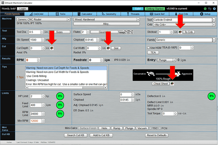

Okay, you’ve got the tool in the tool holder, you entered your stickout into G-Wizard, and it’s giving you a deflection warning.
Darn!
But, no worries.  First, G-Wizard lets you optimize multiple variables to fix a deflection warning:
  • Cut Depth
  • Cut Width
  • Tortoise-Hare Slider
  • Stickout
Yup, you may not have to touch the tool at all, just change one of the other parameters.  You can find the exact value needed by clicking the little speedo button next to the parameter (arrows point to speedo buttons):
G-Wizard will calculate the maximum value of the parameter that doesn’t trigger a deflection warning with one click.
