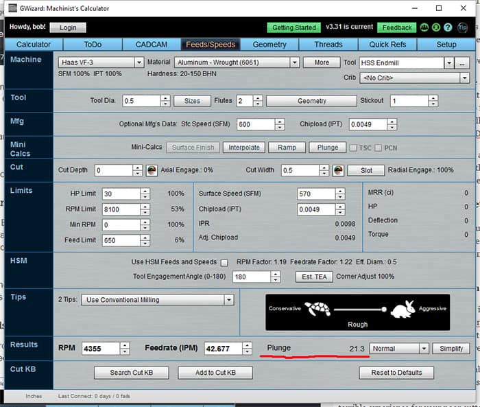

The simplest way to get our cutter in is just to plunge it vertically as if it were a Twist Drill. There are some issues with this. First, not all endmills are “center-cutting.” The cutting edge may not extend all the way to the center, so they can’t plunge straight down, at least not very far. Be sure to check whether yours is center cutting before you decide to plunge it.
The second issue is that plunging is absolutely the worst thing for tool life. The endmill is down in a cylindrical hole that completely encases it. Coolant has a hard time getting down that hole and chips have a hard time getting up the hole. On the whole (sorry for the pun, couldn’t resist), plunge is a terrible experience for your poor cutter.
To minimize Tool Wear when plunging, be sure you use special plunge rate feeds and speeds. Our G-Wizard Calculator will give these two you:
You need a special plunge feedrate (in red) to minimize excessive wear on the tool…
If you’re working with tough materials or if you need to go more than about 1 diameter deep, you probably should use an alternative to a plunge to enter the pocket and get down to cutting depth.

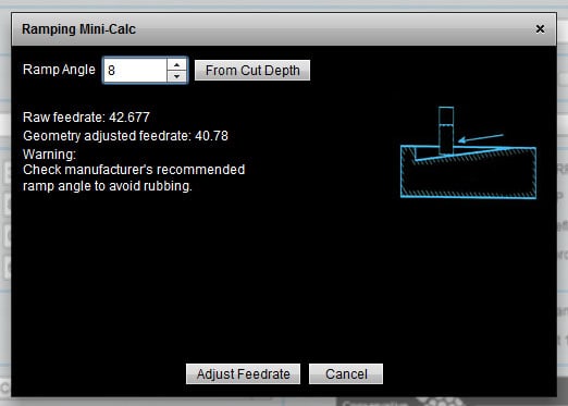

Ramp Down
Ramping down means moving the tool horizontally while it is going deeper. It’s a much better strategy than plunging from a tool life standpoint. G-Wizard has a special ramp angle calculator that can help you figure the feeds and speeds for the ramp:
Feedrate for ramping can be nearly the same as horizontal motion if ramp is gentle enough…
The feedrate for ramping can be nearly the same as horizontal motion if ramp is gentle enough. There’s not much to argue against ramping except that it can prolong the time the cutter is in a slot, and hence shrouded somewhat from coolant. It’s harder to pull chips up out of a deep slot unless the mist, air blast, or coolant is aimed perfectly into the slot, which can be hard to arrange.

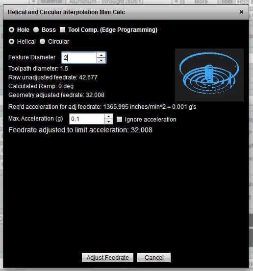

Helix Down
Our final approach would be to helix down. This is similar to interpolating a hole and is usually my preferred approach. If we can helix out a fairly large area, it makes plenty of room to clear chips. Plus the helix is fairly gentle on the cutter.
As you might expect, G-Wizard has a calculator for feedrates on these helixes too:
G-Wizard can help adjust feedrates for Helixes too!
