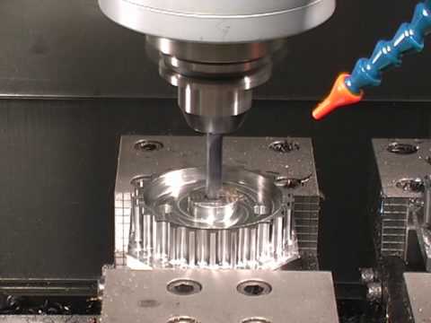

I include an Excel spreadsheet to help calculate the two scenarios in the article, but the bottom line was an example that showed that as soon as you had more than one such pocket-starter-hole to make, the twist drill came out ahead. I also discussed how a number of machinists keep a 1" or larger insertable drill in their toolchanger for just such occasions. In fact, here's a neat little video showing exactly that approach in the making of a timing pulley:
