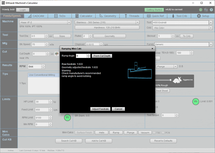

Let's assume we've decided to use helical interpolation.  What should our feedrate be and what should the helix ramp angle be?
Use the calculator at the top of this page to figure it out.
Start out figuring feeds and speeds for slotting. Say we have a 1/2" carbide endmill and we're cutting 6061 aluminum, and our speeds and feeds calculator gives us 43 IPM for a full-width slot. Let's say we're going to make a 2" hole and helix down 1/4" per revolution. Enter those numbers above and the programmed feed at the tool center comes out to 32 IPM (43 x 1.5 / 2), which is a little slower than the 43 IPM a straight slot calls for, with a ramp angle of 3.0 degrees.
The helix angle is based on the idea that the endmill will achieve the depth of cut specified in one rotation.  So, if we need to helix down 1", and we specified a 1/4" DOC as we did for this example, it will take 4 rotations at these feeds and speeds to get to the bottom of the hole.
There are some things to be wary of.  First, evacuating chips down in a hole is hard.  The closer the hole to the endmill's diameter and the deeper it is, the harder it becomes.  A high pressure through spindle air blast is favored for deep helical interpolation for that reason.  It's really hard to get a flood coolant nozzle pointed right to blast the chips up out of the hole as the interpolation is happening.  So, don't be stingy on the hole diameter, and don't be afraid to reduce the depth of cut per rotation (e.g. the ramp angle) on tougher situations.

LIke Helical Interpolation, it's important to adjust your Feeds and Speeds for the ramped cut.  You can't just cruise on in as if you are making a normal cut.  The calculator above also shows how long a straight ramp at the same angle needs to be to reach your depth.
Speaking of ramp angle, different tooling, and especially indexable tooling (such as face mills), will have limitations on the maximum ramp angle the tool's geometry can accomodate.  If the tool can plunge a hole, there won't be such a limitation.  A 4 flute non-centercutting endmill will have a limit as will an indexable tool.  If using such tools, be sure to look up the manufacturer's recommendations.
A lot of machinists are pretty conservative on their ramp angle.  I see recommendations like 1.5 degrees or 2.5 degrees all the time.  You can go faster than you'd think.  OSG talks about 10 to 20 degrees in tough materials for some of their endmills.  Granted, those are premium endmills, but don't be afraid to be a little more aggressive.
