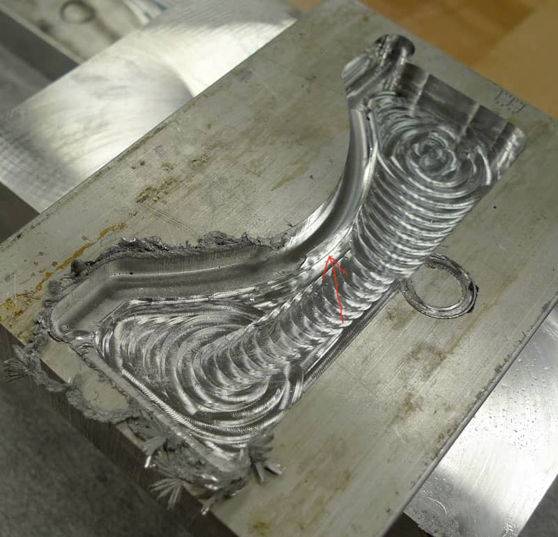

The faster we feed, the fatter the chips we’re cutting.  Fatter chips are a great idea because we remove material faster and the fat chips can carry away a lot of heat.  That’s all great right up until the chips are too fat and coming off too fast.  When that happens, they completely fill up the flutes of the endmill, it jams, and typically it snaps off.  This usually happens pretty early in the cut, although sometimes things change in mid cut and we wind up with the same effect.
For example, too much deflection caused this cut to fail when the deflection allowed a small wall to develop that prevented coolant from going where it needed to go:
Red arrow points to the wall that developed and ultimately killed the cutter…
In the end, it’s pretty obvious that too much speed, whether rpms or feedrate, kills cutters.

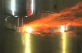

Lest you think it’s okay to slow down too much with uncoated tools, I’ve got to throw one more wrench into the works.  Materials like steel don’t cut like cheese even though we use cutters with edges that seem like knives.  Instead, what happens is the material heats up enough that you can slice through its crystalline structure.  This is called “plasticizing” the material because it becomes more like plastic.  So again, a certain minimum temperature level is called for before the cutter can do its job.
You’re pretty unlikely to be running so slowly you can’t plasticize the material, but it’s worth keeping in mind.  Here’s a video that shows the plastic behavior of chip forming very clearly–it looks like lava on top of the material that the cutter then scoops off:

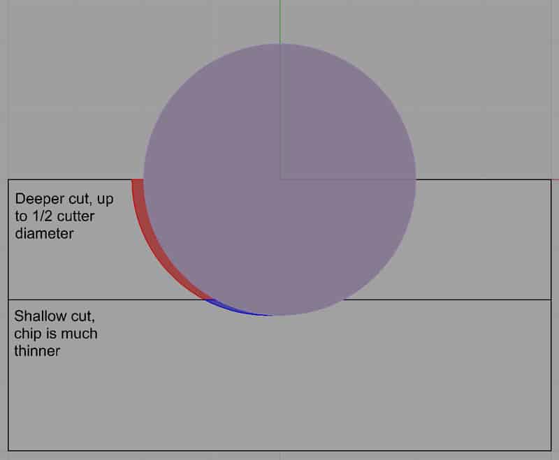

Rubbing Can Sneak Up On You Because of Radial Chip Thinning and Other Geometry-related Issues.
Any time you run the cutter with a cut width that is less than half the diameter of the cutter, there will be some radial chip thinning.  The cutter will make thinner chips than simple formulas predict.  This diagram shows why:
Radial Chip Thinning causes smaller stepovers (Cut Widths) to create thinner chips (less chip load)…
Yikes!  Here we were thinking that taking a very light cut would be very conservative and instead what we’re doing is causing too little chip load (due to chip thinning) and therefore rubbing.
