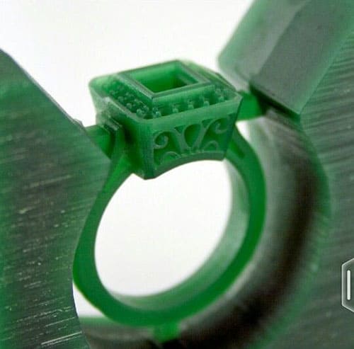

I guess we may as well start with what many probably think of when they think of CNC and jewelry: lost wax casting.  This is probably the hardest thing to do, but many of you will find it interesting.  You start by CNC’ing a model of the piece you want to cast, like this:
CNC Lost Wax Casting
#1 – CNC Lost Wax Casting
You carve the casting model out of wax using tiny little micromills.  You’ll probably need a 4th axis and some serious CADCAM skills to pull it off.  The good news is machinable wax is on G-Wizard Calculator’s Materials Database and G-Wizard also has also micro-milling support, so we got your back.  But, if you can muster all that up together with some serious design skills, you will be at the top of the CNC Jewelry-making heap.
You’re going to take that wax model, cut it loose from the block of machinable wax you used, and embed it in a plaster of paris-like material used for lost wax casting.  You will then place this thing, which is in a crucible, into a burnout oven.  Think basically of a kiln.  The high temperatures will burn away the wax and leave a cavity in your casting medium shaped just like the ring, right down to very fine detail.  You will then use either centrifugal force or vacuum to force molten metal such as sterling silver or gold into the mold.  Get rid of that plaster of paris stuff, polish it up a bit, and you’ve got a ring all ready to go!

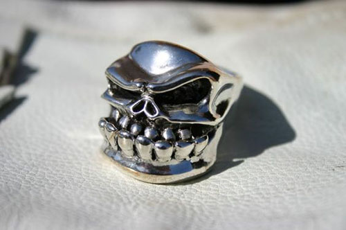

Here’s another typical example you could choose to make this way, somewhat less petite and delicate:
skullring
#2 – Skull ring…
A lot of the challenge in pieces like these is workholding.  You need to be able to support it while you get at it from virtually every angle.  Tabs and a 4th axis help a lot.

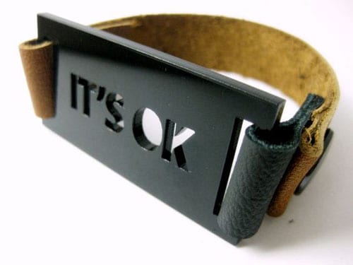

lasercutbracelet
#6 – Silhouette Bracelet with leather band…

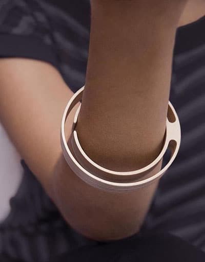

How about we kick it up a notch?  Here’s a lovely and very modern looking bracelet:
bracelet
#7 – CNC’d Bracelet?
I know your devilish CNC mind is already processing how to CAM this simple piece, and perhaps what to make it out of.  Is there an anodized aluminum color she’d really like?  If you’re ambitious, machine it, put it in your 4th axis, and engrave something onto the outer circumference…

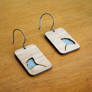

lasercutstackedearrings
#7 – Three different finishes, laser cut, and stacked…
stackedearrings
#8 – Stacking can reveal color…
When we stack, we need to join the pieces.  You can glue them.  In fact, Loctite is just glue for metals and it works really well for this sort of thing, it’s dead easy, and you probably have some already kicking around the shop.  For a more durable solution, you can learn to silver solder.

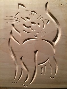

abstractcat
#9 – Abstract cat carved into a piece of exotic wood and hung from a pendant would be nice…

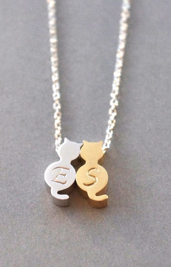

twocats
#10 – His and her initials engraved on the two cats make a really neat pendant…

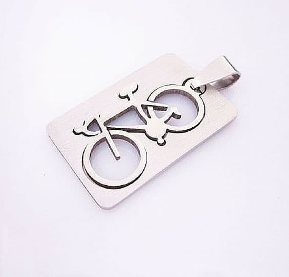

bikependant2
#11 – Combining engraving with 2D Silhouette Cutout is a really neat effect for some projects…

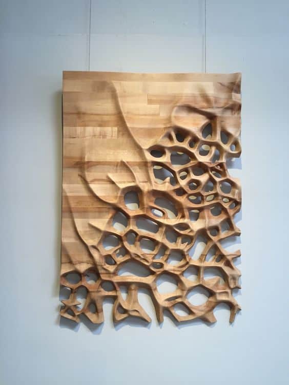

texturependant
#13 – This is a wall hanging, but I highly textured and abstract piece like this would be neat as a pendant.  Serious CAD skills and a penchant for 3D Profiling (or a super easy 3D program like MeshCAM) will be requirements to pull it off!

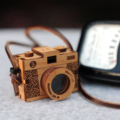

camerapendant
#14 – You know you could do this!  It’s not all that crazy complex.  You could make several parts and loctite them together.  Engraving for the textures and logos would be key too!  What other everyday object would your gift recipient love to see packaged as a pendant?

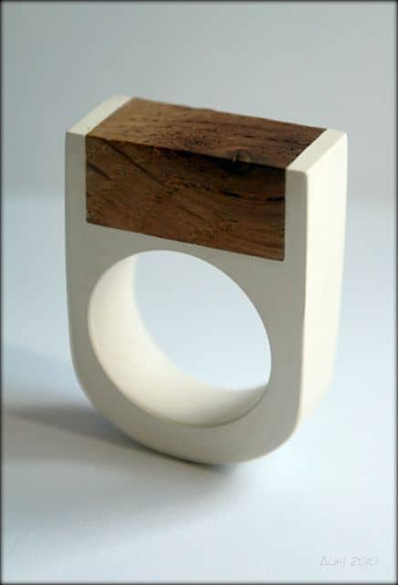

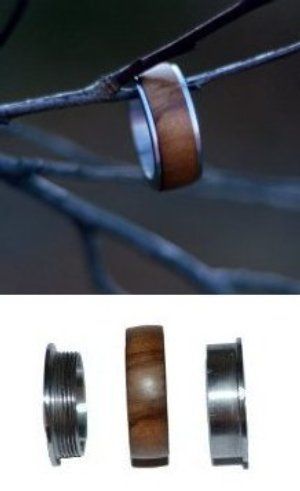

woodmetalring
#16 – I know, you were wondering when you’d see some jewelry made like the parts you make every day.  How about this wood and metal ring that threads together?

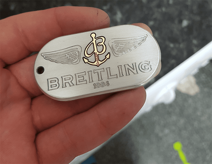

Inlay always looks valuable and hard to do.  And the truth is, it ain’t easy.  But, with CNC it is entirely doable and by mere mortals.  Check out this cool Breitling Dog Tag:
cnc jewelry inlay
#18 – The anchor is a brass inlay that has been epoxied into place.  Looks perfect, doesn’t it?

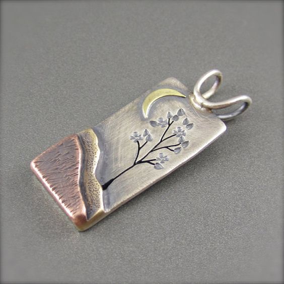

Damascus Makes Gorgeous and Unique Jewelry
damascus jewelry
#19 –  Damascus Pendant.  The Damascus is from Vegas Forge.
Damascus steel is a fascinating material.  Take two different alloys, bind them together into a matrix, using heat and pressure, then etch them with acid to show off the resulting patterns.  This kind of work is fairly common to knife makers, but it also makes gorgeous jewelry as the pendant above shows.

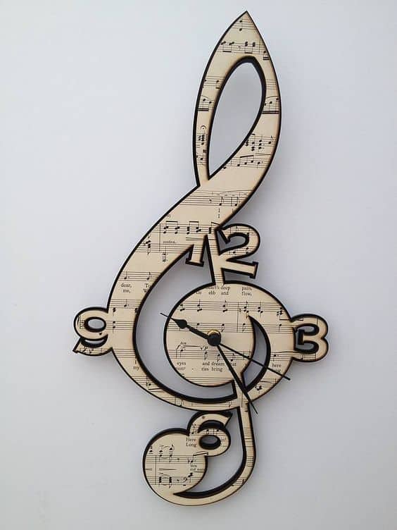

Don’t be too literal when you’re searching for inspiration.  I find another great source of inspiration is signs and similar kinds of work.  It’s not exactly a sign, but I could imagine a miniature version of this clock perhaps with less engraving being a neat pendant if your gift recipient likes music:
treblecleffclock
#20 – Imagine this neat clock as a pendant for a music lover done silhouette-style…
