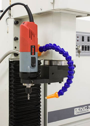

Let’s go through a really inexpensive example. We’re going to look at the impact of bolting on a cheap auxiliary high speed spindle in the form of attaching a little Kress spindle to a Tormach CNC Mill:
The Kress spindle clamped to the Tormach’s main spindle…
It doesn’t look like much, does it?

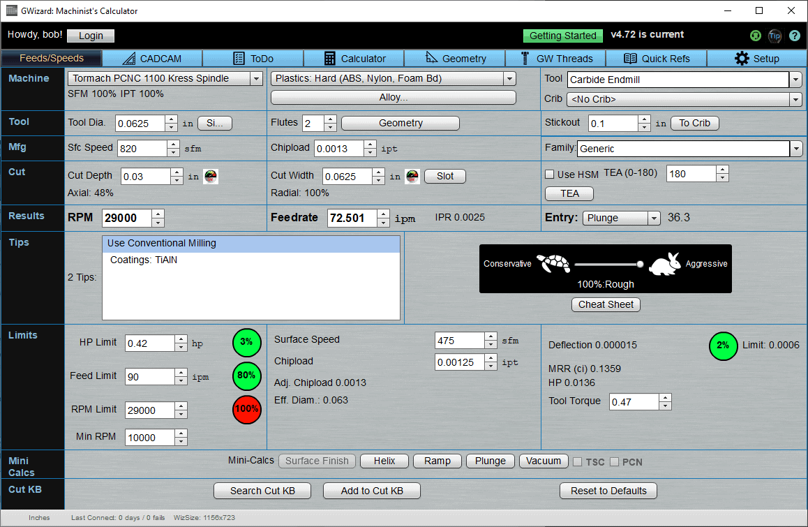

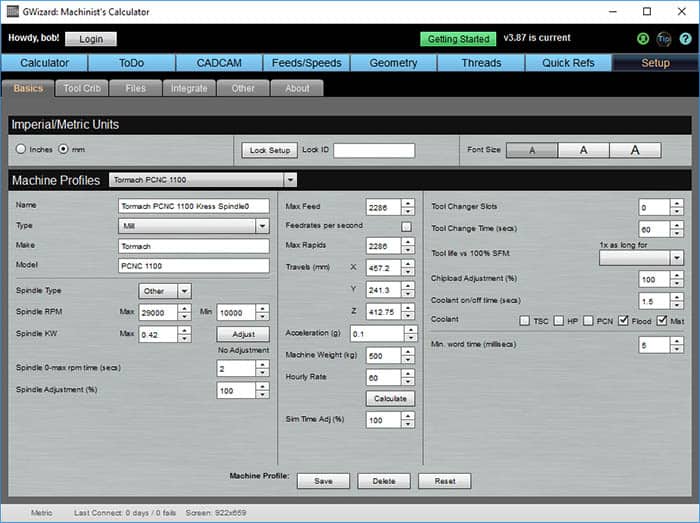

We’ll use our G-Wizard Feeds and Speeds Calculator to see the impact of having the extra rpms available. Here’s the additional profile I created for the Kress spindle:
Kress Spindle machine profile…
The steps required to create this profile were simple. After going to the Setup Tab:

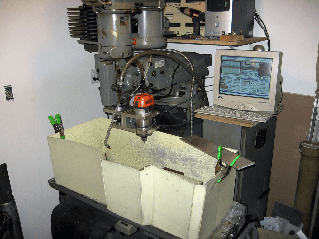

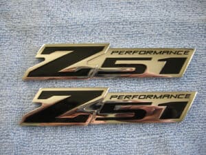

Typical attachment cadidates are small routers and Dremel-like electric spindles. We’ve written about the awesome custom car badges Austin Barnett made with a trim router attached to his Bridgeport CNC. He has since created a purpose-built machine with builtin high speed spindle, but he made a lot of parts with the add-on spindle.
Here are some typical custom car badges:
And here’s the Bridgeport with the add-on spindle:

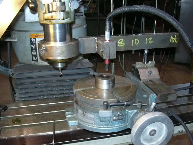

It’s pretty easy to fabricate a rig like this. Here are a bunch of examples for you to peruse should you wish to fabricate your own high speed spindle attachment:
Attaching an air grinder as a spindle for engraving…
This fellow made a router holder for his CNC knee mill that uses a #40 taper shell mill holder on one side and a shaft with a linear bearing on the other to support the router. The linear bearing is necessary because the router goes up and down in Z as the quill moves:
You can see it works pretty good!
I like the idea that you can quickly detach this rig from the mill by popping out the shell mill holder and undoing the clamp for the linear bearing. For my mill, I wouldn’t be using the quill, so the shaft would just clamp to the mill head directly for support.

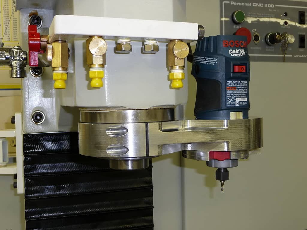

I hear good things about those Bosch Colts…

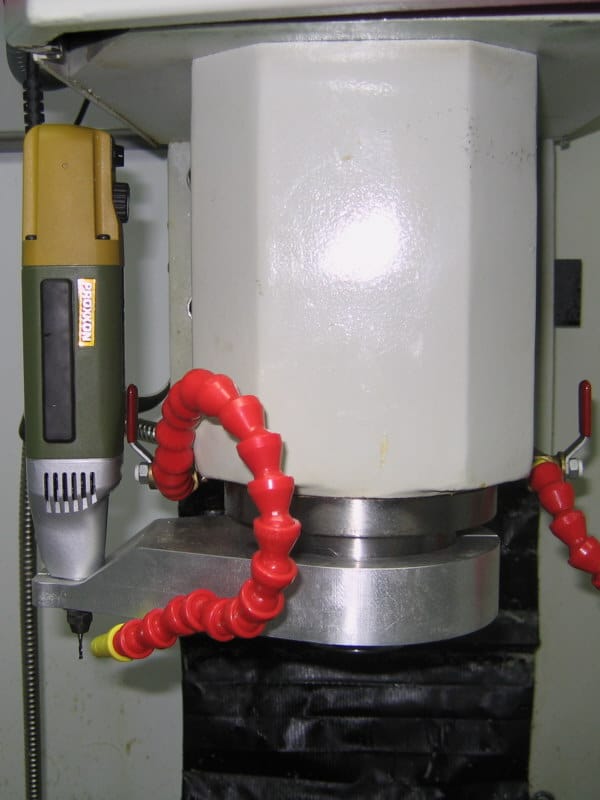

Proxon on a Tormach. I’d be worried about the air cooling holes that close to flood coolant!

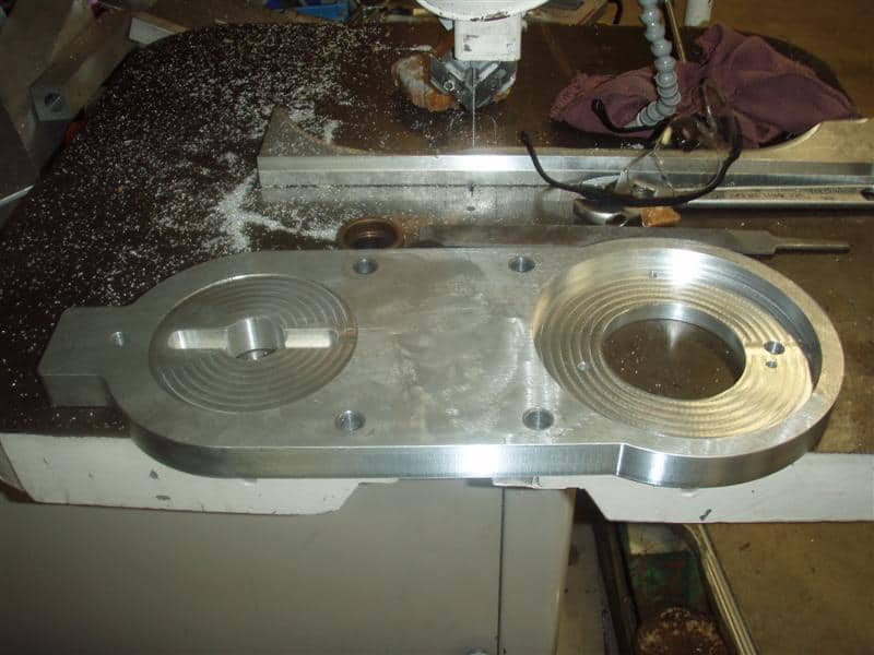

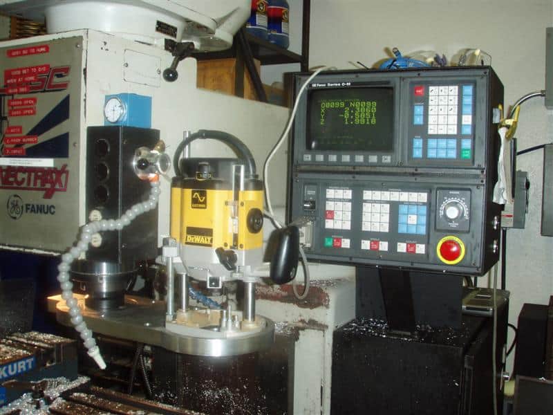

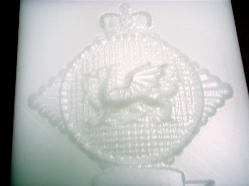

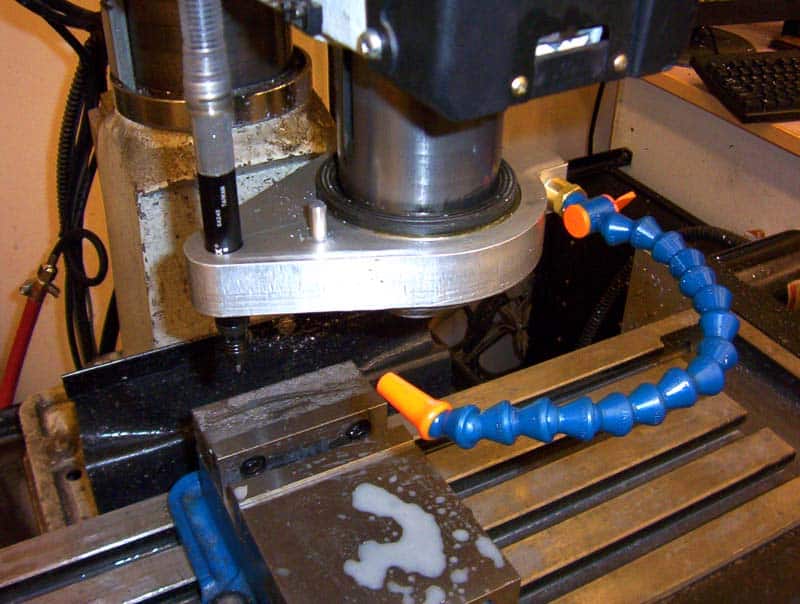

I recently got a very nice note and pictures from Kevin in Port Hardy, BC, Canada:
I recently came across your webpage, looked through it and became a big benefactor. I am a high school shop teacher without a lot of CNC milling machine background and have found the G-Wizard to be of great help. It is just what my students and myself need. Also I have benefited from ideas of projects you have collected, specifically the coolant ring and high speed spindle, two issues I have been trying to figure out since we do a lot of engraving and at 3000 RPM max on my Microkinetics mill is all I can do. Well I build a great coolant ring and high speed engraver this weekend, and that in addition to your software made the best engravings I have done to date (and such fine detail too). I have included some pictures of the ring just in case you would like to include them in your webpage for others to see and get ideas on. Oh P.S. I use Rhino and Rhinocam for all my work, I love it and it is nice to see a fellow Rhino user (unless I am mistaken but all your drawings look like rhino drawings.)
Thank you Kevin for your kind words and for sharing your project. I love the idea of a combined high speed engraving spindle mount and cooling ring in one. I know you and your students will do a lot more neat projects with this slick new add-on for your mill.
