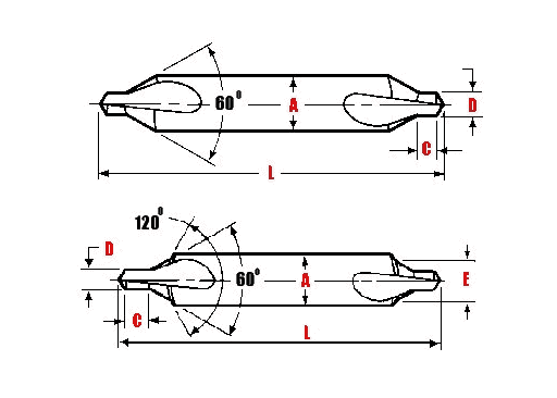

Center drills, commonly called center drills, as their name suggests, are primarily used to establish center holes—perfectly concentric holes along the axis of a rotating shaft, ensuring secure positioning between centers. These drills come in various types, including:
- Type A: Based on the DIN 333-A standard. Type A forms a hole with a single 60 degree chamfer.
- Type B: Based on the DIN 333-B standard. Type B forms a hole with 2 chamfers, a 60 degree and additionally a 120 degree at the start of the hole.
- Type C: The short, small-diameter portion of the cutting edge is followed by a 60° tapered portion, and then a blade is attached to the third step in the form of a counterbored edge. The counterbored portion serves to protect the center hole in the same way as the chamfer of Type B.
- Type R: Based on the DIN 333-R standard. Type R has a radius instead of a chamfer. This results in more holding accuracy because there is contact at only a single point. However, the load bearing capacity of the hole is less.
Each type is designed to create a center hole in workpieces.

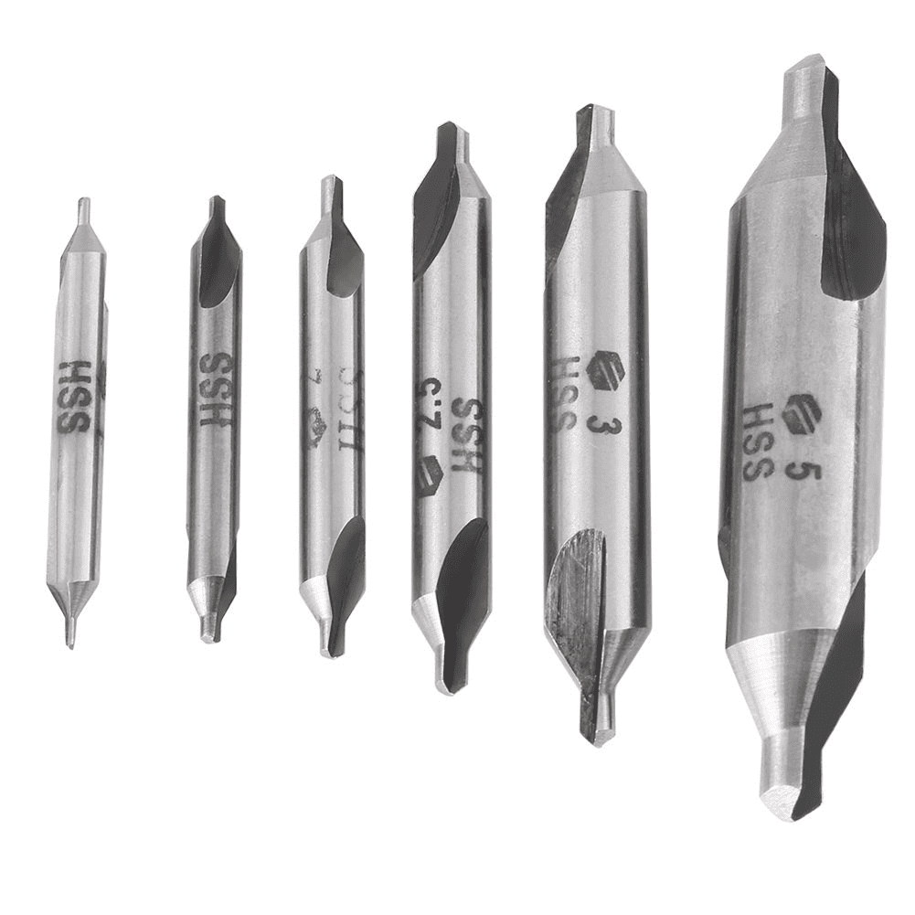

We will provide a comprehensive center drill chart to elucidate the relationship between various center drill sizes and their corresponding applications. Furthermore, a discussion on considering the included angle of a center drill is necessary because it dictates the size and shape of the hole it forms.
Center Drill Chart: Five Different Center Drill Sizes + Center Drill Set
To aid in the accurate selection of the appropriate drill size for specific applications, a center drill chart provides essential dimensions, including:
- Body diameter
- Drill diameter
- Drill length
- Overall length
These dimensions are provided in both inches and millimeters.
A typical center drill set includes the following sizes:
- 00
- 0
- 1
- 2
- 3
Our selection of drill bits is available in five different sizes, catering to a wide range of drilling requirements and offering flexibility and versatility in your drilling tasks.

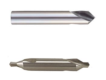

Center Drill vs Spot Drill
While center drills and spot drills may appear similar, they serve different purposes. Spotting drills are shorter and stiffer, reducing flex, and they typically have fewer flutes. On the other hand, center drills, are used in high-precision scenarios, particularly for creating holes at the center of a piece of stock for lathe turning.
Understanding these differences can help you make an informed choice based on the specific task at hand. For instance, if you require a conical tip for greater precision, a center drill would be the better option. On the other hand, a spot drill would be your go-to tool for precise and rigid hole spotting.

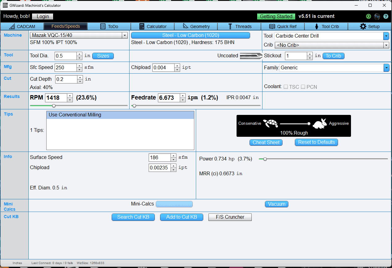

Center Drill Speeds and Feeds Calculator
A center drill speeds and feeds calculator can be of immense help in determining the optimal speed and feed rate for drilling with a center drill. This tool calculates the ideal speed and feed rate, considering various factors such as lubrication, workpiece stiffness, and drill depth. It’s an invaluable resource for ensuring your drilling operation is as efficient and effective as possible.
Our G-Wizard Feeds and Speeds Calculator calculates center drill feeds and speeds. It looks like this:

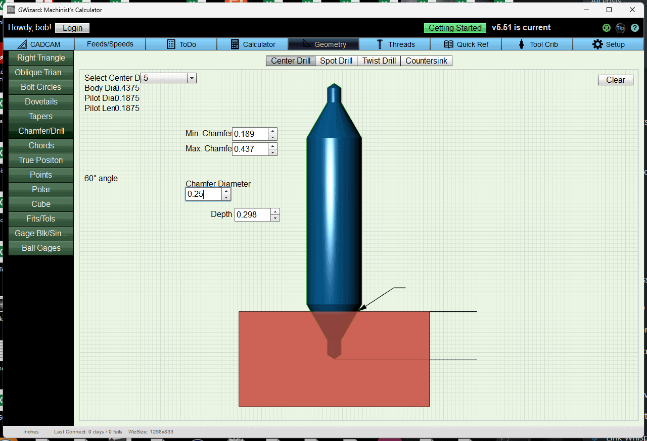

Center Drill Depth Calculator Free
Besides the speeds and feeds calculator, a center drill depth calculator can also be a valuable tool. This calculator aids in determining the depth of a center drill, considering variables like the hole’s diameter and the intended depth to deliver accurate depth measurement to the user.
A free center drill depth calculator can be found in our G-Wizard Feeds and Speeds Calculator. It looks like this:
