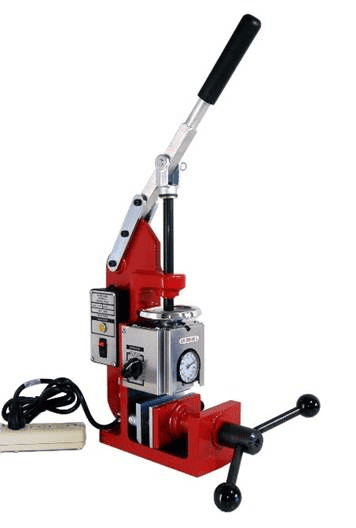

These machines are designed to make it easy to prototype injection molded parts, test molds, and even do small production runs. It sure looks a lot more robust than the typical benchtop injection molding machines I had been seeing:
Small Injection Molding Machine from Galomb…
A brand new machine like the Galomb is circa $1500-1800. Not cheap. These machines are somewhat specialized. Not clear where hobby injection molding originated, but there are definitely also articles out there about building these machines.
