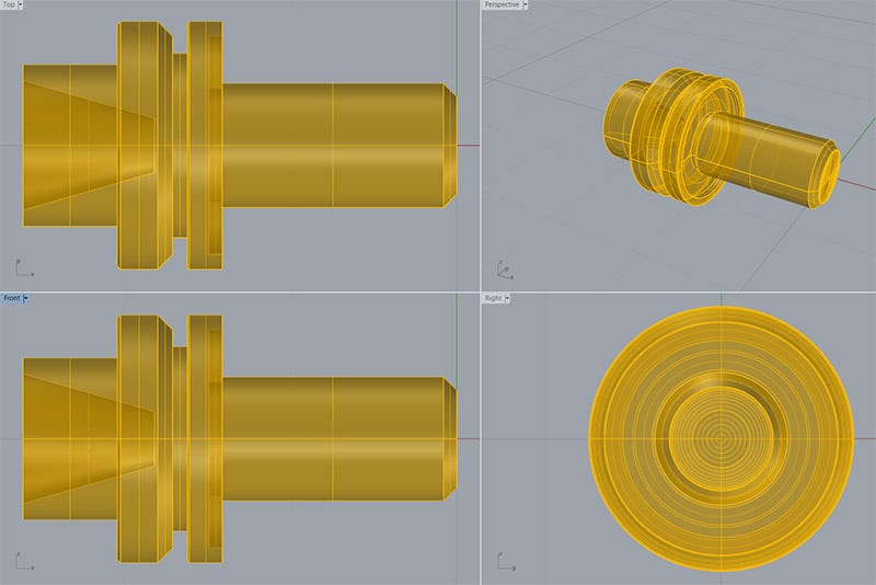

I choose to give it the following in IGES format:
ER20 Collet Chuck with TTS Shank…
It’s an ER20 Collet Chuck with a Tormach Tooling System (TTS) shank on it. Submitting it is dead simple:

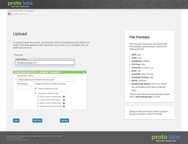

Submitting a CAD model for a quote is super easy…
In addition to your email, a name for the quote, and a CAD model, you need to give it a rough idea of the material in the next screen:

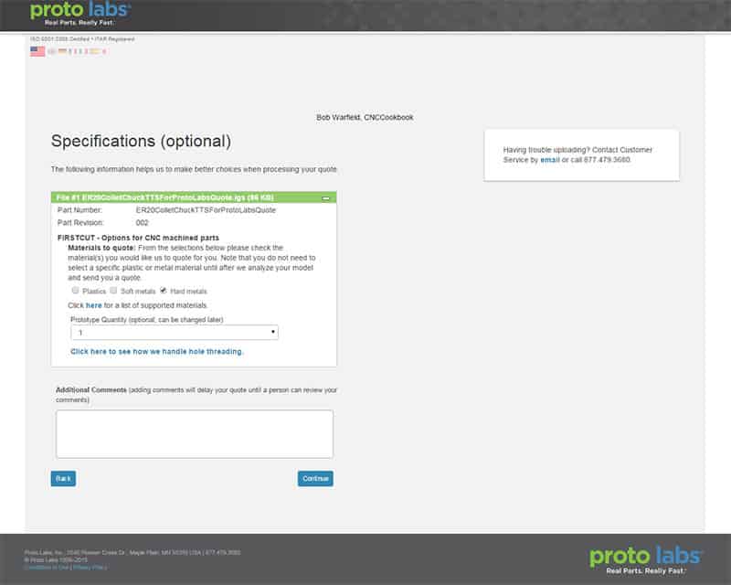

Tell it whether you want a Plastic, Soft, or Hard Material…
Oddly, even though they give you a link to their supported materials, you’re asked not to choose a material but to say whether you will be using a Plastic, Soft, or Hard Material. This resulted in some interesting behavior on the quote as we shall see. You also give a quantity desired.

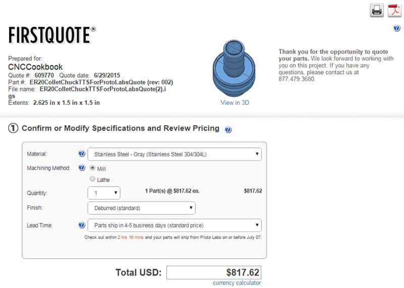

Within a very short period of time (mine was overnight on a weekend), you’ll get your initial quote back. Fasten your seatbelts, because the quote is likely to be high. After all, it’s a rush job for a prototype part. In my case, the collet chuck came back with a quote of $817. You can buy one new from Tormach for about $40. Obviously Tormach is in no danger of being upstaged. Here’s the initial response quote:
$817–These are the solid green unobtanium collet chucks…
Why so high?
As nearly as I can tell, this was due to two issues. First, the automated quoting system failed to identify the initial quote as a turning job–it was specified to be done on a milling machine. Second, when I picked a “Hard” material, it decided to quote stainless which is just about the most difficult material on their list. No doubt both choices contributed to a high initial quote. I was able to turn it back around to them quickly with a feedback that suggested a mild steel alloy and make it a turning job. Making those two changes got the part down to the $250’ish range. The final step was to bump quantity to 200 at which point I was down to a $119 quote. That’s a little more than twice what Tormach charges, but again, it’s a prototype one of a kind part being made on a rush basis for the first time.
I went through this process twice, the first time in last April. At that time, I was able to get a price of $73, so their prices have gone up a fair bit since then for some reason.
There were a couple of other flies in the ointment. For example, I did not specify threading the nose for the nut nor is the cost of a ER collet nut included in this price. Also, the final quote I got indicated they would not be able to do the undercut on the part at all. It’s fairly critical to this part and no good way to design around it, so that would be problematic for this application.
Still, there are a lot of parts out there that could be made quite happily by a service like this.

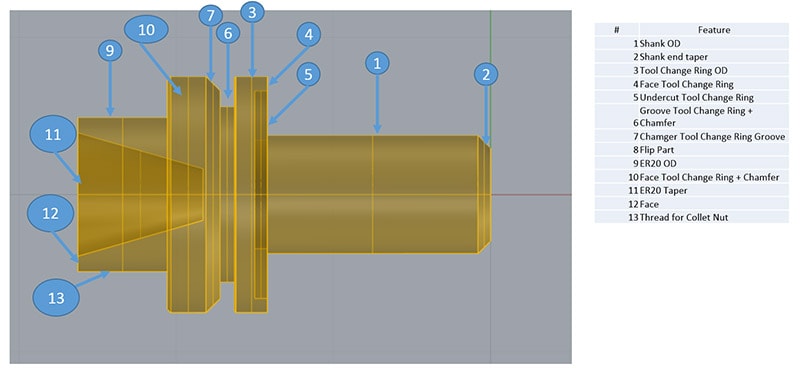

Our G-Wizard Calculator software has a module called CADCAM Estimator that can be used to put together quotes. I decided to go ahead and run through a quote for this part just to see how it would turn out. Before diving in, I made the following list of features for the part:
Features required for the TTS ER Collet Chuck…
It wasn’t hard to come up with a list of features, and for a simple part like this I normally would have just “winged it” and gone directly into CADCAM Estimator. In this case I wanted to make it clear what was going on for everyone reading. Once you have the list of features, it is pretty easy to use CADCAM Estimator to figure the expected time for each one, apply a machine hourly cost to those times, and get back a spreadsheet that’s all laid out for your quote. In addition to these times, you’d want to include some budget for material and for tooling–typically inserts for a lathe unless you needed a special tool. There’s even a special calculator to help you figure your machine’s hourly cost.
Feature-based estimation like this can be pretty acccurate, and with a tool like CADCAM Estimator, it can be pretty fast to do as well. I came out with a total of 3 minutes for the cycle (with all my fudge factors–want to make sure the quote isn’t too low) and I added 2 minutes to flip the part as well as to insert a slug in the chuck since I don’t have a bar feeder. At a standard of $60/hour machine rate, that’s going to be $5 of machining time. The slugs themselves I priced at $70 precut in quantity 10 from 8620 steel. Collet nuts are available for about $11 apiece.
Put that all together and we’re at about $23 each. There’d be more to it than that–setup costs and handling costs, not to mention CAM programming costs, for example. But let’s just say we’d come in under the $40 retail price even though my Tormach Slant Bed lathe is no speed demon. With a better lathe, we could likely see significant improvement in those figures. Perhaps Tormach pays closer to half retail and there is still margin left for the manufacturer in that. I think all told it probably took me half an hour to put the quote together. I don’t many quotes since I’m not a Job Shop. Someone who was doing a lot of quotes could no doubt get through the process much more quickly.
