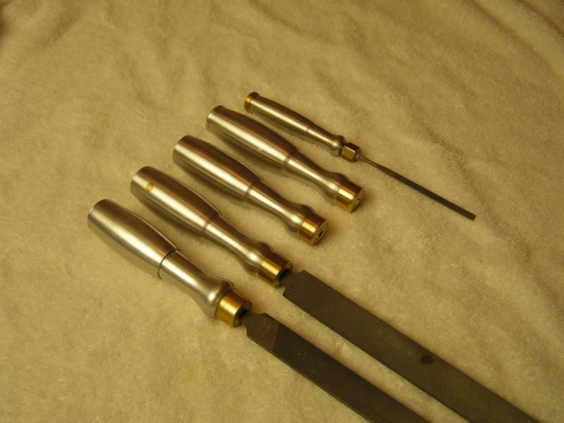

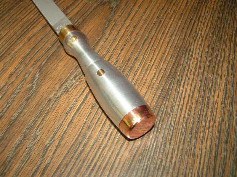

Turned File Handles and Rack
I came across these beautiful turned file handles on the Lathemaster Yahoo Group. A fellow named Marv Stovall did them. I thought they were really nice, and immediately wanted a set for myself. This will make a good project to try my CNC Lathe on when I get done converting it.
At the same time, I’d love some kind of rack to make it easy to organize the files. You need a collection of different styles, shapes, and sizes, and it’s hard to keep them all neat. According to Guy Lautard, he knows a guy that keeps his in pipes filled with heavy cutting oil. I have found that the heavy oil works as good or better than chalk to keep files from loading up, and it would surely protect them.
BTW, I like Nicholson files. For filing on the lathe, there’s nothing like their lathe pattern file either. makes for some really smooth work.
In the meanwhile, I bought a box of cheap wooden handles off eBay for my files, which are way better than nothing.

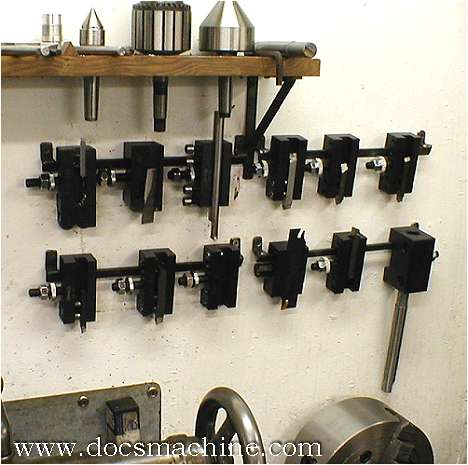

Lathe QCTP Toolholder Rack
So many great ideas I started an Idea Notebook page for this one. Here is a typical sample from the Lathe Tooling Organization page:

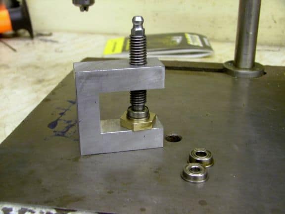

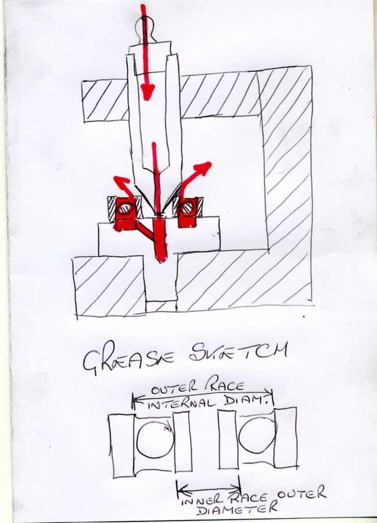

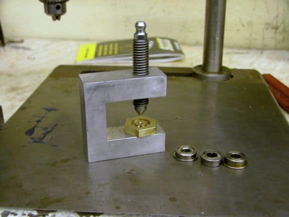

Bearing Greaser
Here’s a neat little bearing greaser Bogstandard showed over on the HMEM boards:
Zerk for grease gun is on top. Just use the hand gun, not a pneumatic or there is a danger of bending the shield!
I had an idea for some fixtures to help with preloading bearings. Perhaps a multi-purpose fixture could be created, I’ll have to ponder that.

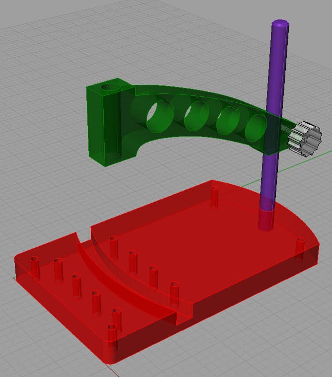

Bench Tapping Fixture
A bench tapping fixture…
This little gadget would be handy to have around for precision tapping a hole straight up and down and would not be hard to make. I’m saving it for an early CNC project once my machines are converted.

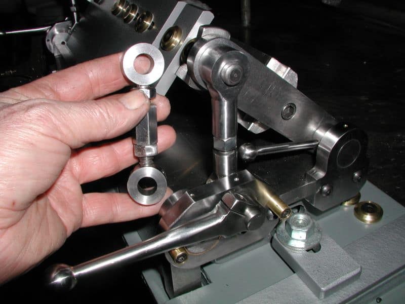

Sheet Metal Fabrication Tools
In fact, the whole sheet metal tool arsenal would be handy to have at hand. An English wheel, slip rolls, etc., etc.. I did come across some photos of this beautiful pan and box brake, which was built based on an article in “Projects in Metal.” I ordered their book so that I would have these plans available when I’m ready to jump in. The article in the book is excellent, and there are a number of other projects to covet there as well (like the precision cutter grinder and tilting table for milling). Order “Metalworking, Book Two, The Best of Projects in Metal.” This particular brake was designed by Glenn Wilson.
Very nice, eh?

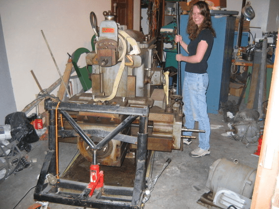

Machinery Dollys
An alternative to the Gantry Crane would be a machinery dolly system like this one. Slide the toe under and jack it up and you are ready to move. I could envision making it so that one could attach a platform between two dollies as well. Those pictured are very similar to a product called “Rol-A-Lift” that one could buy or rent if you didn’t want to invest in making a dolly system.
