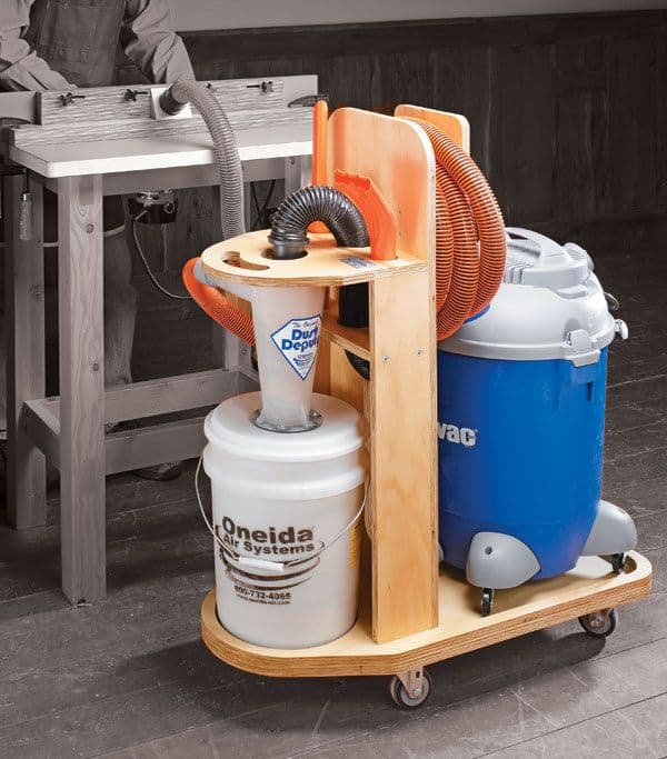

1. Upgrade your Shop Vac with a Cyclone Dust Separator
I’ve got a medium-sized Shop Vac that I use a lot. Shop Vacs are essential to keeping your shop tolerably clean, but like any other tool in the shop, they can be hot rodded to make them better. You could get a bigger Shop Vac, of course, and I will probably do so when this one wears out. You could make a cart for your Shop Vac that carries all of its accessories and makes it easy to coil up the hose so the whole thing is compact and easy to store out of the way. That’s another thing I should do. While I’m at it, I will likely turn that rack into a general purpose shop cleaning supplies cart, seems like the thing to do.
But probably the biggest upgrade I’d like to make to it is to add a Cyclone Dust Collector. These handy gadgets use centrifugal force to pull most of the dust out of the incoming stream. They really save on your Shop Vac’s filter. Mine needs replacing as I write this, and the oils common in machine shop refuse seem to be particularly hard on it. The very fine dust common in woodworking also clog your filters fast, particularly if you want to run the Shop Vac not just for after the job cleanup, but on an active machine for dust collection. A Cyclone Dust Separator can really help with this. They can also increase the capacity of your Shop Vac before you need to empty it.
There are quite a few aftermarket add-on Cyclone Collectors available that you can use in conjunction with a 5-gallon bucket or even a full-sized trash can plus your Shop Vac. Here’s a simple Cyclone from Instructables made from a bucket and PVC pipe fittings:
Simple Cyclone Collector made of PVC Fittings and Trash Cans…
Aftermarket Cyclone on a custom stand with ShopVac…
While the pipe fitting and bucket collectors work reasonably well, Cyclone Collectors made with the conical shape will produce better results as they’re much more efficient. Have you got a 3D printer yet? Printing a Cyclone Collector seems like an ideal project if your 3D Printer has a big enough work envelope.

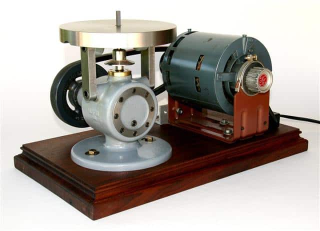

5. Build a Belt Grinder, Disc Sander, or Die Filer
The tools are so handy for so many different purposes: deburring, decorative rounding, and a wide variety of other tasks. They’re not very hard to build either. One of my best early machining projects many years ago was my disc sander which I still use constantly:
I made this disc sander years ago and still use it constantly…

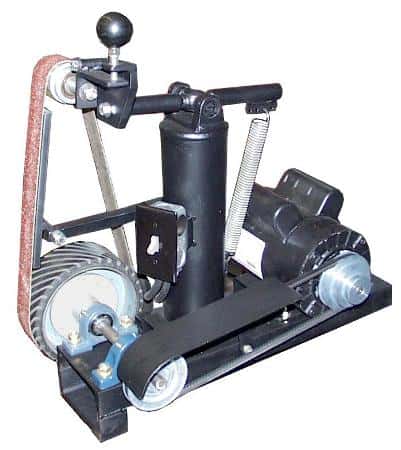

Belt Sanders can be even more useful:
Shopmade Belt Grinder uses a U-Joint as the arm pivot…
We’ve got a big page of Belt Grinder/Knife Grinder ideas for you to check out when designer your own grinder project.

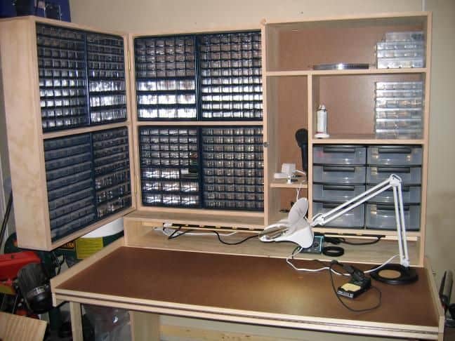

7. Organize Your Small Parts Storage
Small parts are a constant requirement if you do many projects. Left to their own devices, they quickly clutter a shop and you find you can never find the small part you need, whether for lack of organization or because it really isn’t there. So you head out to the hardware store or place an order with McMaster Carr and the vicious cycle continues.

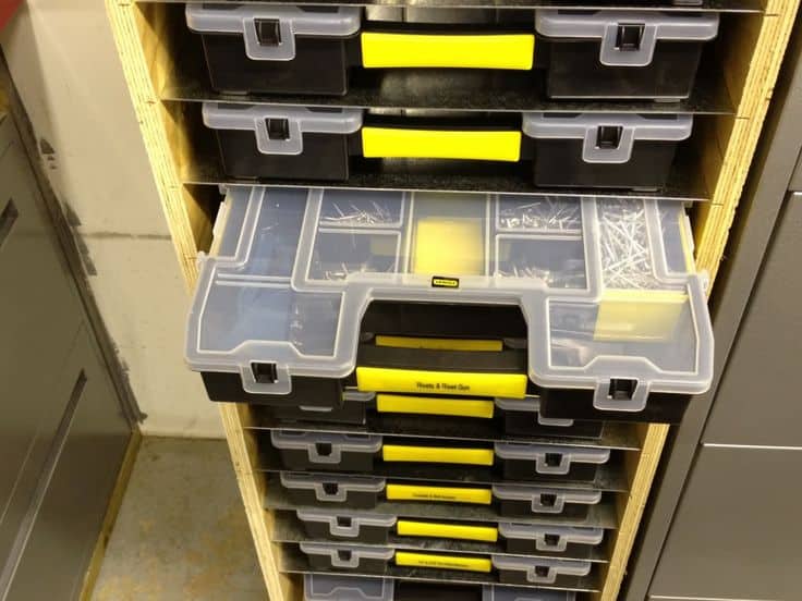

Adding some organization for small parts and keeping some inventory on hand for commonly used parts can really crank up your productivity in the home shop. I built this organizer for my shop:
Each plastic box holds a particular hardware size. I built this years ago and it’s become overrun. I need to start work on Parts Organizer 2.0!
I built it years ago and while it helped tremendously, it’s become overrun. I need to start work on Parts Organizer 2.0! But just to give an idea, when I go to the hardware store for let’s say fasteners, I never just buy what I need. I attempt to buy a full box, and if not, I’ll get 10 or 20. I’ll purchase multiple lengths and get matching washers and nuts. All of it goes into a compartmentalized plastic box with a clear label on the outside of what sized hardware we’re talking about. My family thought I was nuts one year when I asked them to give me these boxes already filled with hardware for Christmas, but they sure do make it easy to get on with projects. I even stick the correct taps and dies into the box with the fasteners so the whole kit is there when needed.
Here are some other ideas for parts organization:
Grab Kits are much like what I’ve done already…
Old office cabinets from Craigslist and other sources can be real finds…
These little drawer boxes are more commonly seen for electronic parts but they’ll work for anything that fits. This guy has achieved a lot of density here!
Lockers hide the clutter of it all very nicely…
Love this little parts sorter!
I love the little parts sorter–it’s a perfect project for a CNC Router. We all have those “Every Unknown Part” bins full of odd sizes of hardware. Use a sorter like this to at least break it down into hardware type. With a little ingenuity you might get some size sorting too.

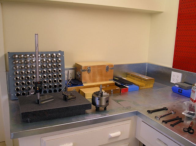

Measuring, Layout, and Metrology Area. Get your surface plate, height gauge, micrometers, and all the myriad other measuring tools all together in one clean place where it’s easy to work with them…
