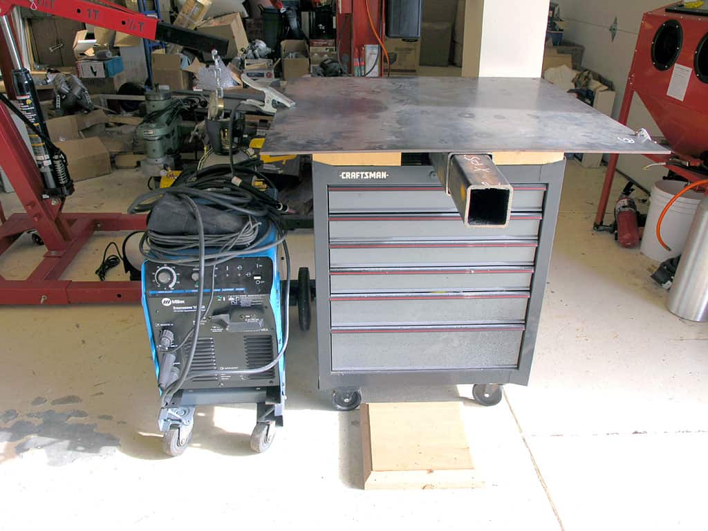

My Quick and Easy Welding Table
I recently took one of two car lifts out of my garage to make room for expansion of the machine shop sickness. The good news is that I picked up a large garage stall of floor space, and the bad news was that the lift had been a convenient work surface for many projects including welding. Part of this new push would involved getting things organized and fabricating some custom work surfaces. That meant I needed a convenient place to weld, hence this approach. I'm of the opinion that you can never have too much work surface nor too many drawers, so the idea of building a welding table on top of a rolling tool chest really appealed to me. Here is a brief photo essay of the project:
Black metal table with four white blocks holding metal brackets in a garage or workshop.

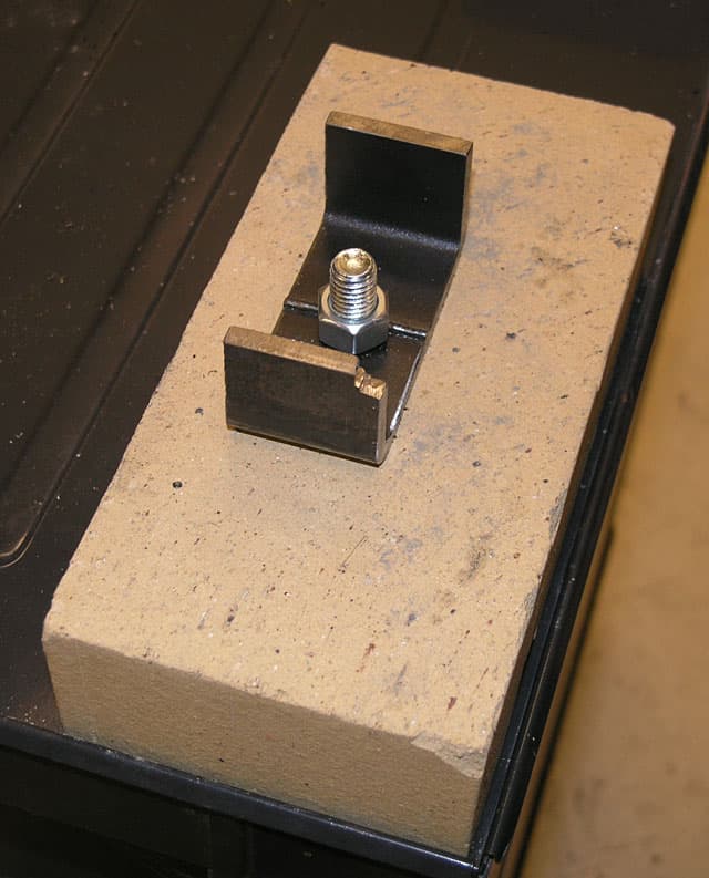

The idea was to use firebricks to insulate the tool cabinet from heat together with an additional stand-off bracket to increase the air gap...
Tan-colored material block with metal bracket, square nut, and bolt.
The stand-offs were made from pieces of 4×4 square tubing that I sectioned on my chop saw...

Gray Craftsman rolling cart with red stripes and welding machine nearby.
Here is the finished table. The square tubing sticking out the front was a last-minute idea. I'm going to mount my vise on there so it is removable as needed. I have a hunch that I'll come up with other things to insert in that "holster" that will be helpful. We'll see!
