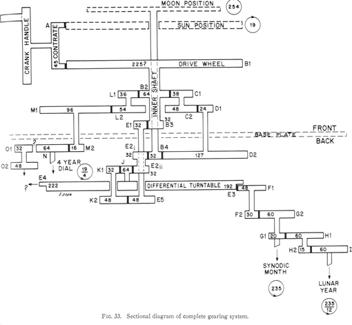

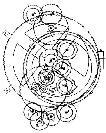

I’ve always had a great interest in Astronomy, and I read with great interest recent articles about the Antikythera Mechanism, which was apparently an ancient orrery or simulator of motions of the heavenly bodies. The machine, which was constructed circa 80 BC, could represent the motions of most heavenly bodies known in its time using a clockwork consisting of 37 gears.

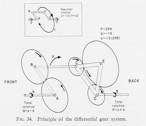

Differential Gear Mechanism Was Way Ahead of Its Time.
The front dial would show the progression of the Sun and Moon through the Zodiac according to the ancient Egyptian calendar. The lower back dial gives the Metonic cycle, the Synodic cycle, and the Lunar
year of 12 Synodic months. Later researchers determined that the device could show the motion of the visible planets through the Zodiac, as well as predict Solar and Lunar eclipses using the Saros scale. It also displayed
the Calippic scale.

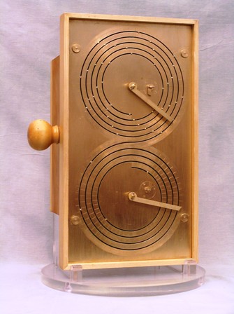

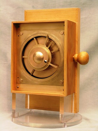

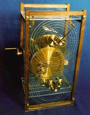

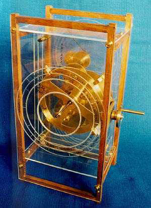

Front and Back of a Reconstructed Model of the Antykthera Mechanism
This Model May Be Closer. Note the Spiral Tracks on the Back Dials
The Sun and Moon Dials Tracking Against the Zodiac…

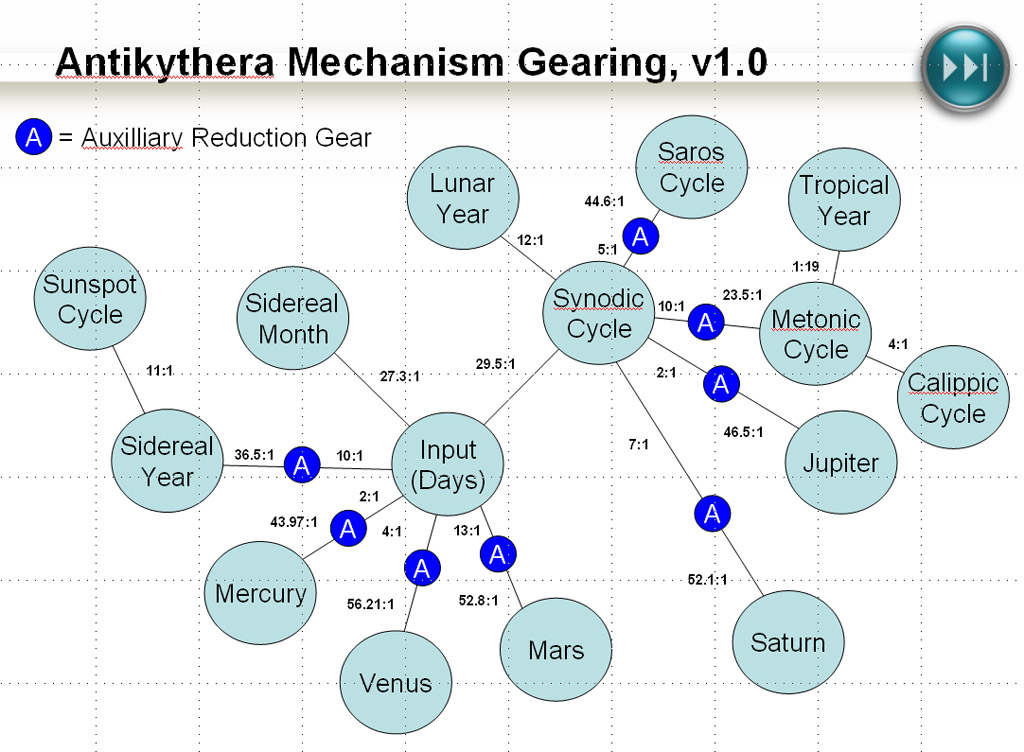

A Geartrain Schematic:
Here is a schematic that I use to represent the inter-relationship between the various gears or wheels in the Mechanism I’m designing. I think it simplifies the understanding of how it would work:
Gear Mechanism Schematic…
Each of the light blue circles represents a major gear and dial in the system. In other words, it is both a gear that others may engage as well as an output of some kind. For example, the Synodic Cycle is a dial showing the lunar phases as well as an important gear that is driven through a 29.5:1 ratio from the input shaft and goes on to drive7 subsequent major gear/dials and 4 auxilliary reduction gears.
The dark blue circles represent what I’m calling auxilliary reduction gears. In my more detailed design, I estimated
the diameter of each gear in the system given a 20 tooth per inch gear pitch. Based on that estimate, I added auxilliary gearing to keep the largest gears from exceeding much more than 8″ in diameter. The largest gear/dial is that governing the motion of Mars through the Zodiac at 8.4″. The smallest gear/dials (doesn’t count the aux reduction gears) have 10 teeth each and correspond to the Input in days and the Tropical Year.

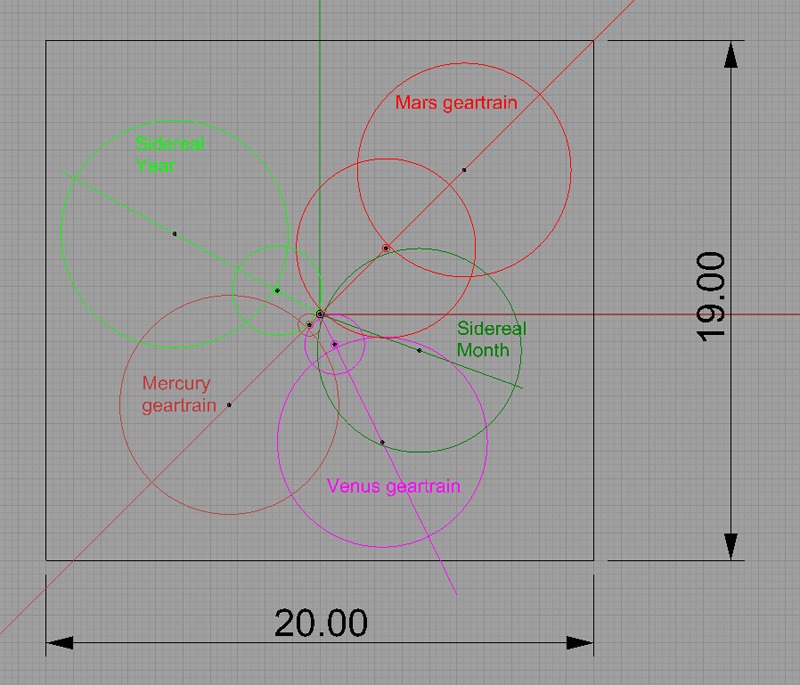

Rhino Geartrain Layout
Next, I tried laying out some of the gears using Rhino 3D, just to get an idea of how things might fit together. This was my
first attempt at a layout for the gears needed to drive the inner planets. It’s everything in the gear schematic above that’s tied directly to the input wheel except for the synodic wheel.
A first attempt at gear layout in Rhino. The exact center is the Input Gear, and the various other gear trains are color coded. I’m thinking I’ll want something a little more compact!

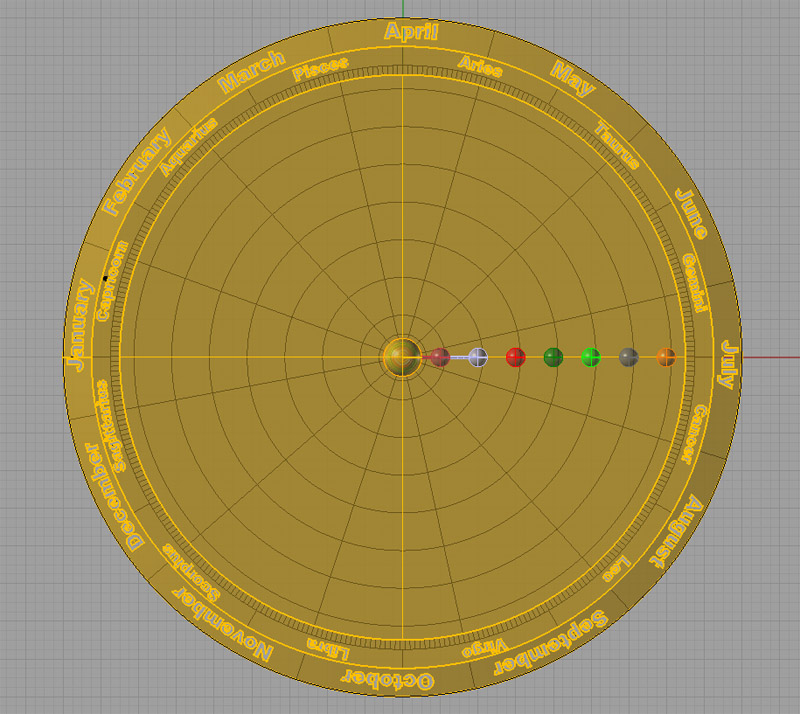

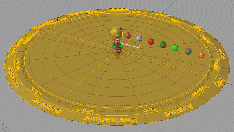

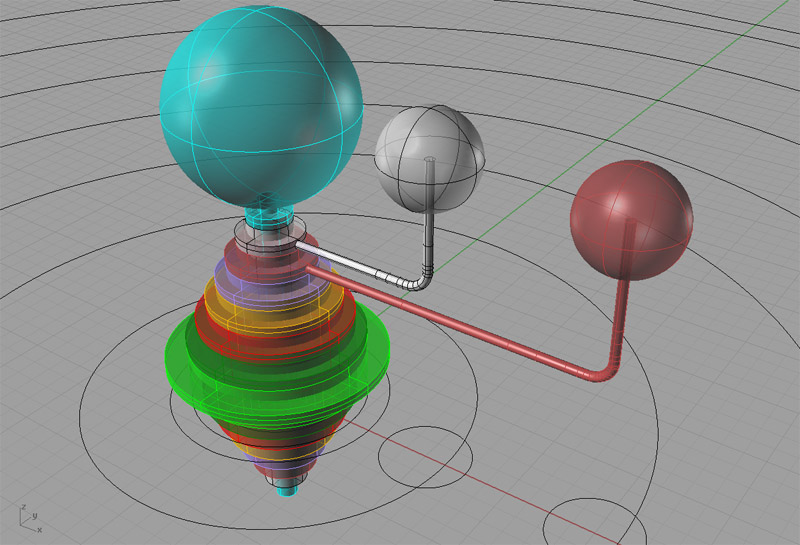

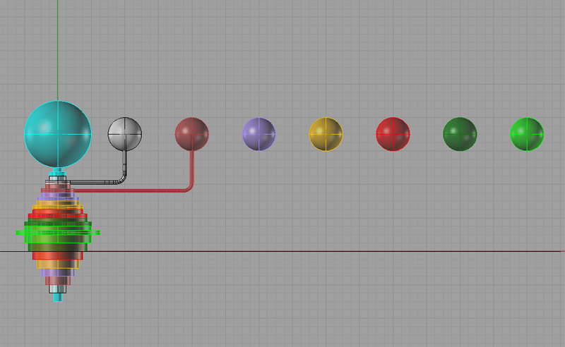

I also sketched out an orrery hub mechanism in Rhino to see how that might work:
Orrery front view. That’s Earth in the center, Moon, Mercury, Venus, Sun, Mars, Jupiter, and Saturn. That is the order the Ptolemaic universe worked in…
A closer perspective view of the Orrery mechanism…
This orrery piece presents some real design issues. The drawing shows the heavenly bodies in the Ptolemaic perspective, with Earth at the center and all the other bodies revolving around it. As you recall, refuting this view is one of the things that put Gallileo (and others) in hot water with the Church.
The Ptolemaic perspective is more in keeping with the feel I’d like to have for the clock, which is a lot more astrological
and Ancient-looking than a more modern orrery. Frankly, I’d like to do both at some point and have them sit next to one another. The problem is that the planets display retrograde motion. In other words, at certain times of the year, their apparent motion against the stars reverses for a time and the planet “backs up”. This happens as planets lap each other around the sun. In the Ancient view, this was accounted for by having the planets travel in little sub-circles called “epicycles” as they made their circuit around the big circle. You can imagine that this would make for complex motion to simulate with clockwork!
The easier way out is to have the orrery display the modern view, with Sun at center and planets circling around
it. To determine where a planet appears in the Zodiac would require sighting along the line from the Earth to the planet and extending that line into the zodiac. Not quite so elegant, although physically more realistic and also easier to construct a clockwork for.
A rendering of the baseplate for the orrery…
