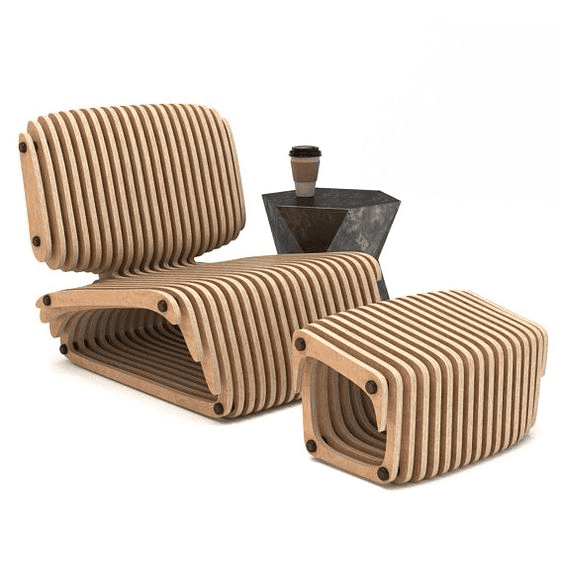

The possibilities for a CNC Chair are endless.  This design is from a type of CNC Furniture called "Parametric", and the design is called the "Levigo Chair".

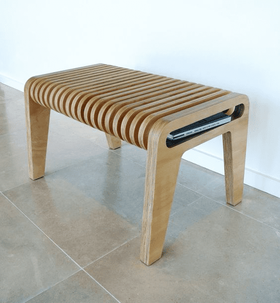

So I started in brainstorming and soon had built quite a Pinterest scrapbook of CNC Chair and CNC Furniture ideas.  Here are a few of my favorite images, not necessarily all CNC Chairs:
Compact wooden bench with curved slats made from light-colored wood.
A table to go with the parametric Levigo chair at top of the article...

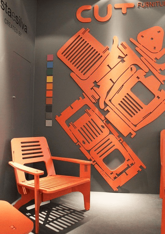

Cut furniture display with assembly stages and orange title "CUT FURNITURE".
A flat pack chair...

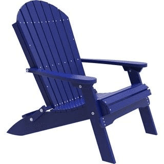

Given the way our house is decorated, I was drawn to more modern designs.  Sure, I could build  couple of Adirondack Chairs like this:
Dark blue Adirondack chair on a plain background made of wood or plastic.

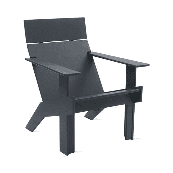

But this chair fits better and performs the same function:
A black outdoor Adirondack chair with armrests, wide seat, and high back, designed for comfort and relaxation.
I liked the Parametric style chairs, but eventually decided I wanted something simpler.  Something more "fit tab A into slot B".  Something more like the Flat Pack-style designs.

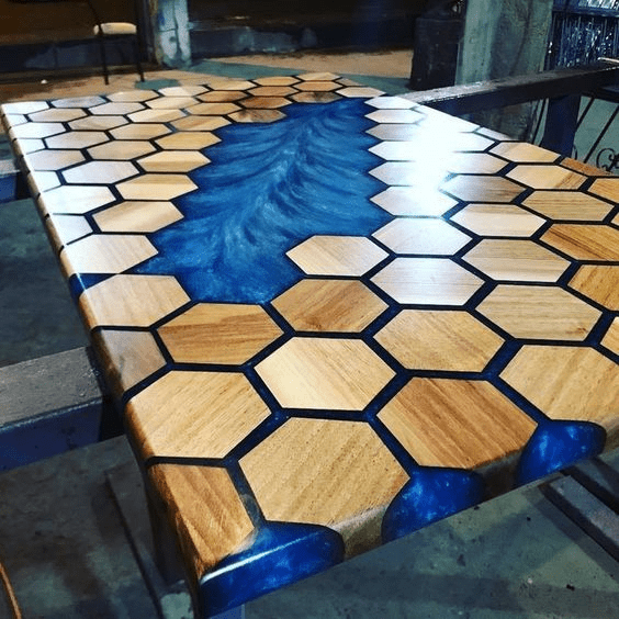

Epoxy Resin added to the Design Mix
In the process of doing all this brainstorming, I also came across some gorgeous furniture work involving epoxy resin, usually on tables like this:
Unique hexagonal wood table with blue resin inlays.
Originally, I was thinking of building something like that for the seat surface of the chair, or perhaps for the table that would go between my two chairs.

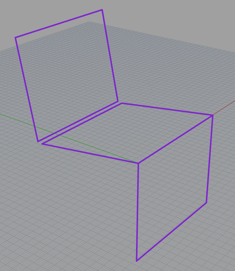

I wanted my chairs to be functional and comfortable.  I have a nice spot picked out for them, and I was planning on spending a little quality time in them.  So, to ensure the proper functionality, I did a little research on chair ergonomics.
It turns out there have been studies done of what the ideal dimensions are for various furniture type based on the average measurements of people's bodies.
My first design task was to lay out these ergonomics as an idealized chair:
Purple chair with green floor reference line.
As you can see, the ergonomics specifies the angle of the seat and back, their sizes, and how far off the ground they should be.  There's also information on how high the arm rests should be, but I didn't include that in this drawing.
BTW, I happen to be using Rhino3D for this design exercise.  It's one of my available CAD choices, the others being Solidworks and Fusion 360.  I tend to prefer Rhino3D when I don't know exactly what my shape is going to be and especially when the shape may involve lots of organic curves.  I will often choose the others for mechanical parts.

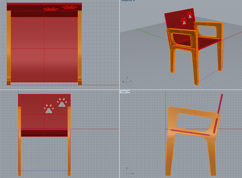

By this time I had a lot of visual ideas from my scrapbook.  I had an ergonomic schematic that spelled out the rough proportions for the chair.  And I knew I wanted a sort of flat pack-style construction.

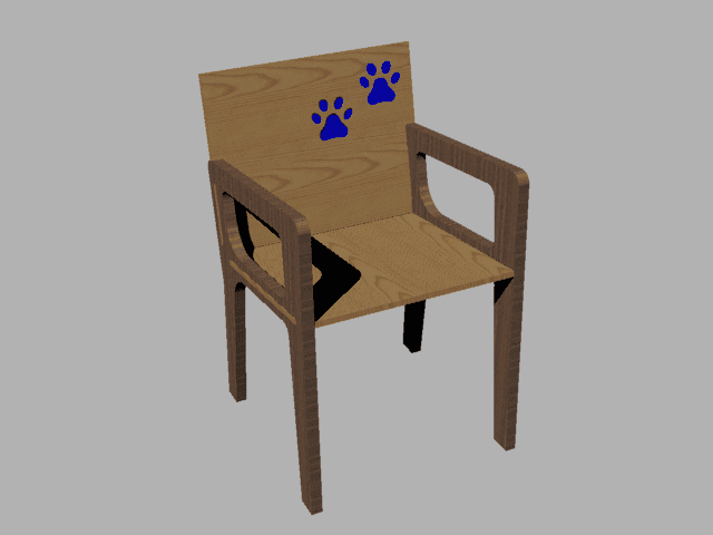

It was time to start creating the chair.  The seat and back were simple.  I just oriented square pieces in the correct positions as prescribed by the ergonomics.  Most of the design motif for the chair would be in the form of the arms and legs, which I planned to cut from a single piece for each side.
Here's what I came up with:
3D modeling program screenshot with chair design in wood-like rectangles and red/orange color scheme.
I'm pretty happy with how the chair came out.  But what was my thought process?
Whenever I'm working on a design, I tend to look for patterns.  Then I try to see which patterns fit and work well together.  This design has a few patterns.
Try collecting a bunch of photos of designs you like and then looking for the patterns that you like.  Having these patterns helps guide your design decisions in useful ways.
What's With the Paw Prints?
Almost done.  Still thinking about epoxy resin.  Still wanting to give back something organic to this modern but somewhat sterile design.  I had mentioned the thought of running a blue epoxy resin "river" across the seat.  Making the seat of hexagons embedded in resin was another possibility.  But I wanted to keep it simple.
I was collecting signs for the sign making portion of the project one day, and it suddenly came to me:  Dogs!
My wife and I love dogs.  There are 3 that live with us.  Some of the signs were definitely going to be about dogs, and naturally, some would involve paw prints.  The light bulb lit and suddenly I knew the answer was to put some epoxy resin paw prints in the seat back of the chair.
Here's a rendering with the epoxy resin paw prints in place:
A 3D wooden chair with two blue paw prints on the backrest.
