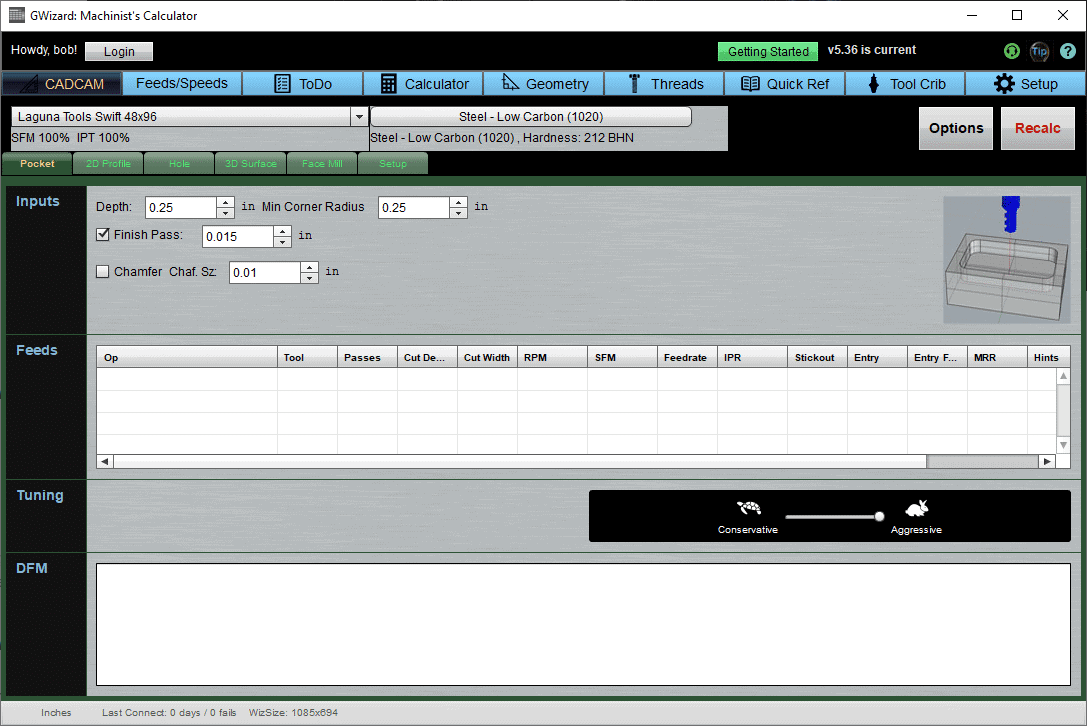

How does G-Wizard Optimize Cut Depth and Cut Width?
First, let’s define what’s meant by “optimizing” Cut Depth and Cut Width. It’s pretty simple:
Optimize Cut Depth and Cut Width by choosing values that will maximize Material Removal Rate without compromising Tool Life.
Pretty easy to understand, right? And doesn’t it make sense you want the best Material Removal Rate (MRR) you can get? That will make the job run faster which translates almost 100% into profit or at least time saved if it isn’t a paying job.
While it’s easy to understand, it’s surprisingly hard to do.
Performing that Optimization is the job of the CADCAM Wizards.
You can see them in action in this video:
It’s pretty cool technology, it’s totally unique–nobody else is doing this. And it uses state of the art Artificial Intelligence algorithms to solve the problem.

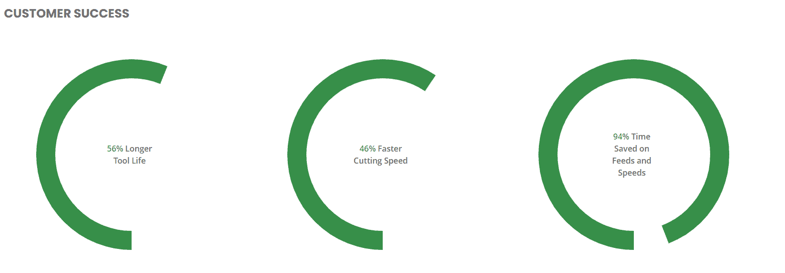

How much of a difference can it make to optimize Cut Depth and Cut Width?
But that’s all just coolness, how well does it really work in practice?
I asked customers in a survey, and here’s how much they said G-Wizard was helping them:
Honestly, I was embarrassed to show those numbers when I first got them because I didn’t think they were believable. But I have talked to so many customers since who confirm the results I just have to share them.
That’s how much difference you can get by optimizing the two variables that matter the most and playing offense rather than just defense. If you’d like to know more about G-Wizard, check it out:
