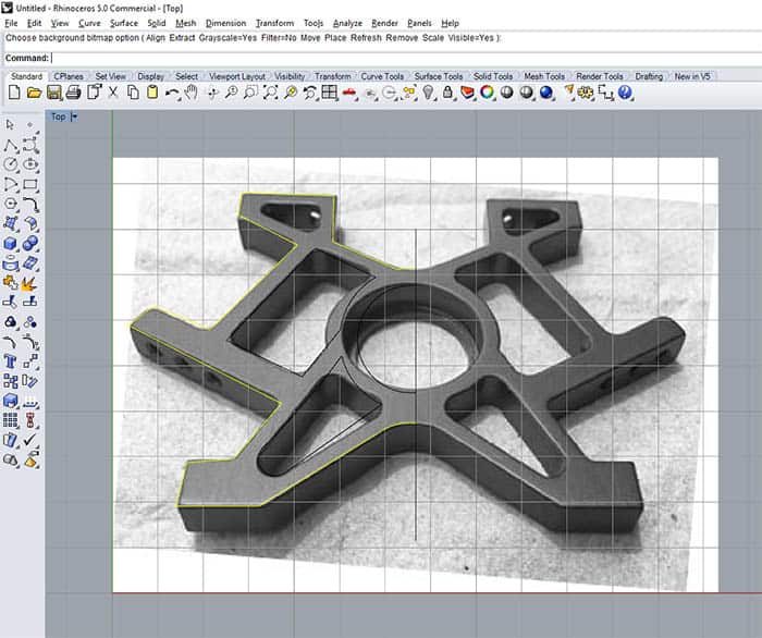

I took the image above and imported it into Photoshop.  As you can see, I rotated it so it's at least square along the X and Y axes.  It remains titled, and I could've corrected for that too in Photoshop, but I decided it wasn't going to affect the quote all that much.
I then set it up as a background image I could trace in Rhino3D.  Most CAD software will let you trace an image.
Rhinoceros 3D software user interface screenshot, featuring tools and menus on a light grey background.

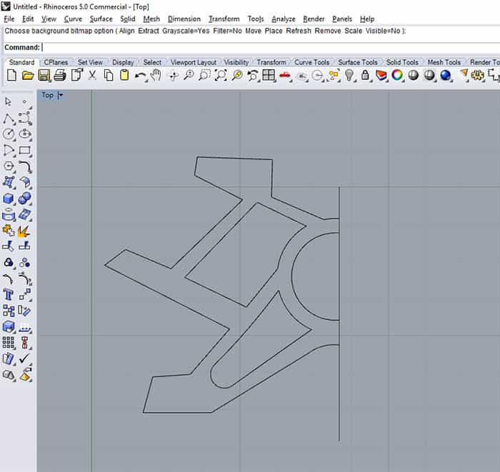

It's hard to see the tracing, but I traced the left half of the part.  Before tracing, I scaled the part so that the thickness corresponded to the 1/4" given by the original poster.
Here's what the trace looks like:
Rhinoceros 5.0 computer software interface screenshot
Again, not exactly correct, but close enough.  All we're looking to do is latch onto the perimeter lengths of the various shapes in the CAD software.

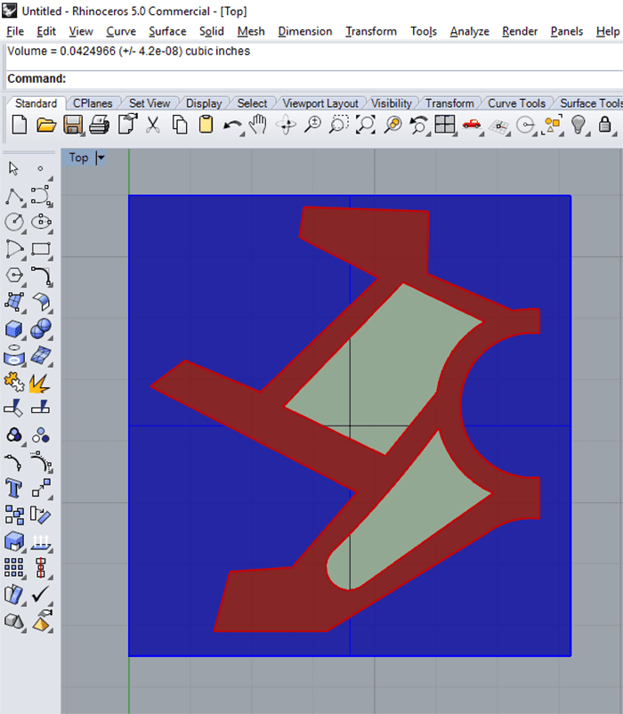

Last CAD step is to estimate the volumes of material to be removed.  To do this, I stuck a bounding box around the design, extruded each area as a 3D shape, and then let the CAD tell me the volume of each.

  2. Outside perimeter.  Length is 12.434".  Volume to remove is 0.55 cu inches.
  3. 2 internal pockets.  One pocket has a perimeter of 2.226 and the other is 1.951".  Volumes are 0.068 and 0.042 cu inches.

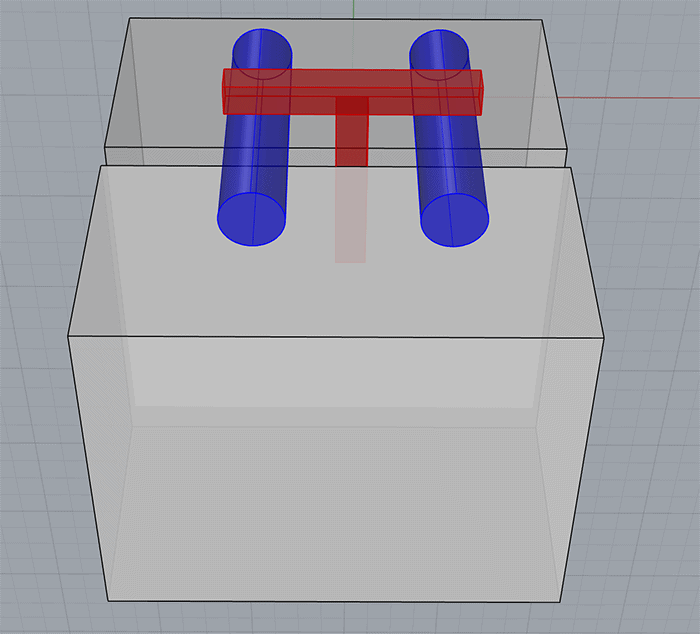

Next we need to decide how to hold the workpiece as we drill the holes that are at an angle.  This is where we need a little ingenuity to avoid having to make a fancy set of soft jaws or use a 4th axis to position the holes at the right angle.
I want to stand up a pair of 2-4-6 blocks in a milling vise.  The part will be clamped between them, perhaps with some coke can aluminum to avoid marring the part.
I'll use a couple of precision pins on either side side of the "vertical" column that's under the holes to support the part so it is level and the holes will be drilled at the right angle.  Think of a "T" supported on two pins like this:
Blue cylinders with red T-structure and gray cube.
The precision pins could be dowel pins, two identical size twist drills, or whatever you have that is precise enough.

The main trick with this setup is to have enough beef below the pins and below the vise jaws to clamp while the 2-4-6 blocks remain flat.  It's worth experimenting a bit with the one good "sample" part if you can to get it right.
Bingo, that'll get us our holes quickly and easily (and therefore cheaply).
