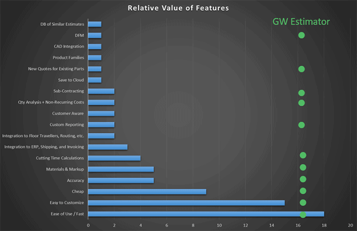

What do Users Value in Today’s Estimating Solutions?
If you were going to sit down to improve an existing or write a new cost estimating solution, you’d want to be aware of what users value most and make sure you captured as much value for them as possible.
What we can see is that the ideal solution must be:
  • Easy to Use and Fast.  CAMing out a job is accurate.  But it takes too much work to be viewed as Fast or Easy.
  • Cheap.  Some of the software out there for Job Quoting is thousands of dollars.  Shops are clearly saying it’s not worth that much to them.  Given how skeptical they are about the accuracy and speed of even the fairly expensive solutions they responded about in the survey, shops may also lack confidence that spending a lot more money buys much.
  • Materials and Markup:  Cost Estimation needs to be aware of materials and allow markup.
  • Cutting Time Calculations:  Cost Estimation must provide realistic estimation of Cutting Time
  • Integration:  Cost Estimation is not an island, they’d like a solution to tie back to ERP, Shipping, Travellers, Invoicing, and More.
  • Cusom Reporting is important
  • Customer Aware:  This basically means not treating all customers equally.  They want the quoting software to take the customer into account.
  • Quantity Analysis and Non-Recurring Costs:  What’s the optimum lot size for my profitability?  Is it worth building a custom fixture for this job?  Any Shop makes a lot of these kinds of decisions and they want help from their Costing Solution.
  • Sub-Contracting and working with multiple Vendors is a fact of life.  The Costing Solution has to be able to deal with it.

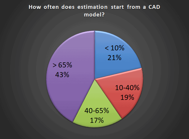

How Many Job Costing Efforts Start with a CAD Model from the Customer?
This was another surprising result.  For at least 40% of the respondents, the cost must be estimated without any CAD Model.  They work from back of napkin drawings and descriptions by the customer of what needs to be made.

Let’s go back through the charts and see how G-Wizard Estimator stacks up to what you’ve told us in the survey is necessary.  We’ll start with what you’ve said you value most in your current solution:
I’ve put down a green bubble everywhere I think G-Wizard Estimator has the capability wired:
