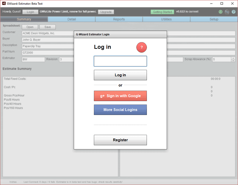

To login, you’ll need to use the Login Bar.
Login Bar
The Login Bar at the top has a bunch of handy features and buttons you’ll refer to from time to time:
– Login Area: You can press the login button to logoff or change your login.

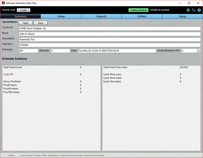

Summary Applet
The Summary Applet is where you enter basic information such as who the quote is for.  There’s also a summary that rolls up all the costing information for the quote.

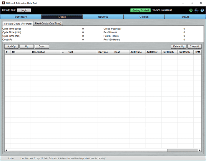

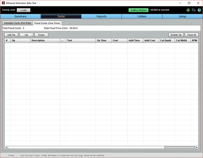

Detail Applet
The Detail Applet is where you’ll spend most of your time when creating the quote.  It has two sub-views:
  • Variable Costs:  These are per-part costs.
  • Fixed Costs:  These are one-time costs, such as the cost to build a fixture for the job.
Here’s what the Variable Cost view looks like:
And here is the Fixed Cost view:
They’re pretty similar.  The big list at the bottom of both views is where we enter Operations using the “Add Op” button.

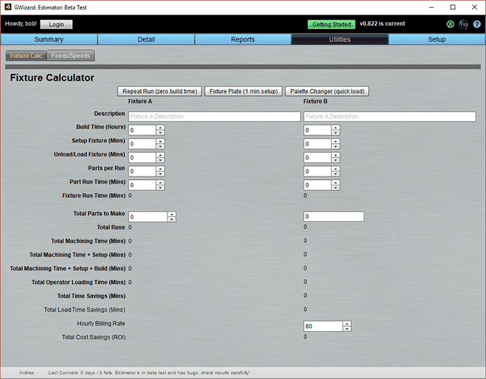

The Utilities Applet includes a Fixture Calculator as well as our Feeds and Speeds Calculator:
For more on how to use the Fixture Calculator, check out our article on it.
The purpose of the Fixture Calculator is to help you decide whether building a custom fixture for your Job will make it more profitable or not.

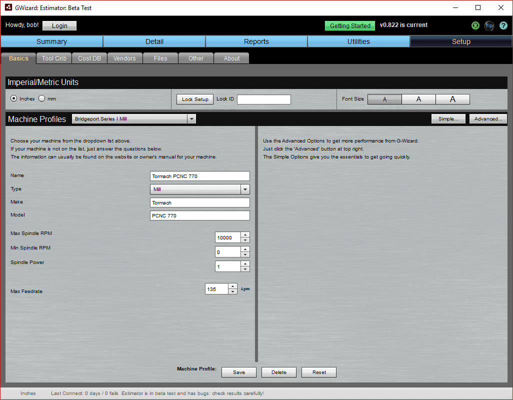

Basics & Tool Crib
On the Basics Tab, you can define new machine profiles that match the different machines in your shop.  You can also calculate an hourly cost for each machine.  The Tool Crib lets you setup predefined tools and is shared with GW Calculator and GW Editor.
To learn how to create Machine Profiles or manage the Tool Crib, visit the documentation for G-Wizard Calculator.  It works exactly the same because Estimator uses Calculator’s Feeds and Speeds Engine internally.

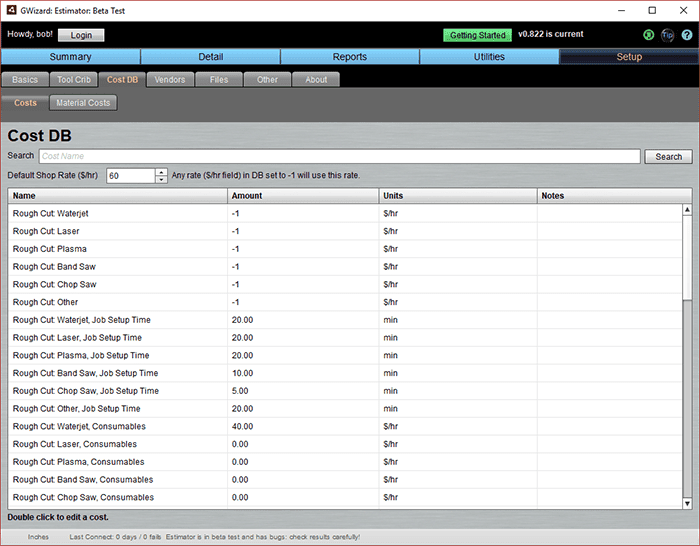

Cost DB
Cost DB gives you a central place to set up cost assumptions to be used across all quotes your shop makes.  They can be overridden on an individual quote as needed, but this is where you set up the defaults.  The Cost DB looks like this:
Think of each row in the Cost DB as a pre-defined variable that has a name, a value (Amount), some sort of Units its measured in, and Notes you can add for explanation.  Many of the values are hourly costs, and these are handled in a special way.  You can enter an overall Default Shop Rate at the top.  If an hourly cost variable (you can tell a variable is hourly cost because the units are $/hr) has a value of -1, the Default Shop Rate is used instead.
In addition to hourly costs, you find a lot of variables tell you how much time a particular op will take.  For example, to rough cut parts on a Waterjet takes a 20 minute Job Setup Time.
To change any of these variables, click on the row and then double click on the value to edit it.

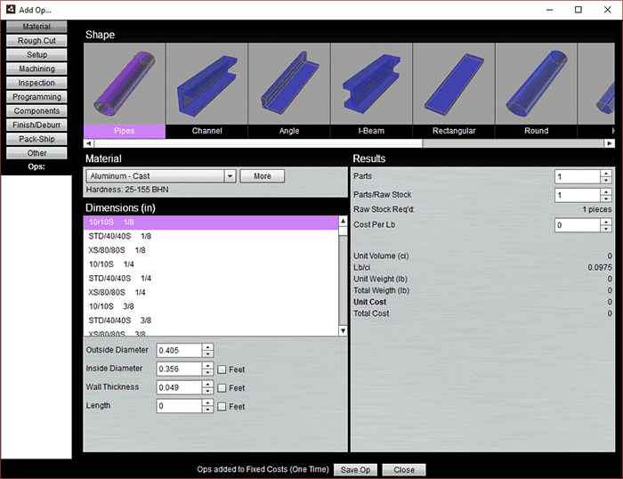

Material Op (Coming Soon)
The Material Op is for purchasing raw materials to make your parts out of.  It’s based on G-Wizard’s Weights and Volumes Calculator.  Just select a Material, a Shape, and either choose a standard dimension or enter custom dimensions.
Next, enter how many total parts you’re making and how many parts per piece of raw stock.  From that, it will figure how many pieces of Raw Stock are required.  The last input is the Cost per Lb for that Raw Stock.  G-Wizard will look up the default for that from the Cost DB or you can override it with the variable here.

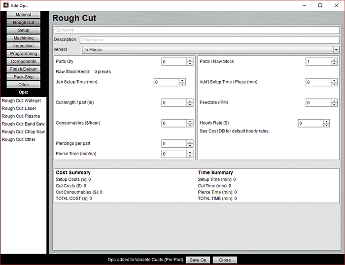

Rough Cut Op
Having purchased raw material, you may need to further cut it up with a Rough Cut Op.  A variety of processes are available using the Sub-Op menu in the lower left.  For example, you could choose to Waterjet, Laser, or Bandsaw cut your pieces.
From there, the calculator will arrive at time and cost for the Op.  Press “Save Op” when you have it ready to enter.

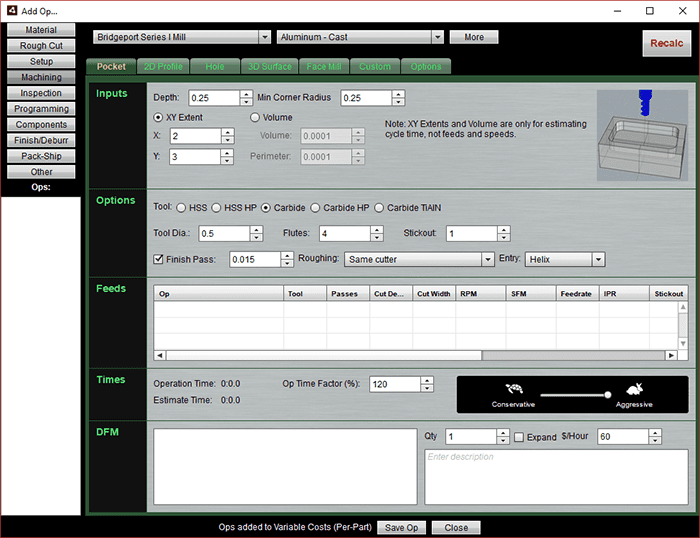

Machining Op
The Machining Op is based on G-Wizard Calculator’s CADCAM Wizards:
Each Machining Op corresponds to a typical feature you might program in your CAM software.  This op uses the G-Wizard Calculator Feeds & Speeds Engine to generate Real World estimates for what the op will take.  For more information, see G-Wizard Calculator’s CADCAM Wizard documentation.  Or check out our Video University series on CADCAM Wizards.

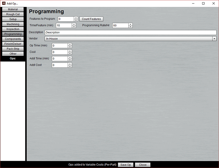

Programming Op
Every feature has to be programmed in CAM before you get g-code to run on your machine.  The Programming Op accounts for this cost:
Programming is typically something you’d put into your Fixed Costs since it is usually done once for the whole job.  You can have the Programming Op count the features in the quote (i.e. the Machining Ops) and calculate the Programming Cost based on a fixed programming time per feature.

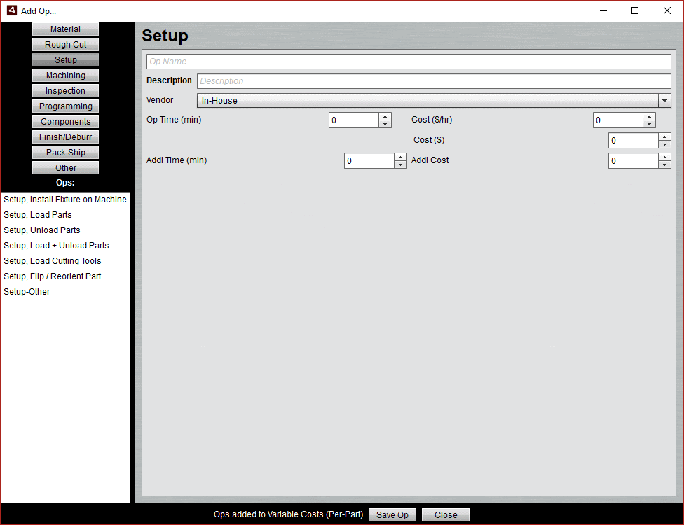

The List Ops:  Inspection, Setup, Components, Finish/Deburr, Pack-Ship, and Other
The “List Ops” all look pretty similar.  For example, here is the Setup Op:
What differs is the list of Sub-Ops on the lower left.
