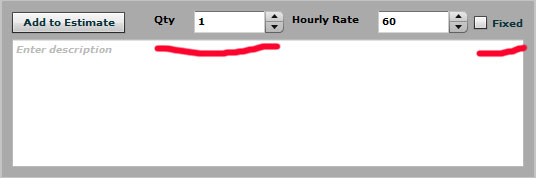

A number of people suggested we add the ability to set a Quantity for each feature being added to the Estimate.  For example, a single part may have a number of holes, all with the same dimensions.  So there's a new Quantity field right where you add CADCAM Wizard features to the Estimate:
Machining cost estimator online form with quantity, rate, and fixed options.
You can specify Quantity of a feature to add to the Estimate as well as whether it goes under the Variable or Fixed Costs...

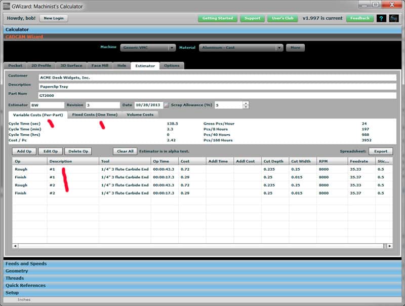

In addition, there is a checkbox so you can designate whether the cost is added to the Fixed Costs (up front or one-time costs) or the Variable Costs (per-part costs).  When you use the Quantity field, multiple Op entries are created and they're numbered (#1 and #2 in the screen shot) in the Description field so you can keep up with which is which, if needed.

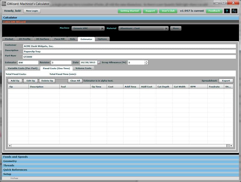

The Variable Cost page is focused on the costs that are allocated per part and won't change if quantities change.  Here is the Fixed Cost page:
GWizard: Machinist's Calculator Estimator tool screenshot showing fixed cost breakdown.
The Fixed Cost page.  Cost types are selected via the tabs right above the cost schedule...
Fixed Costs are one-time costs such as:
In all likelihood the Fixed Cost schedule will change quite a bit as functionality is added to allow estimation of different volumes.  Fixed costs are a big part of volume estimating.  For example, at low volumes, it might be sufficient just to stick the parts in your vise(s) on your mill table.  For higher volumes, it might make more sense to build a custom fixture that allows a lot more parts to be machined on the table.
For now, we tally up the statistics and costs separately for the Volume and Fixed Cost pages and we also export them separately to spreadsheets.

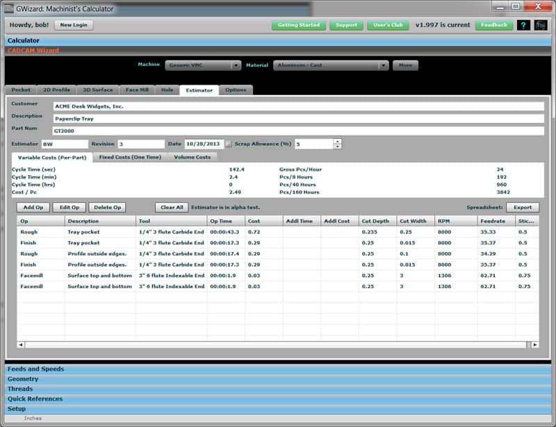

Here's what the features look like for our tray:
A calculator interface for machining and metal fabrication, with various tabs and a data table.
Features required to manufacture the tray.  "Features" are just the machining operations...
It's a simple part, so we have roughing and finishing passes needed for a pocket, profiling the outside edge, and face milling the top and bottom.  That's gets all sides machined and away we go.

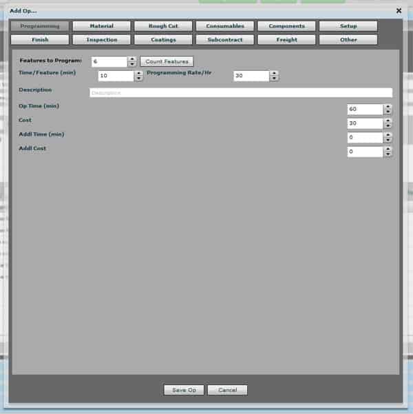

What will it cost us to do the CAM programming for this part?
To find out, click the "Add Op" button and select the "Programming" op:
Grey window with navigation bar and table with multiple columns.
Programming Op is used to estimate the cost of CAM and G-code programming...
Note:  Before clicking "Add Op", be sure to select the Fixed Cost tab as we will need the programming just once and not for each part.  Of course if you need to encounter for some kind of personalization like engraving each part, perhaps there would be some programming component on the Variable Costs.
The Programming Op works by counting up the features generated by the CADCAM Wizards.  It knows, for example, that there are 6 features needed to make the tray.  It then applies an amount of time to program each feature (default 10 minutes) and an hourly rate for programming ($30/hour by default).  That all gets turned into the cost of programming and added to whichever (Variable or Fixed) schedule you have currently selected.

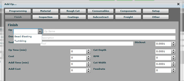

Components Op, Finish Op, and Coating Op
We added a bunch of new ops, or at least made them functional:
Components Op:  Covers purchase of additional components that will be incorporated into the part such as Fasteners or Bearings.
Finish Op:  For operations like running the part through your blast cabinet (bead blasting) or vibratory polisher (tumbling).
Coating Op:  Covers the cost of things like powder coat and anodizing.
These simple ops all work the same way.  There's a combo box at top left that lets  you select different options to go into the Op field.  It's just there to save you typing and keep things consistent.  You're free to add further comment to the op, but we encourage you to choose one of the canned options and put the further information into the Description field.  Here's the Finish Op, for example:
CAM software interface with Finish Operation tab on CNCCookbook.com
Finishing op...
