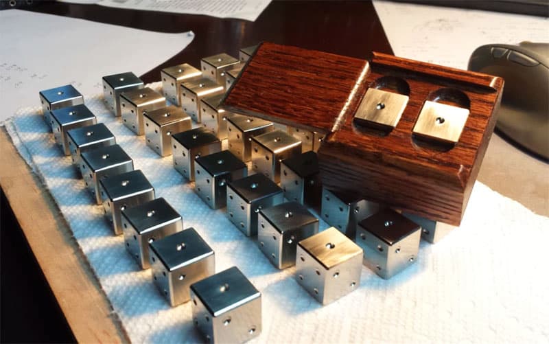

I love to hear from our customers what they’ve been doing with G-Wizard. What’s particularly cool is when they’ve taken the time to really document an interesting project. Here is James Dressman’s precision machined Titanium Dice. A lot of work went into these, but the end result is a finely crafted set of dice:
The Titanium Dice and their presentation box…

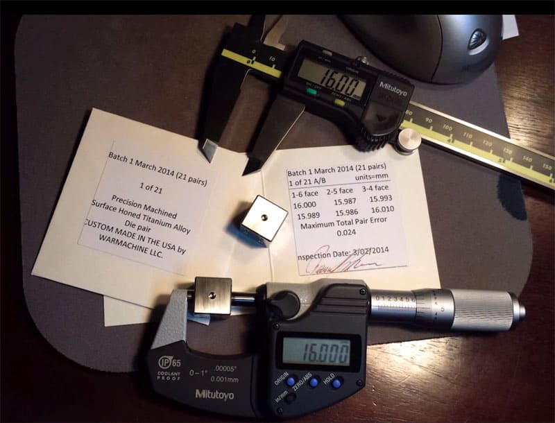

You gotta love the idea of including an inspection sheet: that’s a true machinist’s touch!

This was a nice little run of dice. I always learn more from producing a batch than from one-offs. With a batch you’ve got a chance to refine the operations as you learn. With a one-off it’s mostly about adapting later steps to what goes on in the earlier steps. James says in the videos that these dice were an awful lot of work and he wasn’t sure he’d be doing too many more. I’m sure there’s a number of ways he could make his process more efficient. Off the top of my head I’d be looking to get his local waterjet house to cut the blanks, looking at fixtures, and using strictly the facemill rather than the combination of rougher and facemill to finish the faces. A fourth axis would allow 3 sides of the dice to be finished at a time too. Lastly, a big vibratory polisher might save a fair amount of that finish polishing. I’m thinking that since these dice are small and fairly time consuming, a vise pallet fixture might work well. In other words, build a fixture plate that holds a grid of dice and fits into the vise jaws.
