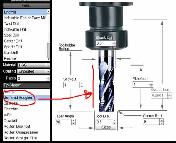

5. Use a Serrated Rougher
Some machinists think serrated or “corncob” roughers are Old School.  That may be, but they really do work.  The serrations result in smaller chips that are more easily cleared away.  These cutters produce less machining chatter and they even lower cutting forces.  G-Wizard Calculator is one of the few out there that actually figures all that into Feeds and Speeds for these useful cutters, so take advantage of it when roughing.

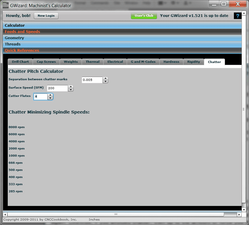

10. Sidestep Chatter
Many experts say that chatter is the ultimate limiting factor for machining productivity.  With enough power applied, you will eventually exceed rigidity limits of machine, tool, or workpiece, and chatter will set in.  But while chatter may be inevitable if you push hard enough, there’s no reason you can’t delay the onset of chatter as much as possible to maximize your productivity.
Chatter is a resonant phenomenon.  Our special in-depth article on Chatter (part of our Free Feeds and Speeds Course) gives full details, but chatter is a resonance phenomenon based on 4 crucial variables:
  • Machine:  Every machine is different, even machines of the same model will differ due to differences of bearing pre-load and the like.
  • Toolholder Model:  The model of toolholder matters, but two of the same model will behave the same.
  • Tool Model:  The model of the cutter matters, but two cutters of the same model will behave the same.
  • Stickout:  The distance from tool tip to where it enters the toolholder matters.
If we make all four variables match, we will get chatter at the same spindle rpms if we apply enough cutting force.  The spindle rpms that are susceptible to chatter are Chatter Danger Zones.  If you can avoid those rpms, you’ll be avoiding the resonant frequency of the chatter and you can push harder without having to deal with chatter.
You can identify these Danger Zones in two ways.  First, you can purchase equipment that can directly measure them and provide you with what’s called a Stability Lobe Diagram. The equipment isn’t cheap, but it works, and the Stability Lobe Diagram pinpoints your Chatter Danger Zones.
If you don’t have the special measuring equipment, you can also rely on record-keeping.  As mentioned, only four variables have to match to make chatter predictable.  If you record the value of the variables together with spindle rpms every time you experience chatter, you will get the Danger Zones mapped out for your shop and its tooling and machines.  You can then avoid these danger zones in future jobs.
G-Wizard provides a feature called the Cut Knowledge Base that’s ideal for tracking these things.  If you can see the chatter marks in the product well enough to measure how far apart they are, G-Wizard also includes a “Chatter Calculator” that will tell you safe spindle zones:
If you can measure the distance between chatter marks, G-Wizard will tell you the safe spindle speeds that minimize the chatter…

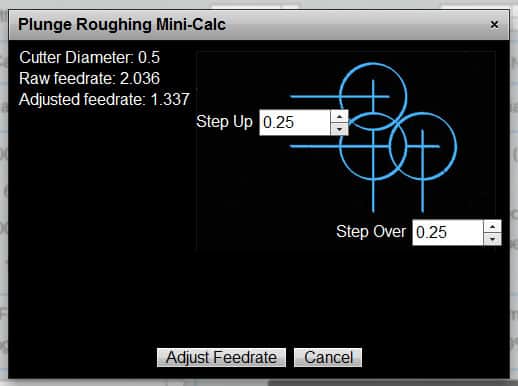

11. Investigate Plunge Milling
Sometimes rigidity is a problem, for example when the depth to tool diameter ratio is too large in a deep pocket with small corner radii.  Or, perhaps on a smaller CNC machine rigidity is at a premium.  Most CNC machines are most rigid along the spindle axis.  If you can concentrate the cutting forces so they are axial rather than radial, you can rely on that increased rigidity.  That’s the premise for Plunge Milling where all the cutting action happens as a series of plunge cuts in the wall of the material.
G-Wizard includes Feeds and Speeds for Plunge Milling:
PlungeRoughing
Give G-Wizard the spacing of the plunges and it will adjust feedrate for Plunge Roughing…

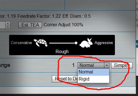

15. Tell G-Wizard Your Machine Or Setup is Solid
OK, here’s the last performance-enhancing feature we’ll talk about here.  Right below the Tortoise-Hare Slide is an innocent little dropdown that normally just sits there and says “Normal”.  You probably haven’t paid much attention to it:
RIGID
Tell G-Wizard when you have an extra-rigid setup…
Open it up, flip it over to “Rigid” and you’ll get a bonus.  It’s there so you can tell G-Wizard whenever you have an extra-rigid setup that deserves a little more grunt in the cut.
