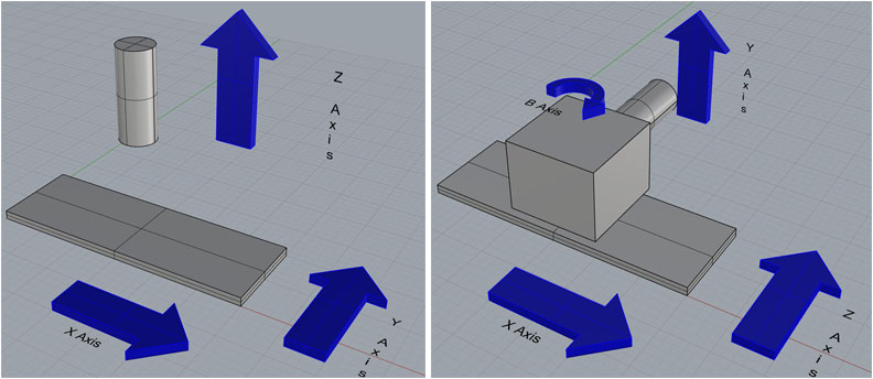

I hear this question a lot: why would I choose a Horizontal Machining Center? Or, when is an HMC better than a VMC, I hardly ever see HMC’s?
Like so many things, the answer to these questions is complex.
Let’s start by taking a look at how each one is laid out. In the diagram above, we can see the axis layout for a VMC (Vertical Machining Center or Vertical Mill) on the left, and the layout for an HMC (you guessed it: Horizontal Machining Center) on the right.
The thin gray rectangular block is the machine table, the cylinder is the machine’s spindle, and in the case of the HMC, the gray cube is the tombstone.
“What’s a tombstone?” you ask. It’s a big block of cast iron that sits atop an axis for rotation. You attach the workpieces to the tombstone sides. You can think of this whole thing as a 4th Axis for an HMC, and they have a lot in common with a VMC’s 4th Axis, but they’re much more pervasive. One sees a lot of VMC’s with no 4th axis currently in use, but most HMC’s use them constantly.
