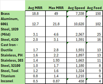

Various metals comparison table: brass, aluminum, steel, cast iron, ductile, stainless steel, and titanium.
As you can see, this low productivity is due to Inconel's very restrictive feeds and speeds.

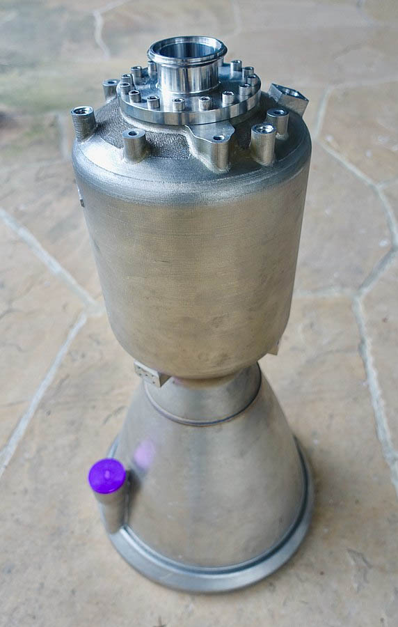

Inconel rocket engine
3d printed inconel rocket engine...

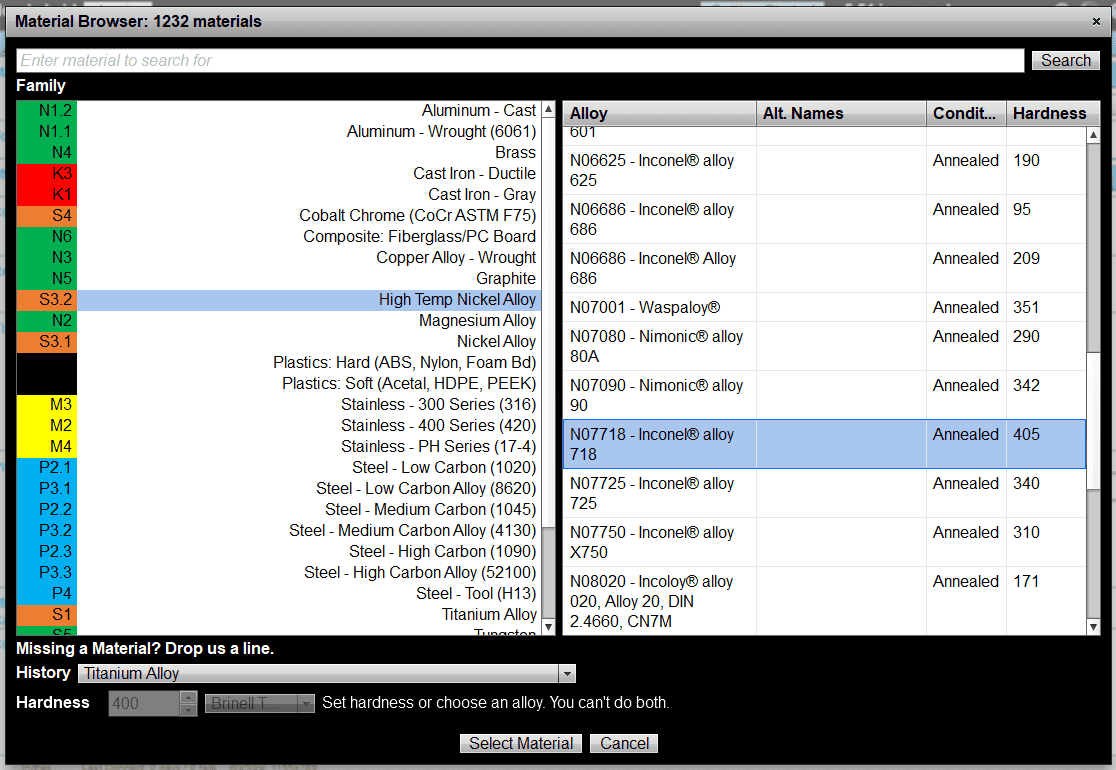

Inconel’s tough and work-hardening attributes call for a calculated approach when determining the most favorable cutting conditions. The goal is to find the sweet spot where tool wear is minimized, and machining efficiency is maximized—a balancing act that requires a deep understanding of the material’s behavior under cutting forces.
That sweet spot for successfully machining Inconel is extremely small compared to most materials.  It's nothing you want to trust the seat of your pants or rules of thumb with.  Get yourself a good feeds and speeds calculator like our G-Wizard Calculator and use it to find the optimum feeds and speeds.
Comprehensive material database for machining, machine shops, and metal fabrication.
G-Wizard Calculator for Inconel Feeds and Speeds
The feed rate is another critical variable, directly affecting the surface finish quality and the longevity of the cutting tools. Striking the right feed rate is akin to finding a rhythm in the machining process. Here are some considerations:

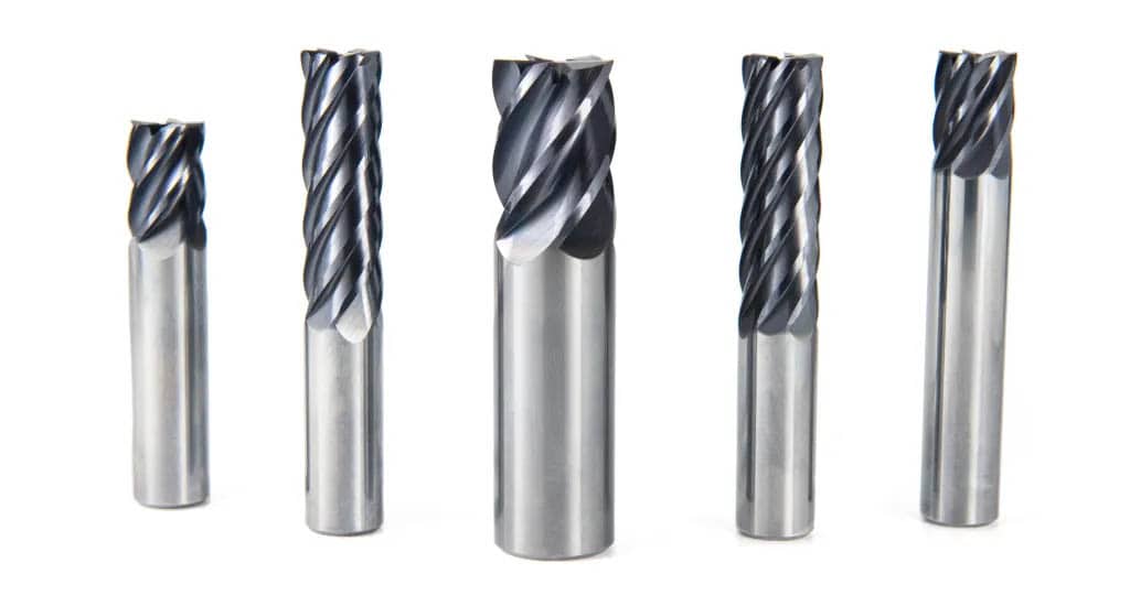

OSG HyPro Carb VGM End Mills for Inconel...
The toughness of Inconel demands cutting tools that are just as tough, if not more. Choosing the right tooling is a critical aspect of the machining process, one that can determine the success or failure of an operation. Carbide tools, with their high positive rake angle, lead the charge, offering a combination of strength and cutting efficiency that suits Inconel’s high work hardening rate and the need to withstand high cutting forces. However, the quest for the perfect cutting tool doesn’t end with carbide. Innovations in tool technology, including new coatings, grades, and geometries, continue to push the boundaries of what’s possible in CNC machining Inconel, paving the way for significant time savings in roughing operations.
Ceramic cutting tools also play a role in the Inconel machining arsenal, offering the ability to make fast, continuous cuts, which helps to minimize the risks of work hardening. These tools stand as a testament to the progress in machining technology, where the challenges of yesterday become the achievements of today. As we weave through the nuances of tool selection, it’s clear that the right choice is not just about material compatibility; it’s about understanding Inconel’s unique demands and meeting them head-on.
Carbide Tools vs. Other Cutters
When it comes to machining Inconel, carbide tools are the stalwarts, favored for their ability to combat the high work hardening rate and stand up to the intense cutting forces. But it’s not just about choosing any carbide tool; it’s about selecting those designed specifically for the rigors of Inconel machining. These tools are fine-tuned to navigate the material’s resistance, ensuring that the machining process is as smooth as it is productive. Yet, there’s more to the story than carbide alone.
Ceramic cutting tools offer an alternative narrative, one where higher cutting speeds and feeds are possible, enabling continuous cuts that keep work hardening at bay. Seco Tools, for instance, has found success with solid carbide tools crafted for Inconel, while ceramic end mill tools have made strides in reducing machining times. The choice between carbide and ceramic tools is a strategic one, where the nuances of the job dictate the selection, and success is measured in the precision and longevity of the cut.
